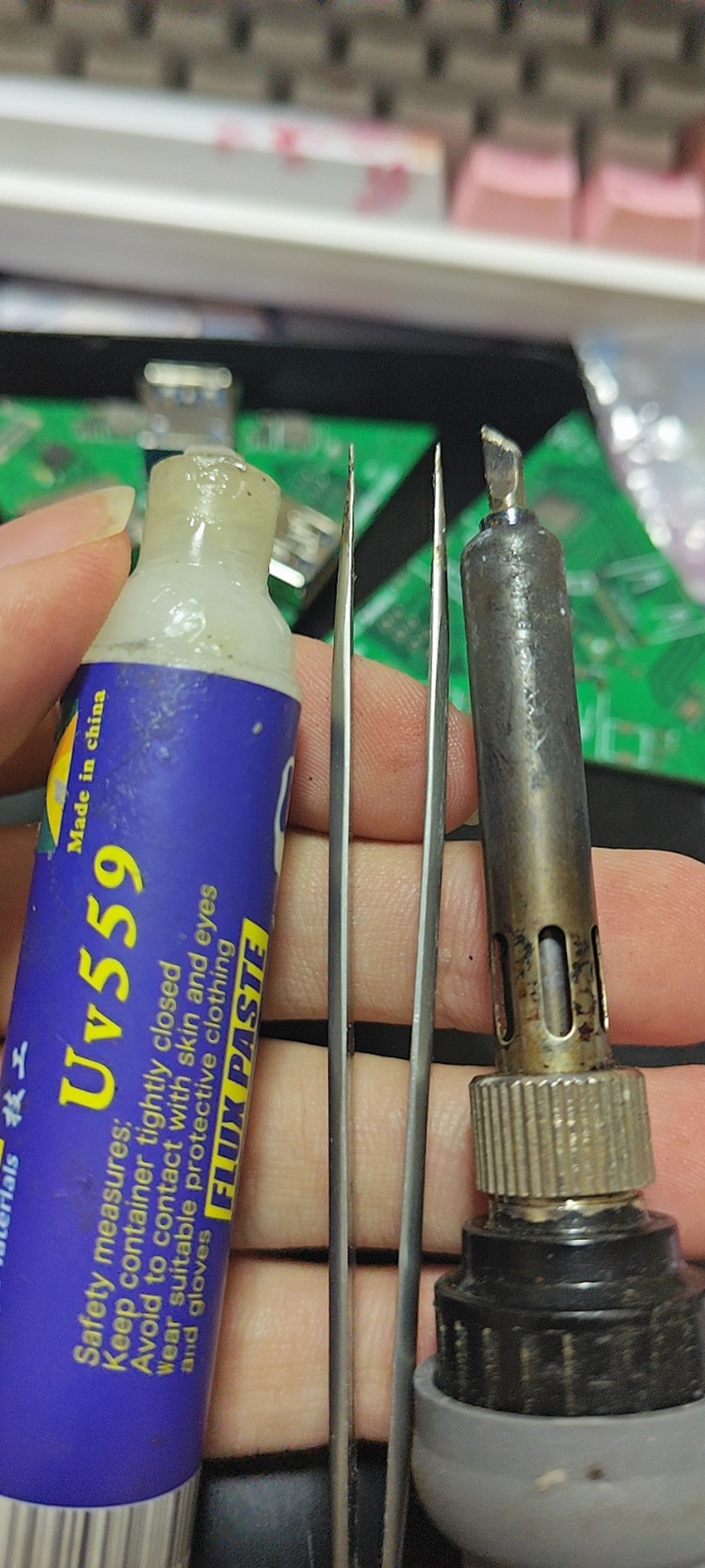

Yes, the right soldering iron and flux can solve a large part of the problem.
The optimal temperature of the electric soldering iron is about 300~350 °C
A rather sharp pair of tweezers is also needed!!!

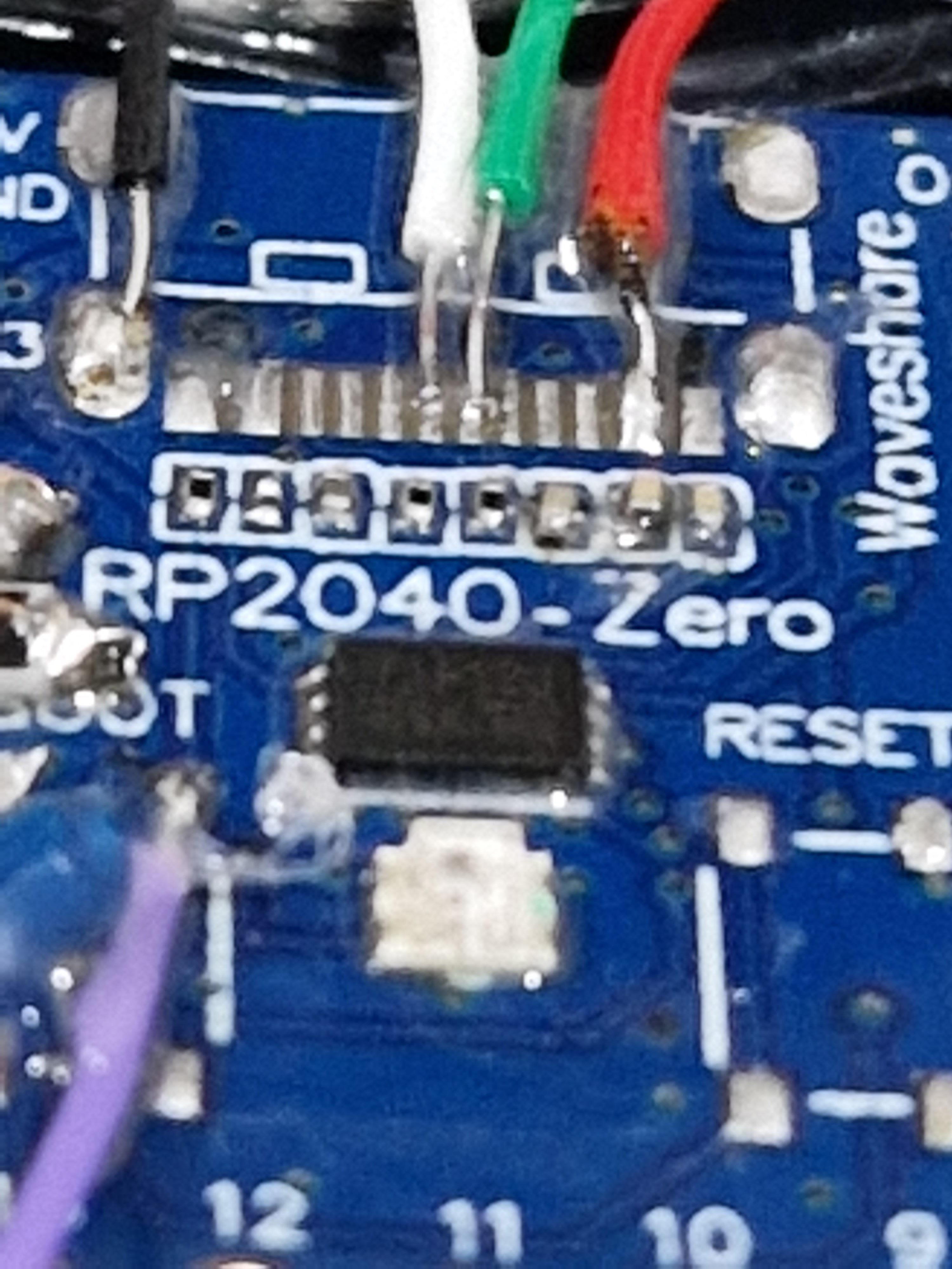

Got my mosfets today but I found it very hard to solder the mosfet directly to the cap:wacko:. Later I used the GPIO pins that comes with zero, pretty easy to solder. I only connected to the cap on the right side and it works fine.
One side of the capacitor is GND, so you don't need to solder to the GND side of the cap, you can just solder to any GND instead - that's why it works.
