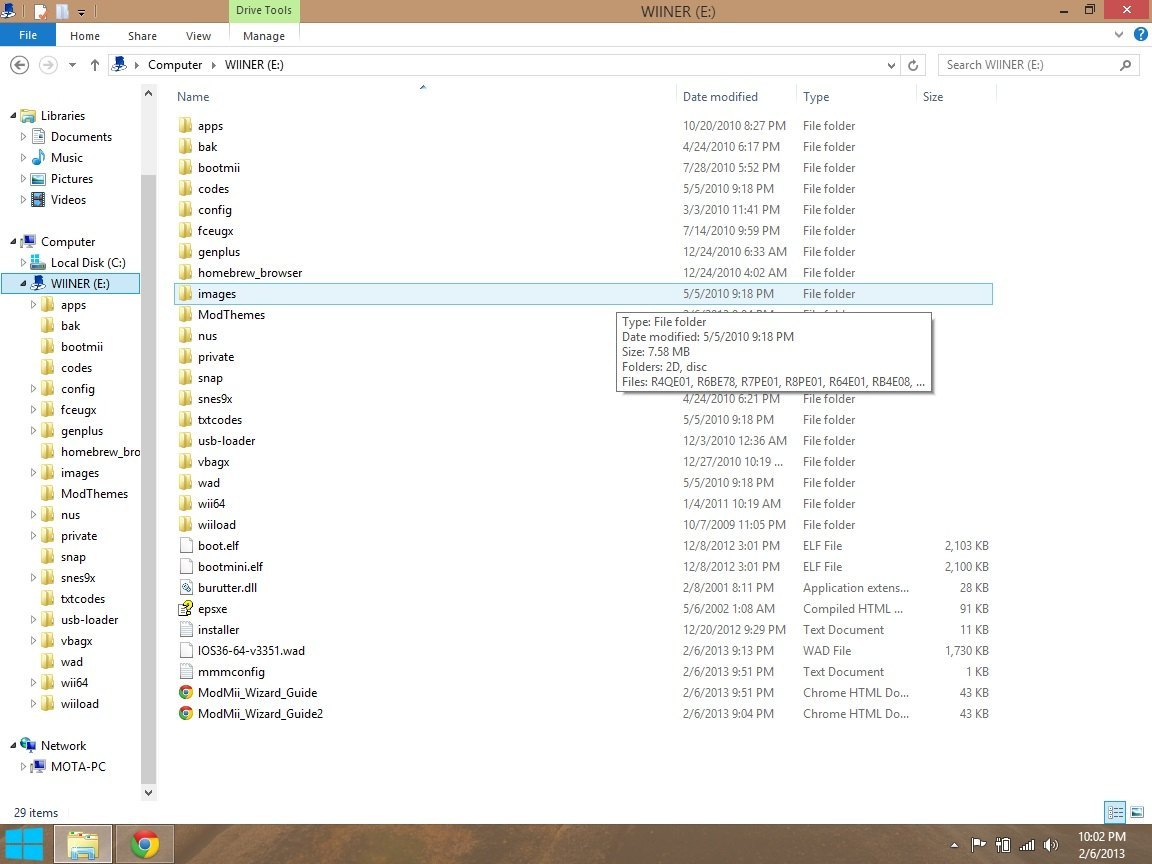

okay here's the thing:
i've uploaded a screencap of all my current files on my sd card. I feel like I'm at the very last step and it's like i've missed something cause it's not working.
i get to this part:
    1. Requirements: A copy of "LEGO Batman", a standard SD card (will not work with an SDHC card), and a nunchuck.
    1. Load the LEGO Batman game at least once (otherwise you won't be able to copy over the hack).
    2. Delete or move\backup your personal "LEGO Batman" save file before copying the files to your SD Card.
    3. Copy the ModMii files to the root of your SD card (if you haven’t already) and insert it into your Wii.
    4. Go into Wii Options - Data Management - Save Data - Wii - SD Card then copy over the "LEGO Batman" save that corresponds to your region.
    5. Start the LEGO Batman game. Load the new save file.
    6. You are now in the batcave, take the elevator on the right side.
    7. Then in the trophy room, go to the upper corner and go through the door to the "Wayne Manor". Now you can select a character.
    8. Choose the last enabled character in the lowest row to launch the exploit.
when I get to part E there's no current game to load. i've also noticed a note that says " if this Wii was previously modified, and it has either the HBC, BootMii as Boot2, or a Forwarder Channel installed, you can use that instead of an exploit"
and it was. I had it modded before, but I flarpped it up when I did an update! Now, I'm unsure what to do next.
I dl'd Modmii, followed the guide, and just seem stuck cause whenever I try to load the USB Loader GX channel I get a massive code dump and I have to powerdown.

when I get to part E there's no current game to load. i've also noticed a note that says "if this Wii was previously modified, and it has either the HBC, BootMii as Boot2, or a Forwarder Channel installed, you can use that instead of an exploit"
Okay, since it was previously modded, did the update actually get rid of the Homebrew Channel or do you still have it?
If you DO have the homebrew channel
1. copy that file called boot.elf that's on your screenshot
2. open the "apps" folder
3. create a new folder called "hackmii" (this may already be there)
4. Open the "hackmii" folder
5. paste the "boot.elf" file into that folder (again it may already be there)
6. put the SD card into the Wii.
7. open the homebrew channel.
8. there should be a rectangle on the screen that doesn't have an icon in it. Click on it and it should say "hackmii" at the top of the window that comes up. If it does, load it and continue on with the guide.
If you DON'T have a Homebrew channel (assuming your USB Loader GX channel is actually a forwarder channel)
3. find a folder that's either called "usbloadergx" or "usbloader_gx" and open that folder. (it should already be there if this is the SD card you use with your USB Loader GX. If not, make a new folder with that name.)
4. Inside you should see a file called "boot.dol". rename it to "boot2.dol" (if it's not there then, again, this is not the SD card you use with USB Loader GX so just skip this step)
5. paste the "boot.elf" file into that folder.
7. run the USB Loader GX channel from your wii.
8. It should start the installer and you should be able to continue the guide.
9. Once you're done, if you'd renamed a file in #4 you'd have to delete the "boot.elf" file from the "usbloader_gx" folder and rename the "boot2.dol" back to "boot.dol" for USB Loader GX to work again.

now when i click on the USBLoaderGX channel it loops me back to the wii home screen :hateit:
If you're doing this from the forwarder channel and did the second set of steps I mentioned, you might have forgotten to rename boot2.dol back to boot.dol. One way or another my first guess is that it can't find SD/apps/usbloader_gx/boot.dol to load. make sure USB Loader GX actually shows up when you go into the homebrew channel. If it does, run it from there and see what happens. If not, make sure the SD card is in (I've made this simple mistake before, myself)

okay, did something. now if i turn on the wii with the SD in the sd card slot, the bootmi screen comes up and my wiimote doesn't connect so i can't do anything and i have to do a hard reset
on the other hand if i power up the wii without the sd card it takes me to the wii homescreen, i put the sd card in, then click on the homebrew channel, click on rectangle on the screen that doesn't have an icon in it. Click on it, it says "hackmii" at the top of the window that comes up. I load it and continue on with the guide, then nothing happens. i'm thinking of completely earasing my sd card and starting over :cry:
Just rename the "bootmii" folder on your SD card to something else (like "bootmii-backup" for example). BootMii just loads automatically if it sees the "bootmii" folder on SD but if it's not there or not named that it won't.
If at some later date you need to run bootmii again you can just change the name of the folder back.
