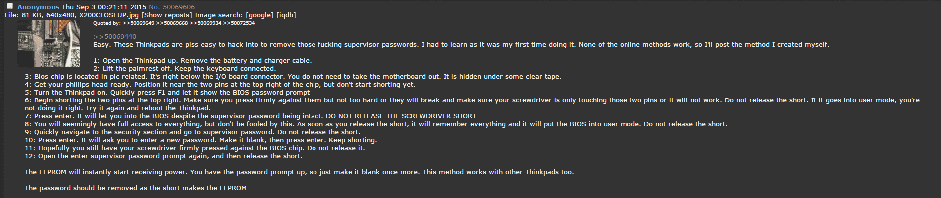

Buy what? If you're gonna replace the BIOS chip then maybe try reading the nvram out first.
There's a dumb trick on old thinkpads that lets you override and overwrite the supervisor password by shorting some pins on the flash chip. Don't think it works anymore though.
