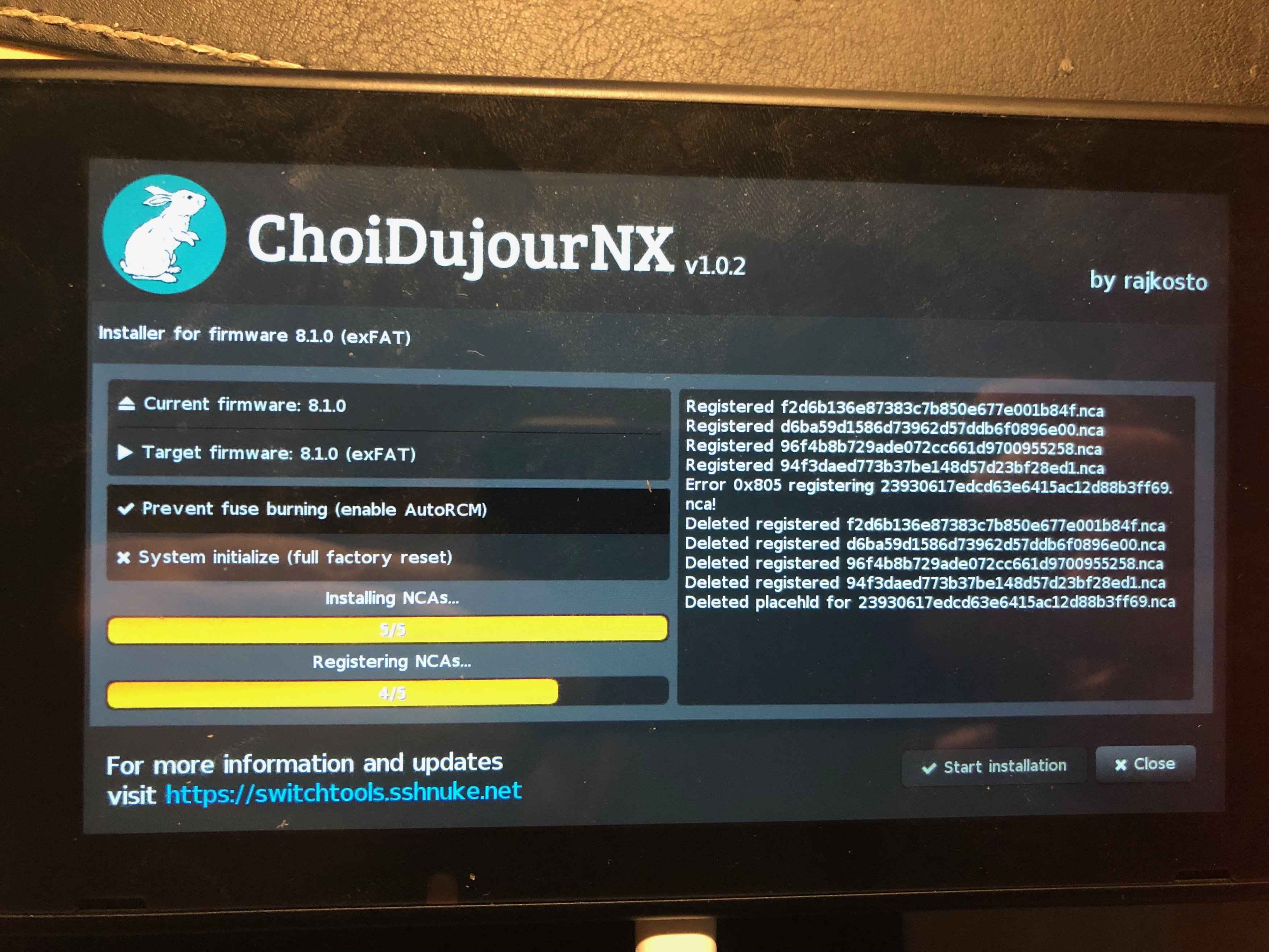

I'm on latest 8.1.0 firmware and I have no issues booting the switch or playing games.
I have two microSD cards: 256gb exfat and 64gb fat32 (which I'm trying to use to enable exFat)
I followed many guides and tutorials online and tried many times but every time I end up with an error message while updating: Error 0x805 registering ...(long hash here).nca!
It is always this file with this hash .nca... despite the fact that all the checks pass before updating. (see screenshot)
What I tried so far:
- Reformatting my SD card and putting everything back
- Executing scripts for remove archive flag (I'm on a Mac and dont have access to Windows)
- Downloading the 8.1.0 firmware from multiple sources
- Fixing the archive bit when booting into RCM mode
Does anyone else has this issue or know what else I can do to be able to enable exFat support on the Switch?

you cant reinstall the same 8.x firmware update again just to get exfat support, had try this on multiple switches already on 8,x. What you can do is, make sure you're on autorcm, downgrade to 8.0.1 with exfat, then updgrade to 8.1.0 exfat using choi.

If you had 8.0.1 before and use ChoiNX to update to 8.1.0 then yes, you can downgrade to 8.0.1 again. However, if you never used ChoiNX to update to 8.1.0 but you just flash to the latest version then no you can't.

Why? He can downgrade to any firmware he want with ChoiDujourNX and update to 8.1.0 with exFAT. You just need the firmware files to which you want to downgrade.

You can downgrade even if you don't have a NAND backup. And if your fuses are burnt, you have to boot with custom payload to bypass the fuse check. But since he will upgrade to 8.1.0 right after, he will be fine.
EDIT: You should read this guide here. They downgrade with the firmware files only.

AutoRCM will always enter RCM. You don't need it because you can also boot with a jig to RCM. It seems you misundersanding something. If you have fuses burnt up to 8.1.0, you can still downgrade but not boot to it with official Nintendo boot loader. Therefore you have to enter RCM and boot with custom boot loader to bypass the fuse check.
