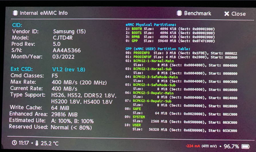

Does the following screen show anything strange?
If there is a hardware issue (like a bad connection between the emmc and mainboard) then it should also cause problems here.
You can check your battery status and health in Hekate.
Hekate boots with a dead battery, OFW and CFW does not.

I do use an emuMMC and it was working without issues before the crash. Not anymore, it does the same as booting on sysMMC via CFW, semi-stock or 100% stock. I even disabled the autorcm feature to try booting normally.
I attached screenshots of Hekate showing battery health and eMMC. I don't see anything wrong but I'm not sure.
