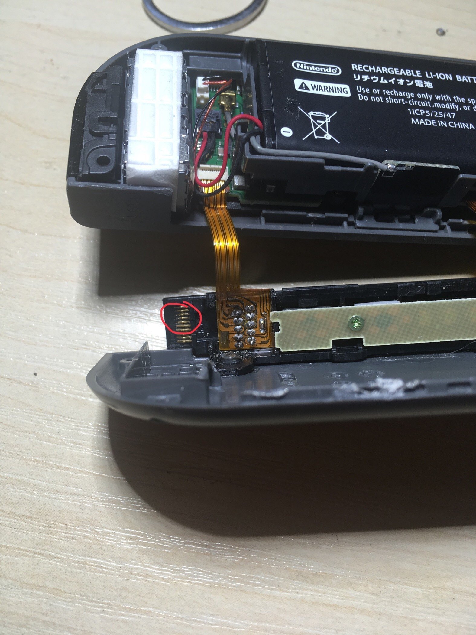

Here are pins 1 and 10 that you want to solder to. Be VERY careful. This is a tight soldering job and you don't want to mess up. You can still back out at this point if you aren't comfortable.

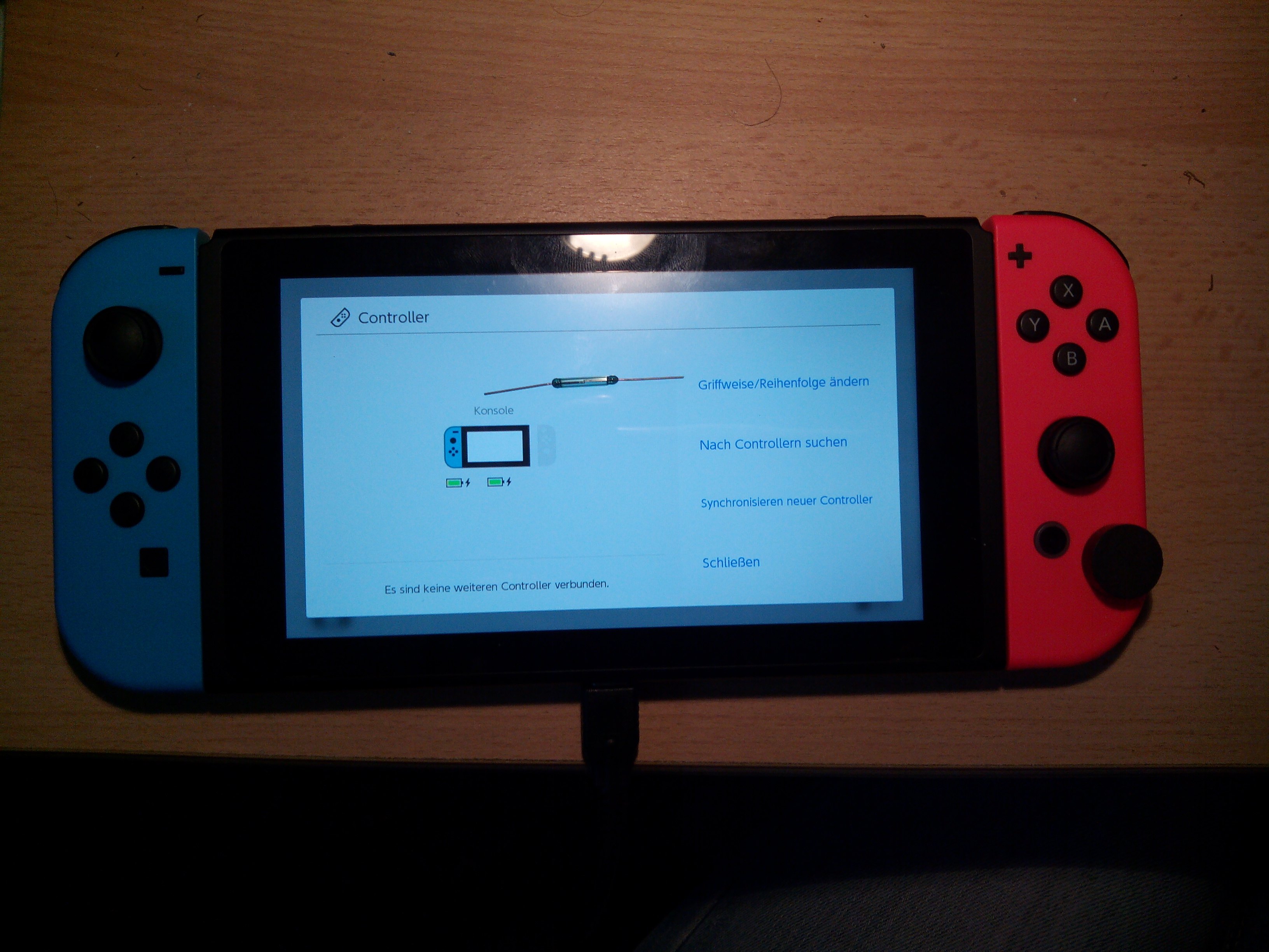

If it isn't obvious, the way you know you did it right are with the below two tests, with and without magnet, and what you should see on the screen. Speaking of Magnets: I'd consider using a 1/4" or larger rare earth or "neodymium magnet" They come in different grades N35 N42 N50 etc. The higher the number the stronger. Any of them should work. The dark brown or black "ceramic" magnets work but they are not as strong so you might consider a larger size (maybe 1/2"??). Ebay has tons of them, Harbor Freight has rare earth magnets and magnetic grabber tools. Buymagnets.com is also an option but shipping might kill it.

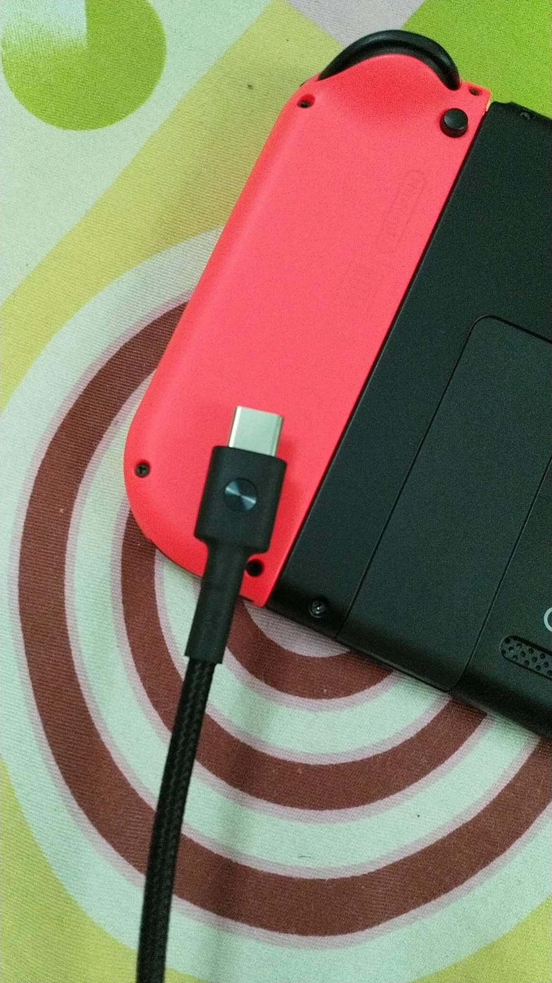

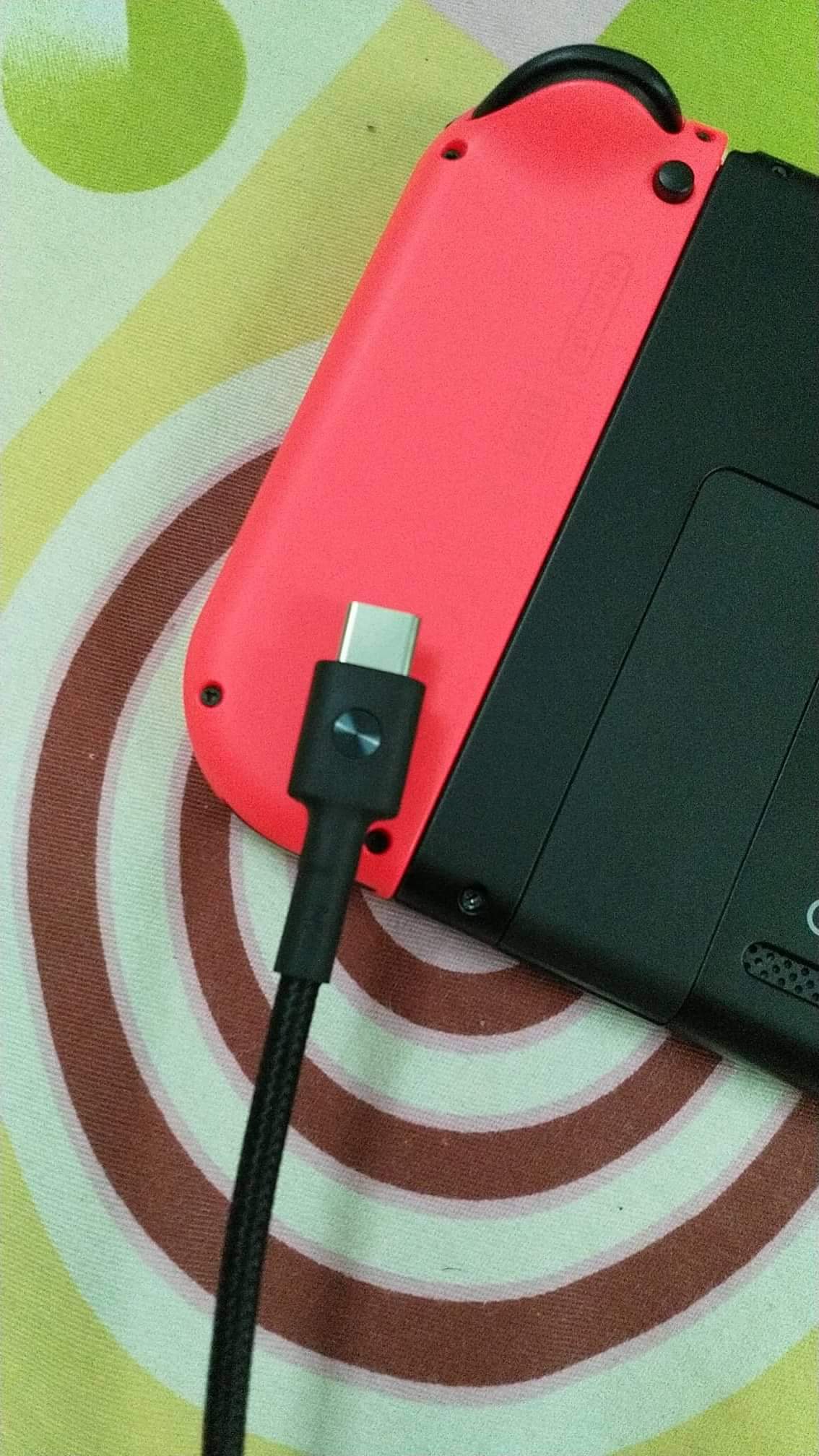

is that a type C cable with a magnet built in if so where did you get it and does it have th 56k ohm resistor so that it is "switch safe" ?
Yes it is. It's ZMI, a brand of Xiaomi. No, you don't need any resistor to make it stable due to the nature of reed is to short temporarily.

I have zero issue when using the cable. I reckon it does have kind of resistor you are talking about because it has a built in led in the usb c port itself. Anyway, transfering data from my android phone to the switch works perfectly.

Well, had some problems fitting everything in... Left the wire way too long, since in most cases you can't have too much wire!...:rolleyes:
But it works!
