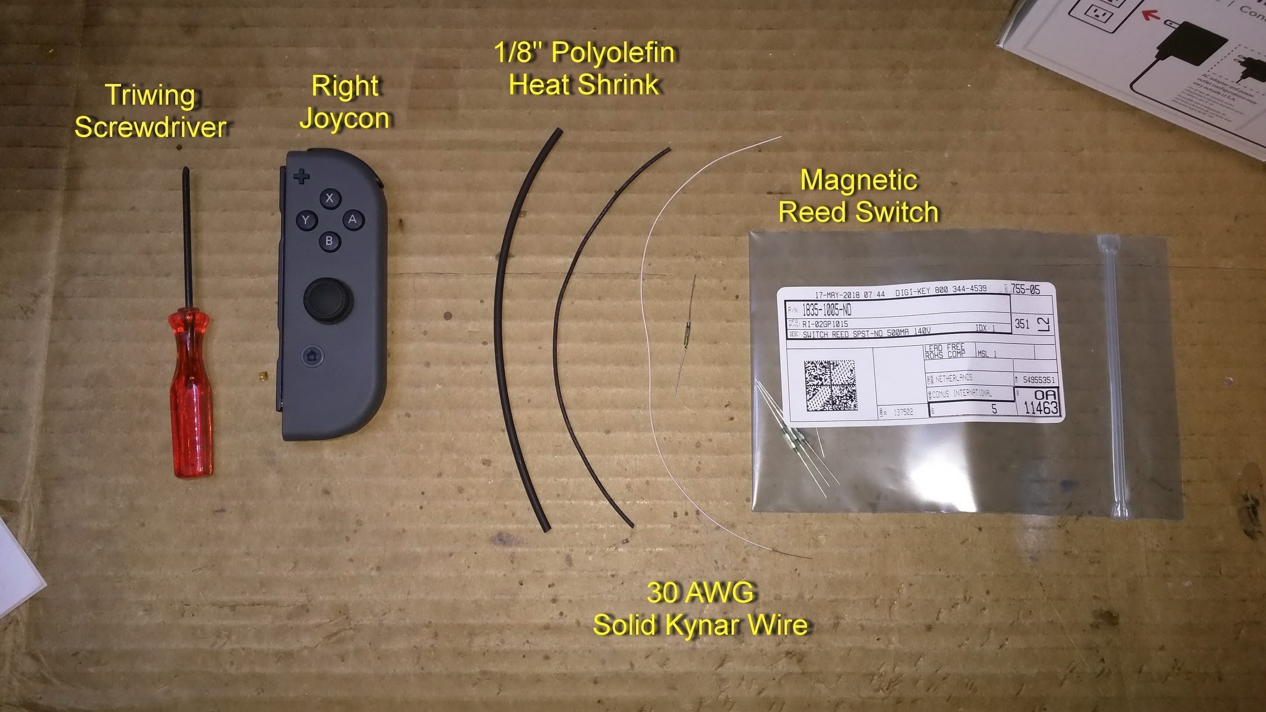

This should be a pretty solid method for installing a MAGNETIC REED RELAY into your Right Joycon. the purpose is to have a cosmetically PERFECT Switch, with the ability to launch RCM with almost no effort. You just need to have a strong magnet to hold near the bottom right corner of the right joycon while you press power and volume + when booting. There are no known side affects of this method. i.e. you can still charge, use the joycon or switch normally. It's essentially stock when there is no magnet nearby and should last forever with no risk (after installation). I'd not send it in for warranty repair with the reed switch installed though :). This is a MUCH better option than a jig if you don't mind some soldering
The tutorial requires MODEST disassembly and soldering skill.
I'm not saying my approach and tutorial is any better than what other's have done (and posted). They certainly deserve credit. However, this is what I did and I think it's the best approach. I had previously posted a PSA about "why jigs are a bad idea" as I don't agree with them generally. So here is an explanation (for the reasonably skilled solderer) to do a magnetic reed switch the way I did it.
Note that much of the tutorial text is IN the spoilers with the pictures. Don't miss it. It is always at the top above the picture. I elected to keep this pretty visual rather than text, but happy to add more if people want more detail.
It is advisable to disconnect the joycon battery before starting to solder. I didn't disconnect the battery when I did the mod. So there isn't a picture of it.
I didn't include info on how to open the case beyond showing the triwing screwdriver. There are better tutorials on opening the joycon VIDEO and TEXT

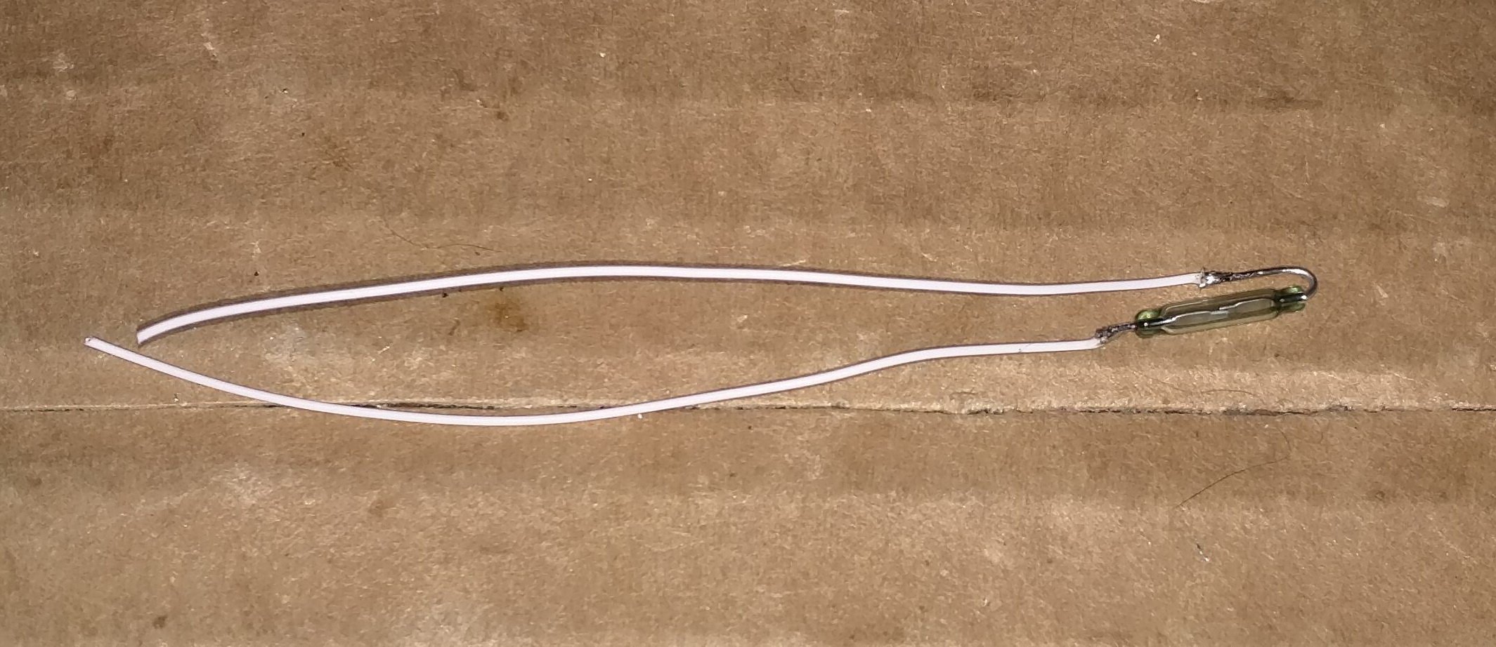

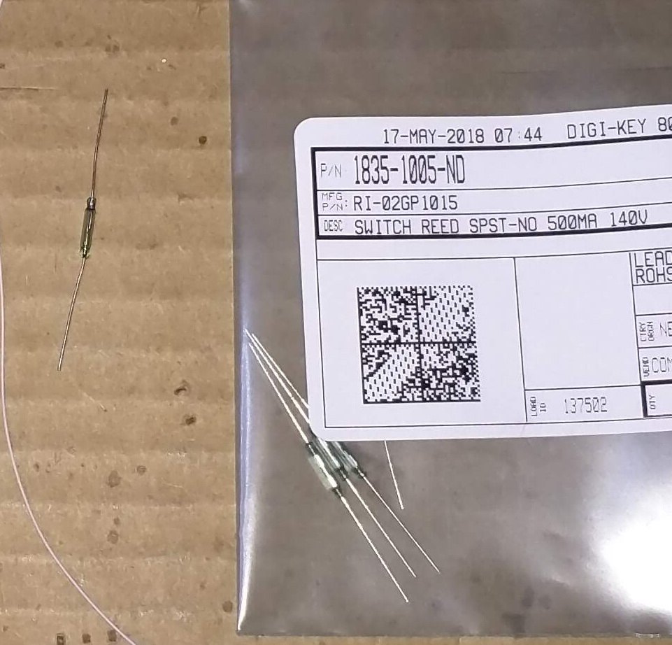

The reed switch can be bought from digikey for about $0.50 each. Shipping via USPS first class mail runs about $3 for under 8oz. The reed switch is 1.8mm by 10mm (body of the switch). HERE is an option from Amazon that is bigger (2mm x 14mm)

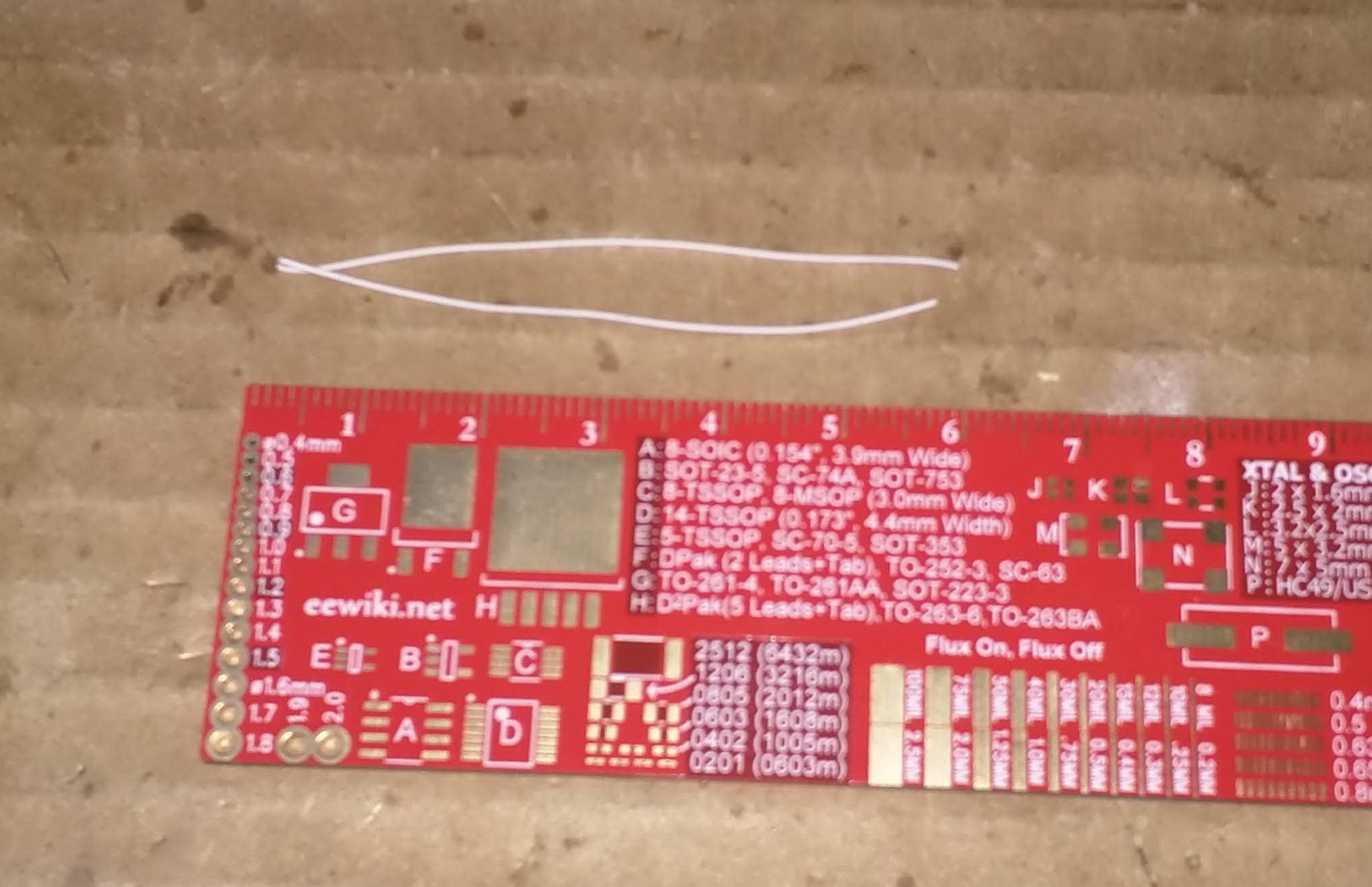

Note, I used 6cm wires. I wish I had cut them to about 3cm. You will see later they were a little too long. Also, I didn't take a picture of it, but I generally use the soldering iron to melt off 1mm of the wire end for soldering. I don't usually use wire strippers on Kynar insulated solid 30AWG wire. Note this is also called "wire wrap wire" in many circles.

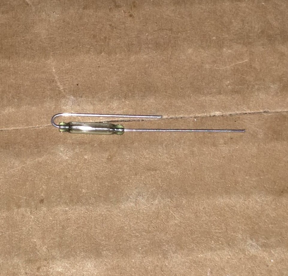

This is one of the main items different from what most people have done. This approach takes less space and allows the wires to exit the reed switch from the same side toward the connector. BE CAREFUL!!! It's VERY easy to break the glass on the reed switch when bending the leads. I broke two, though they were not ruined, I didn't want them chipped. Use some tweezers or needle nose pliers to bend it about 1mm beyond the end of the glass.

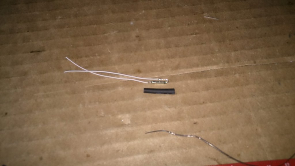

The goal here is to use enough heat shrink to cover the exposed leads and solder, but little enough that it doesn't interfere with placement. I went about 1/8" beyond the electrical connections on each end of the device.
Sorry I didn't get a better picture here!! It will give you the idea however.

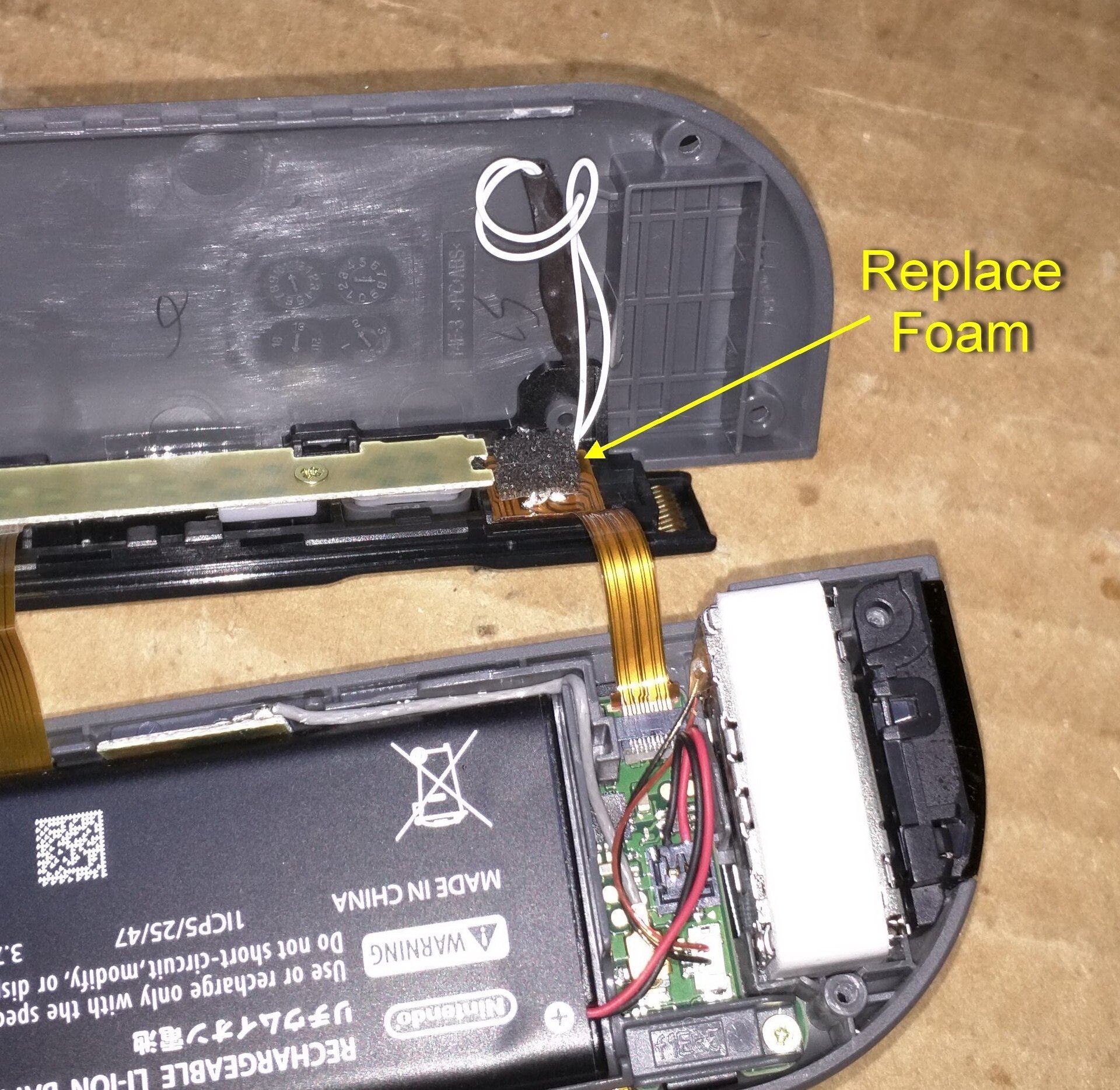

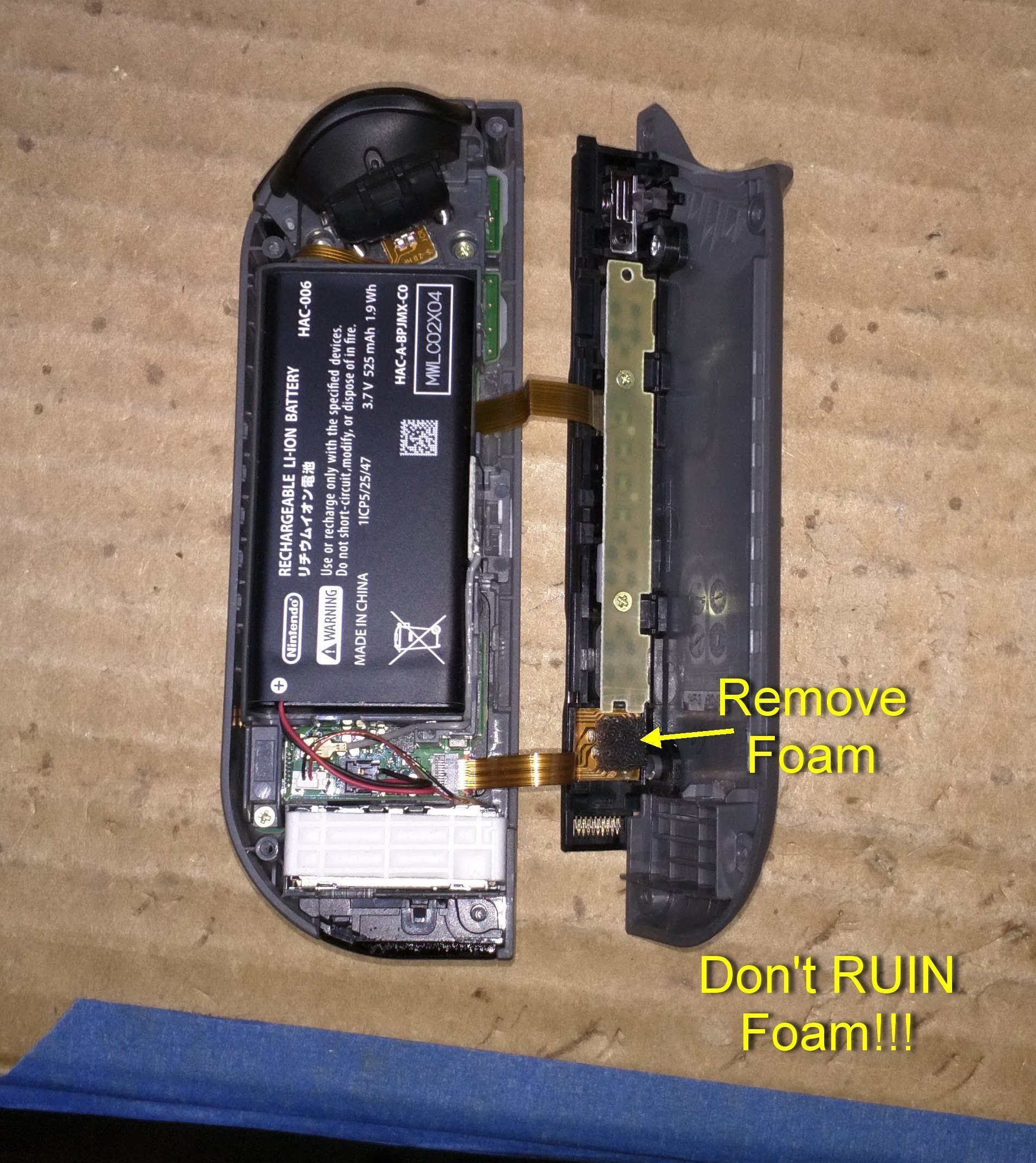

Be careful with the foam. It actually serves a purpose protecting the other side of the flex cable from abrasion against the soldered pins.

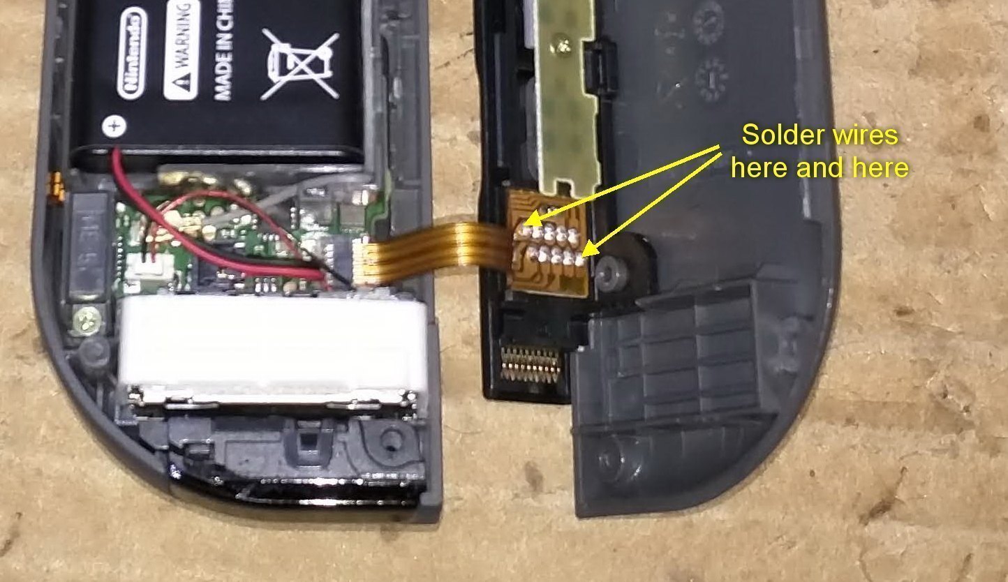

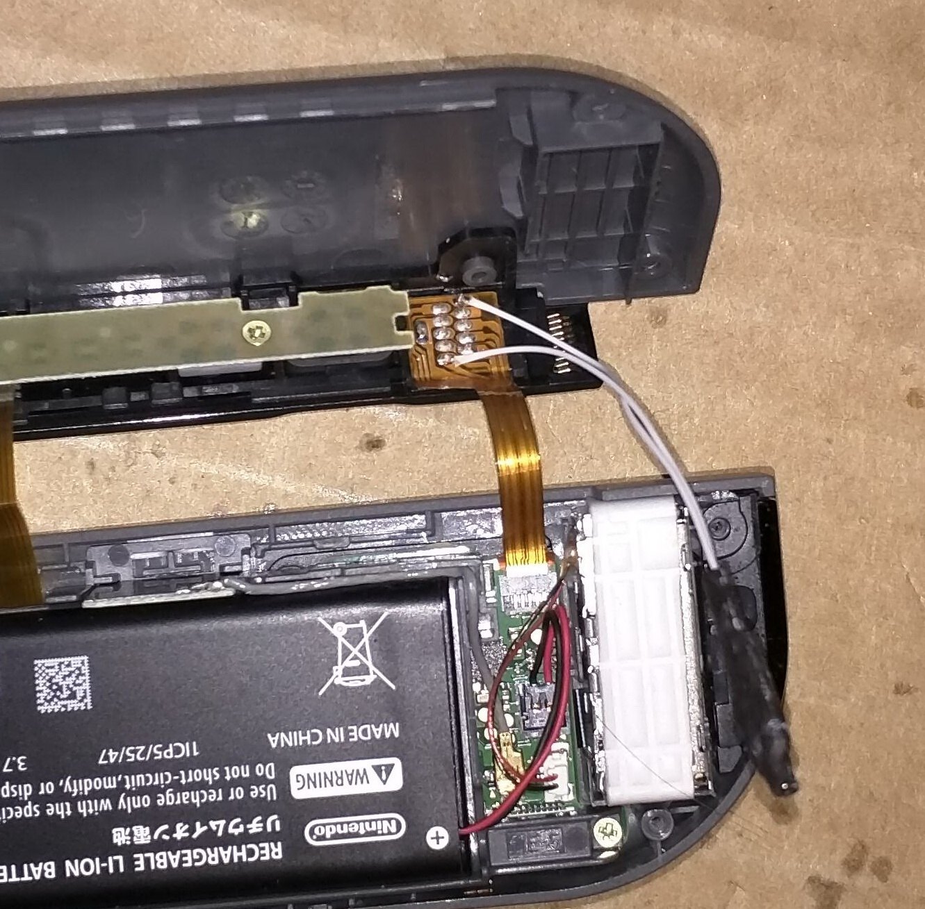

Here are pins 1 and 10 that you want to solder to. Be VERY careful. This is a tight soldering job and you don't want to mess up. You can still back out at this point if you aren't comfortable.

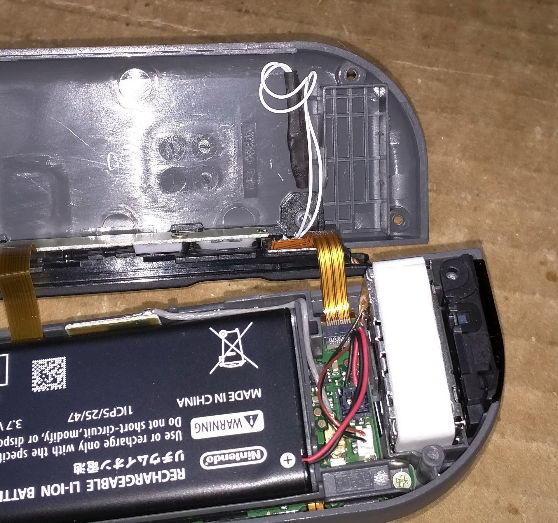

I think this is the best place to put it. The Joycon is pretty tight once assembled but there is ample room above the PCB and wire routing location where I have stuck it here.

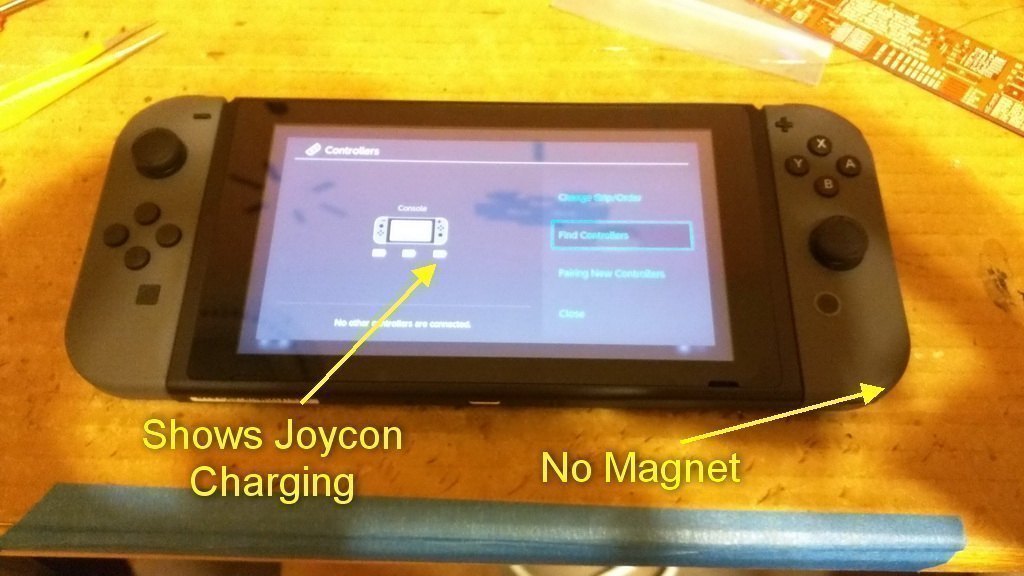

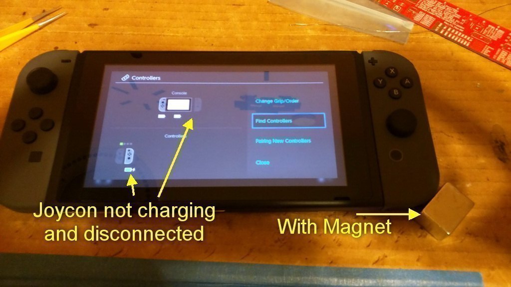

If it isn't obvious, the way you know you did it right are with the below two tests, with and without magnet, and what you should see on the screen. Speaking of Magnets: I'd consider using a 1/4" or larger rare earth or "neodymium magnet" They come in different grades N35 N42 N50 etc. The higher the number the stronger. Any of them should work. The dark brown or black "ceramic" magnets work but they are not as strong so you might consider a larger size (maybe 1/2"??). Ebay has tons of them, Harbor Freight has rare earth magnets and magnetic grabber tools. Buymagnets.com is also an option but shipping might kill it.

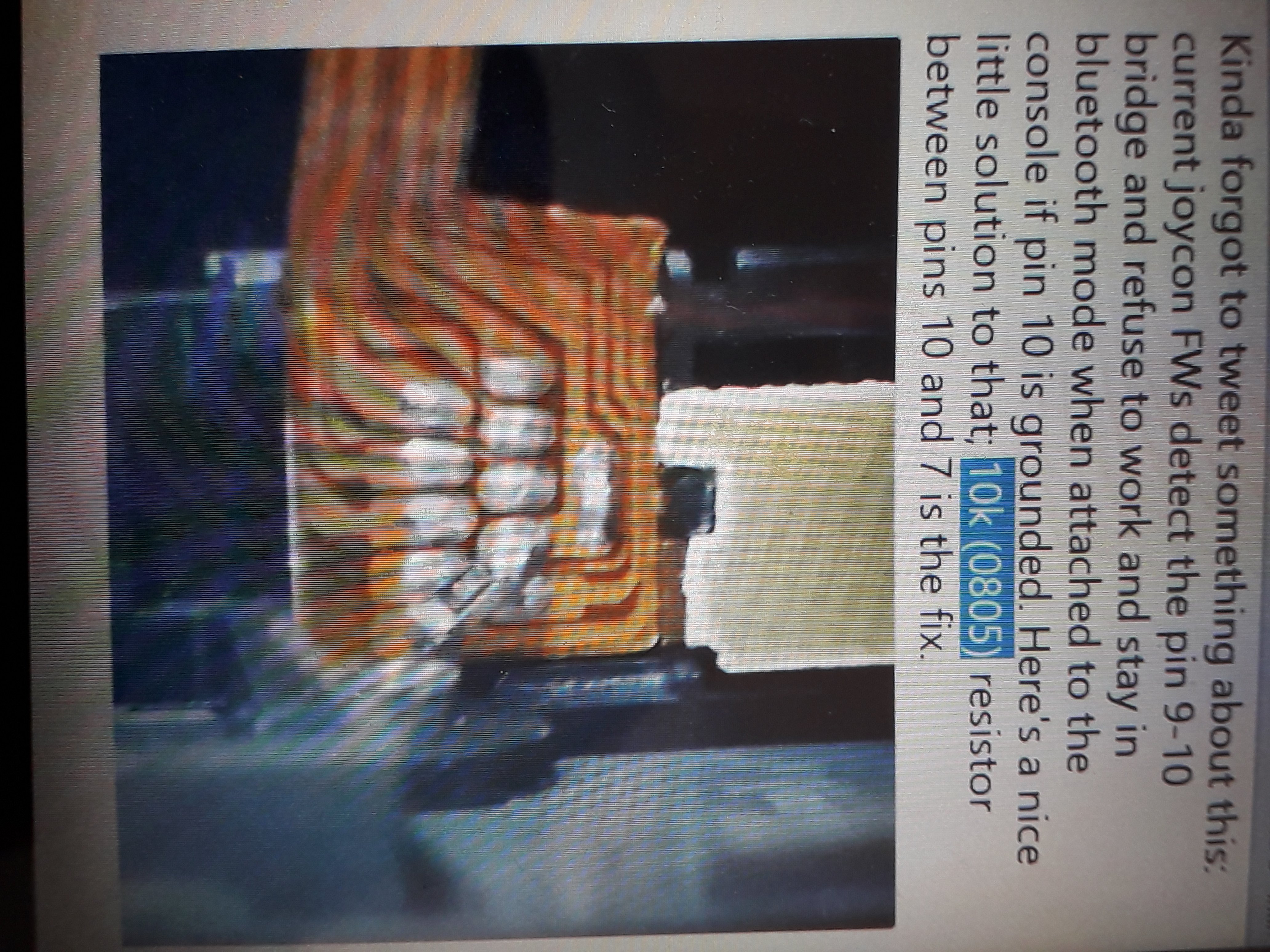

Sorry Kubas, I thought you were the one having problems. Still shouldn't use pin 9 as it's not really connected to ground, it just has a logic zero that might change in certain conditions. I've only seen people have problems with pin 9 and not with 1 for instance.
I have seen people having problems with all pins.
I am happy with that (pin 9 and 10), as long as it works (and it works from the start for me).
It's not like 9+10 breaks the joycon, it just the system doesn't really notice it being connected. It's still getting charged and working perfectly (through bluetooth connection).
9+10 not always being ground is also only true if you don't use a joycon. if using a joycon, the grounding definitely happens (on the joycons side). if you do it with, say a screwdriver, it could potentially short something in rare circumstances (though some argued that state where 9 carries a tiny current actually can't happen during startup so it wouldn't matter anyways).
at least that's what i read about that so far.

Thanks for the comment, but I find your english REALLY hard to understand. It sounds like you said: "using pin 10 and 9 work fine for me"
I'm not disputing that it works, I am saying that you shouldn't use pin 9, because, pin 1 is better, because it's an actual ground.
