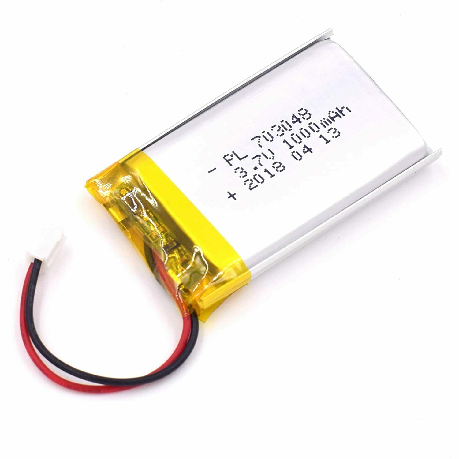

I use this battery, and just solder it inside. Very reliable battery

Yeah, a 703048 lipo battery should be available to you on amazon.co.uk, or whatever you use. And if you can't solder, I'm sure someone could mod it for you. If you were in the USA, I'd do it for you for free, as long as you paid the shipping.

I use this battery, and just solder it inside. Very reliable battery.
https://www.ebay.com/itm/294045717291
It also fits nicely inside a GBA SP and Gameboy Color. Might even fit a Pocket, with some shell trimming of the battery holder.
