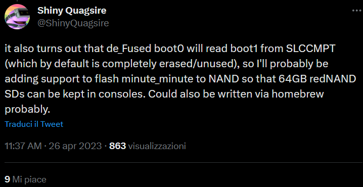

Your console must be de_Fused, which also means switching SD cards during boot if you want more than 2GB SD space
@shinyquagsire23 said we can flash the modified boot1 to the SLCCMPT instead, with no repercussions for vWii, so there's basically no downside for this mod :hrth::hrth::hrth::hrth:
(screenshot because twitter is fucking dying lmao)
Wow that makes it even better
