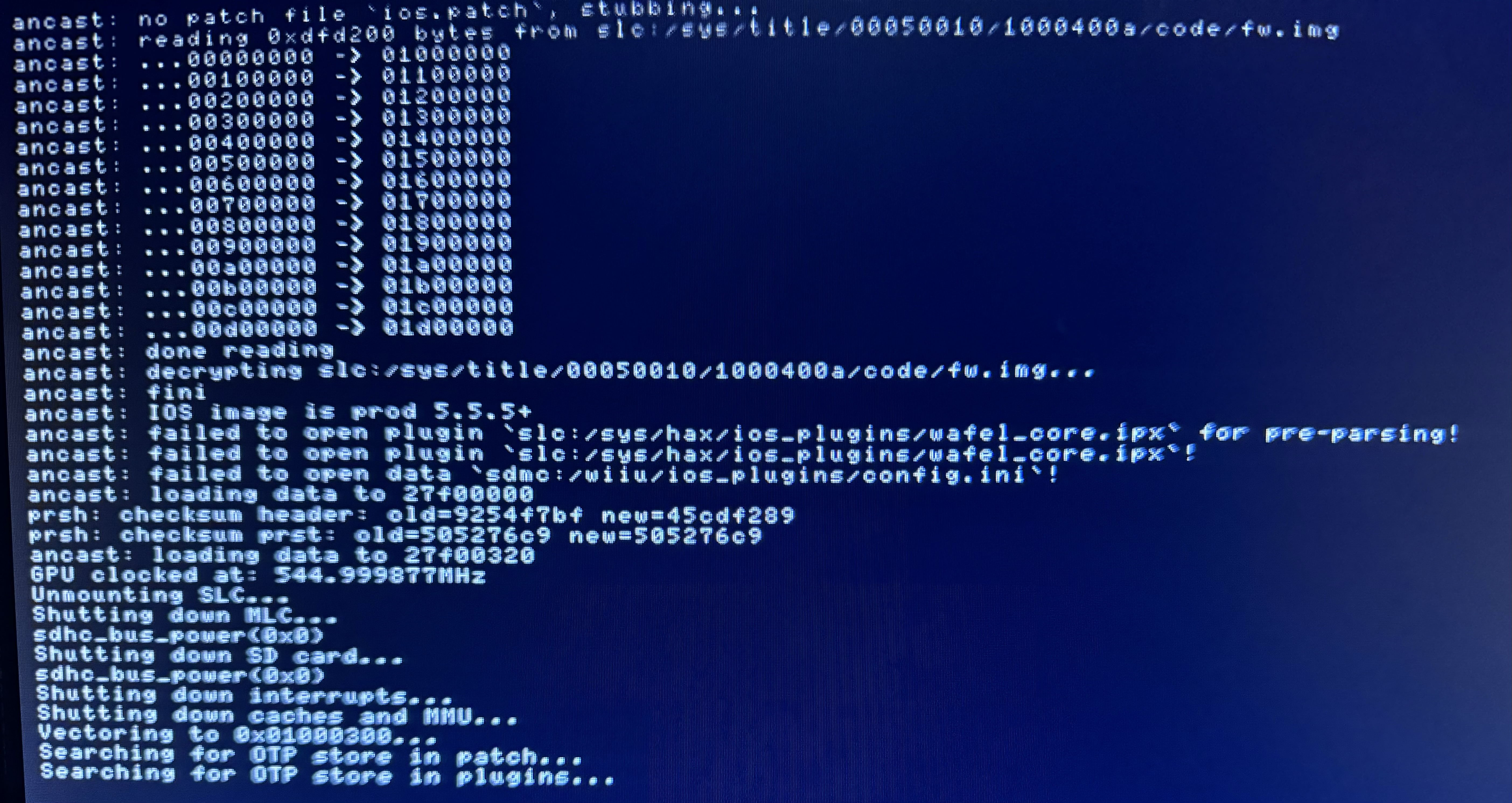

Hey there. I'm attempting this procedure on my Japanese WiiU to switch it to the US region. I'm running step 5 of the Region Changing header and it seems to be stuck. The LED on the WiiU is purple. Any idea what I'm missing? It's probably something easy, since I'm new to WiiU hacking. Thanks.
Why are you using the first boot option in minute? you should be using the third.

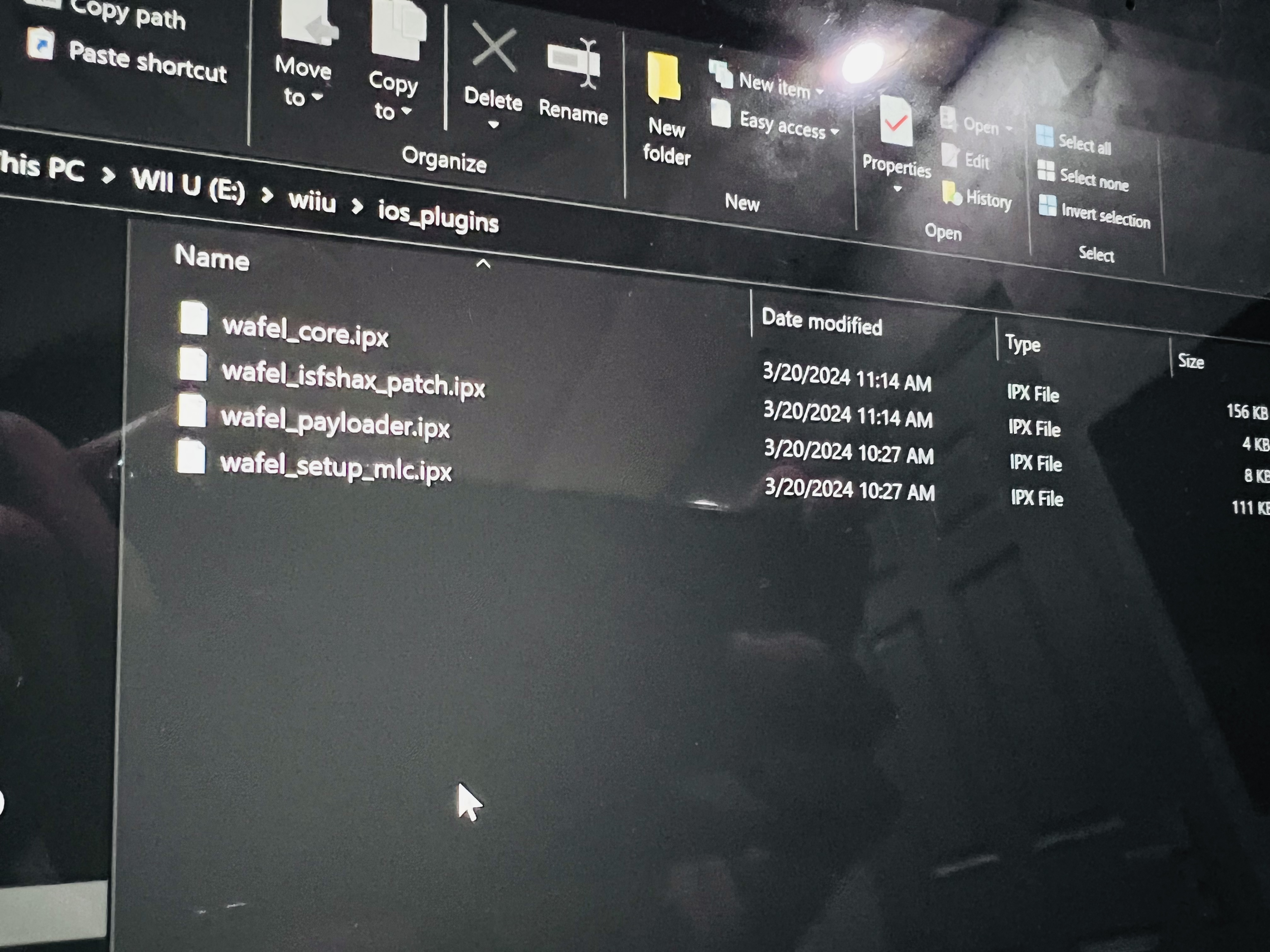

then you dont have isfshax installed
Isfshax already installed with the link on your OP, i'm skipped Erase MLC step, just "Delete scfm.img" and do "Patch (sd) and boot IOS (slc)", now console blinking blue for a while. Is it correct and safe?

Still waiting blinking blue, what's happens and what's to do next if i haven't Erase MLC, sorry i'm super new with this :rofl2:
just wait for it to stop blinking blue. its still doing the setup
id say another 5 min. if its still blinking blue shut off the console and check the log

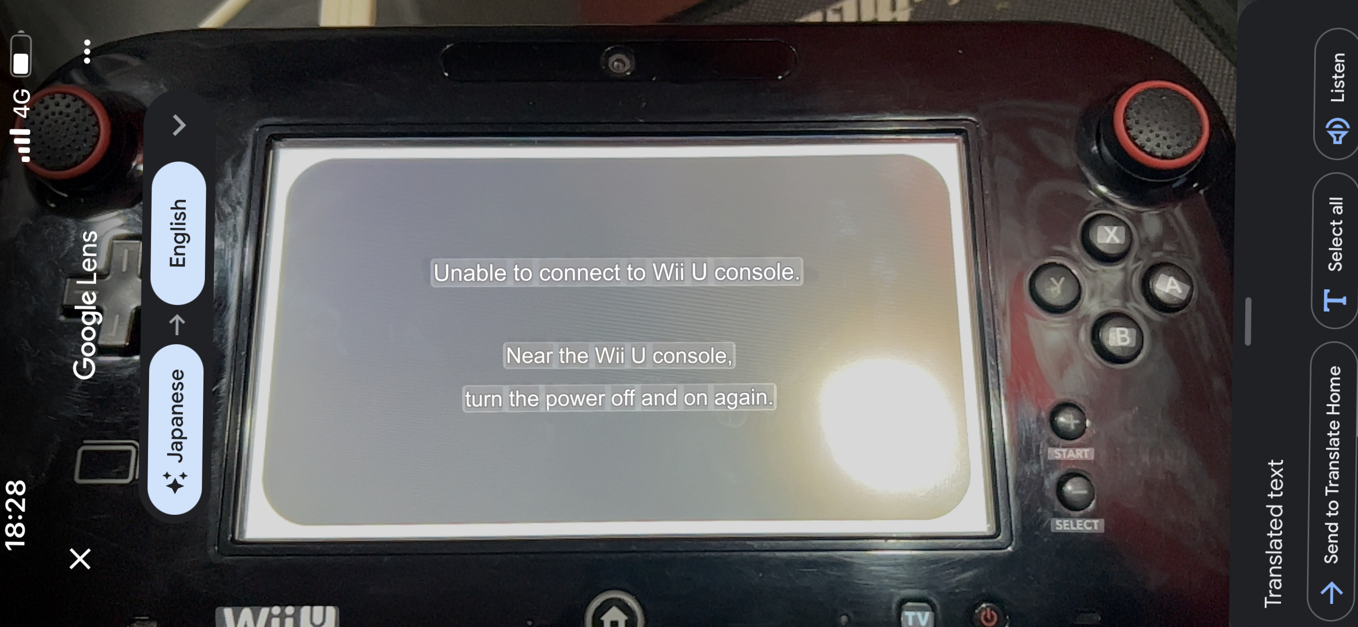

Still blinking over 2 hours! Wii U JP 32gb Black

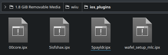

6 hours still blinking blue. I decide to force shut it down, now console won't turn on. Blue static led, Disc drive spin 2 times, no display on TV, gamepad says "unable to connect to wii u console" i can't do anything else. wafel_setup_mlc.log only got few lines (see attachment) help me please

show your sd contents. you didnt install isfshax
