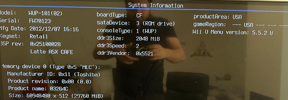

My EUR Gamepad didn't arrive yet. After I do the region change can I delete all the custom stuff and make it virgin again?
PS. My WiiU is NTSC\ US, sys_info is below and my goal is to make it full EUR\PAL stock and I bought a EUR GamePad that should arrive until friday.
