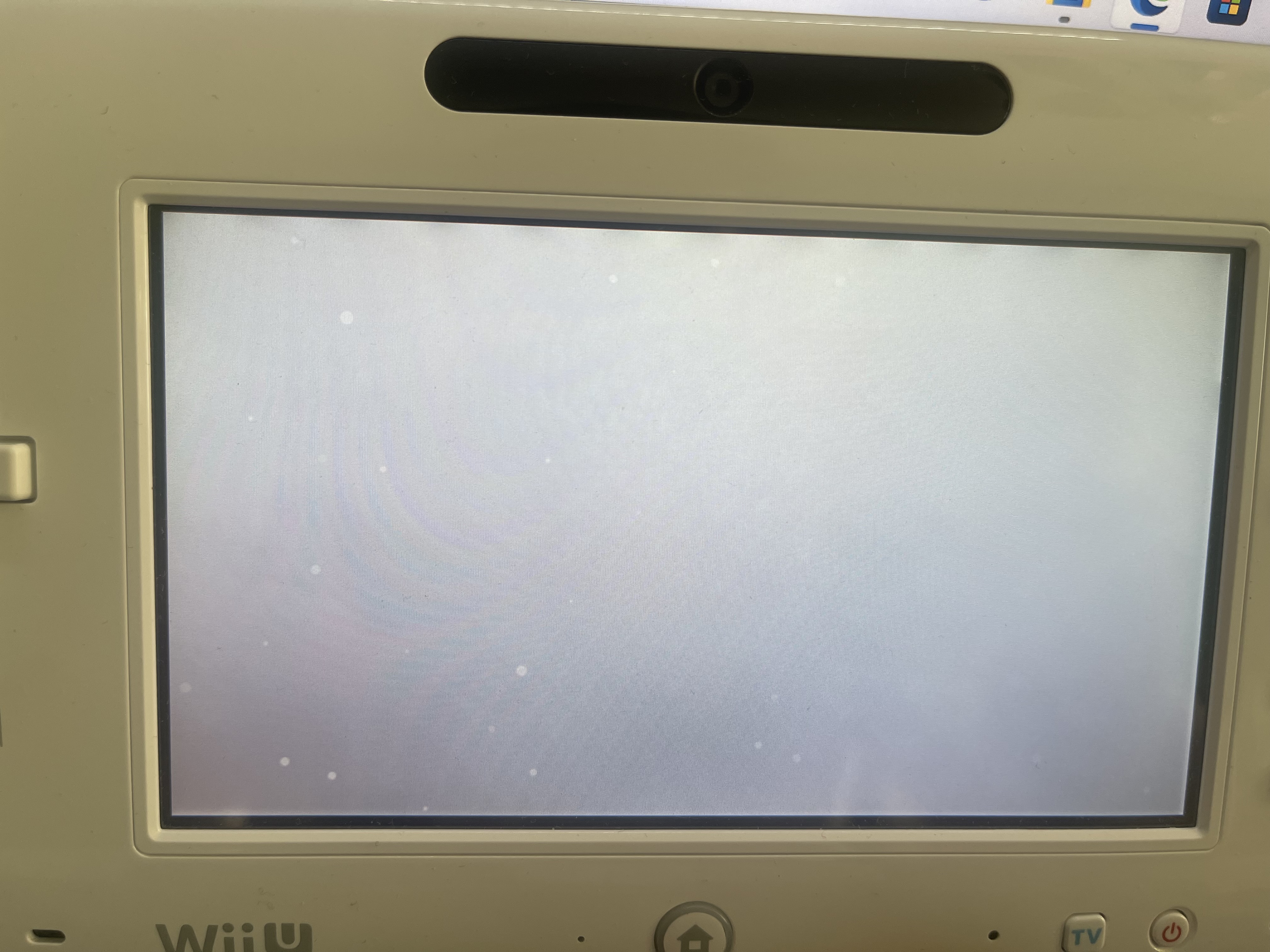

Too bad, do you think UDPIH Pico method should work?
no, its crashing early in boot because of the now fucked up mlc

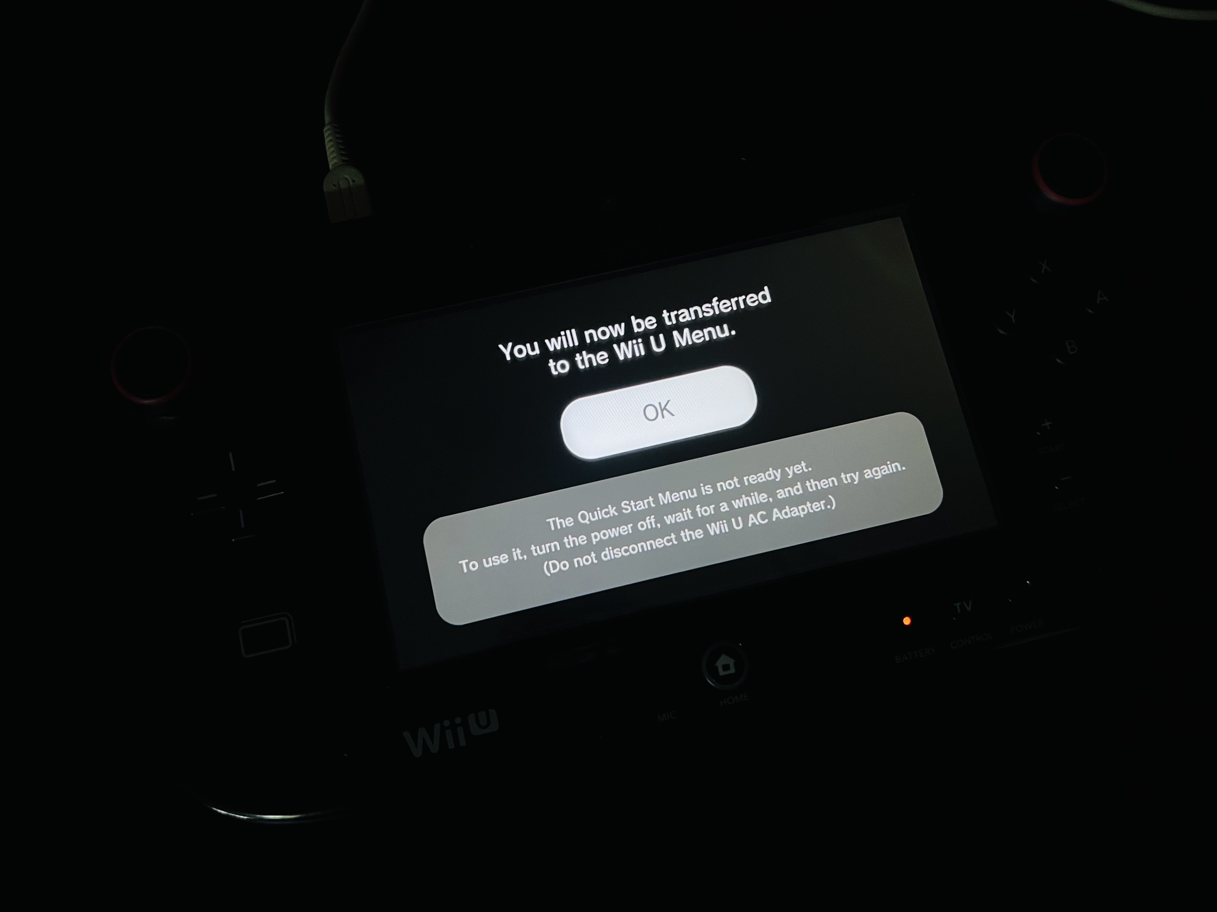

Thank you so much for this guide! I was able to change my White 32GB unit from JPN to USA. I would add however that the Quick menu should be disabled after doing this as trying to launch the Wii U Menu from the Quick Menu on the GamePad will crash the system. Also, while trying to Erase MLC, it returned an error saying erase failed, 0 bytes erased without any prior warnings. Despite this, I was able to delete scfm.img and continue on.
You corrupted the file system when you deleted scfm.img and because the erase didn't work the setup probably didn't create a new file system. So you can have all sorts of problems because if the corruption.

Pico is here. I will try UDPIH with isfshax first, if not working so try de_fuse, just drag and drop de_fuse uf2 file to pico to replace previous UDPIH uf2 firmware, right?
It does work, Wii U successfully region changed from JP to USA, everything is in English now. It came back to life without de_fuse, thank you!

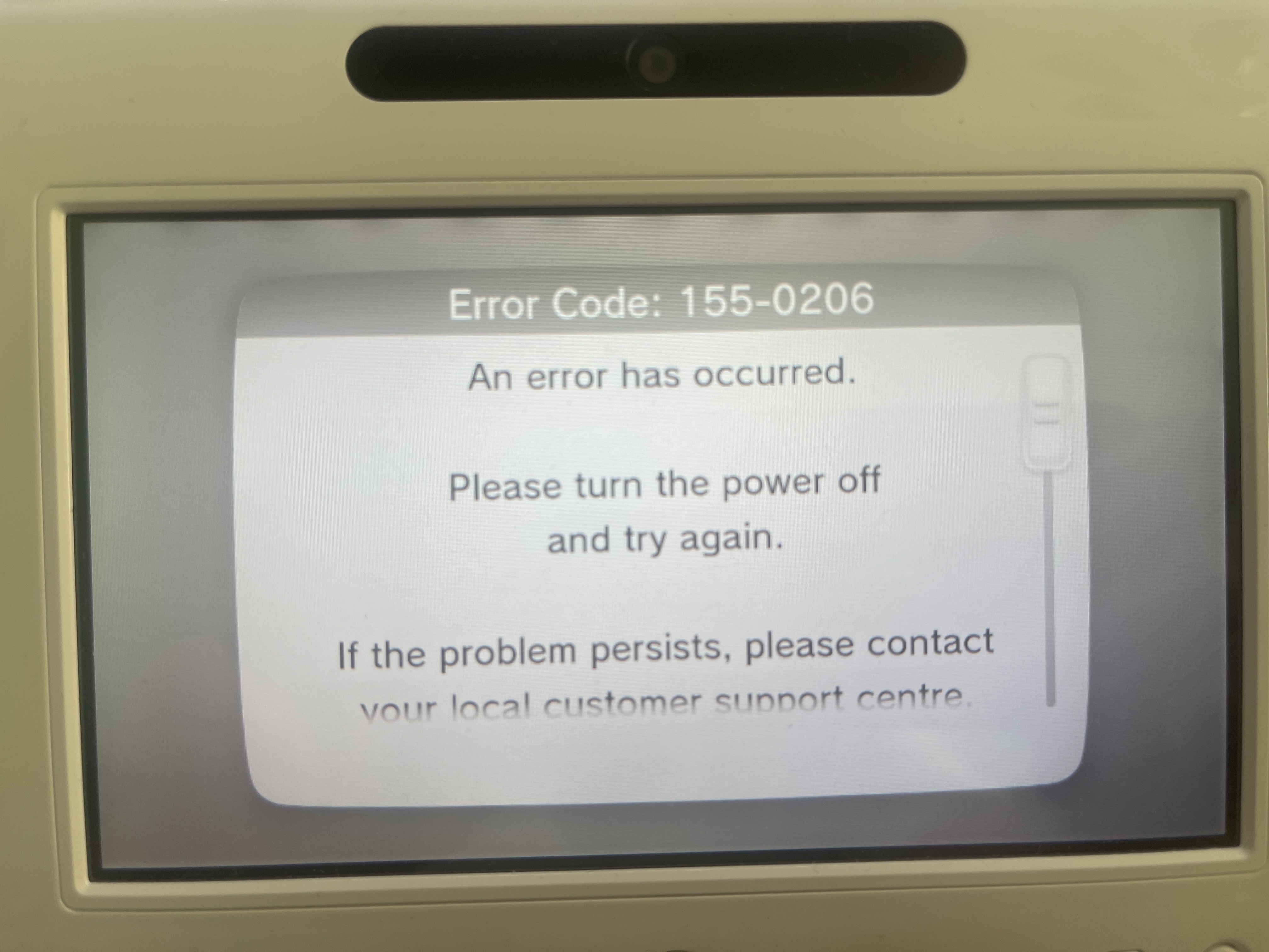

Hey @Lazr1026! Thank you so much for this guide!
I successfully changed the region, but strange things happen during the initial console setup.
When setting up a Wi-Fi network, I get an error that the network is busy. I click skip and it kicks me back to minute until, I launch it again and when I click “create a new user” the console freezes.
If I turn off the console and turn it on again, I get the error 155-0206
What do you think this could be?
