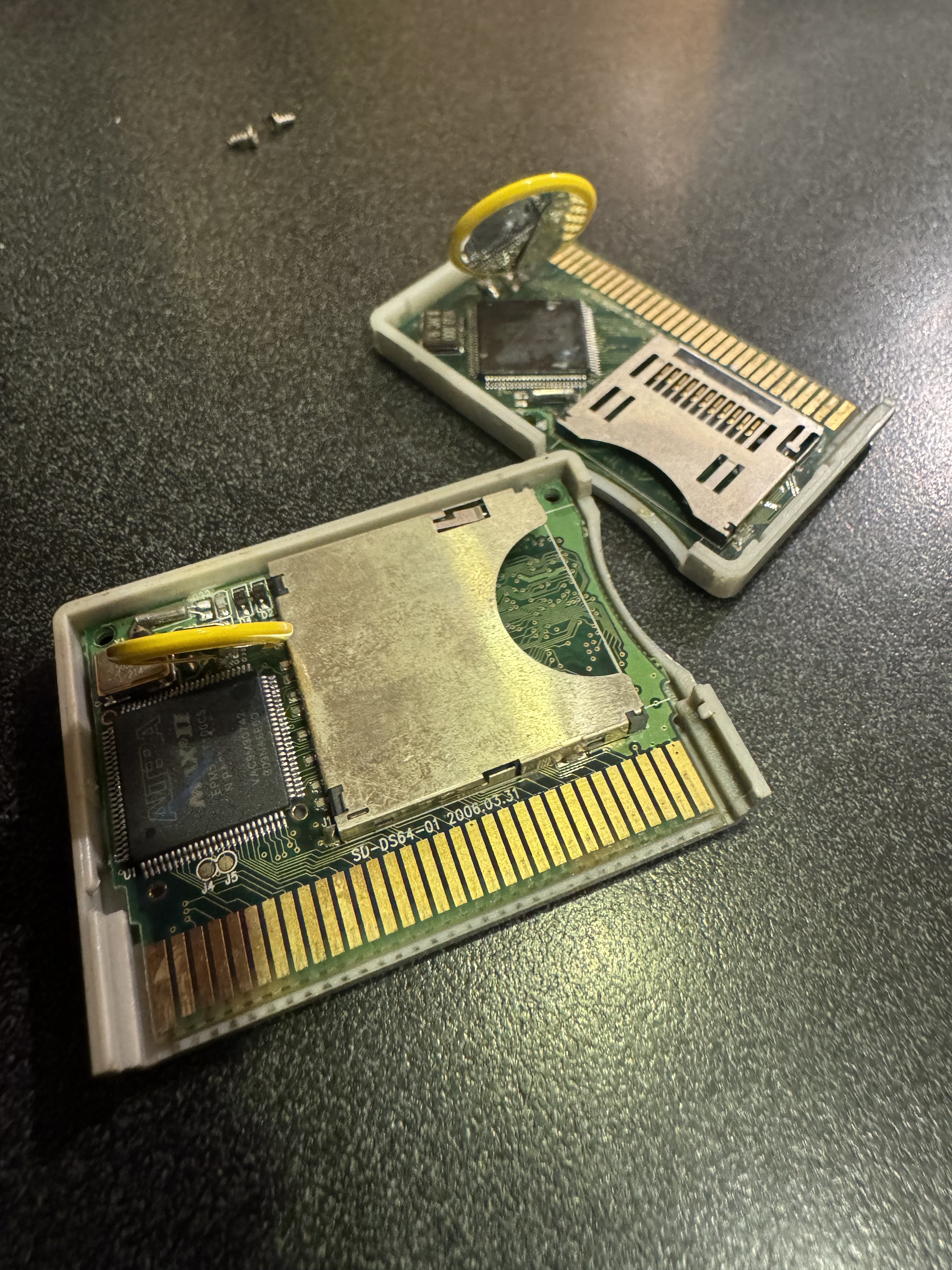

Well at least they haven’t corroded all over. It’s a bit late and I don’t know if I have a multimeter and definitely don’t have the other tools to fix it atm other then the soldering iron

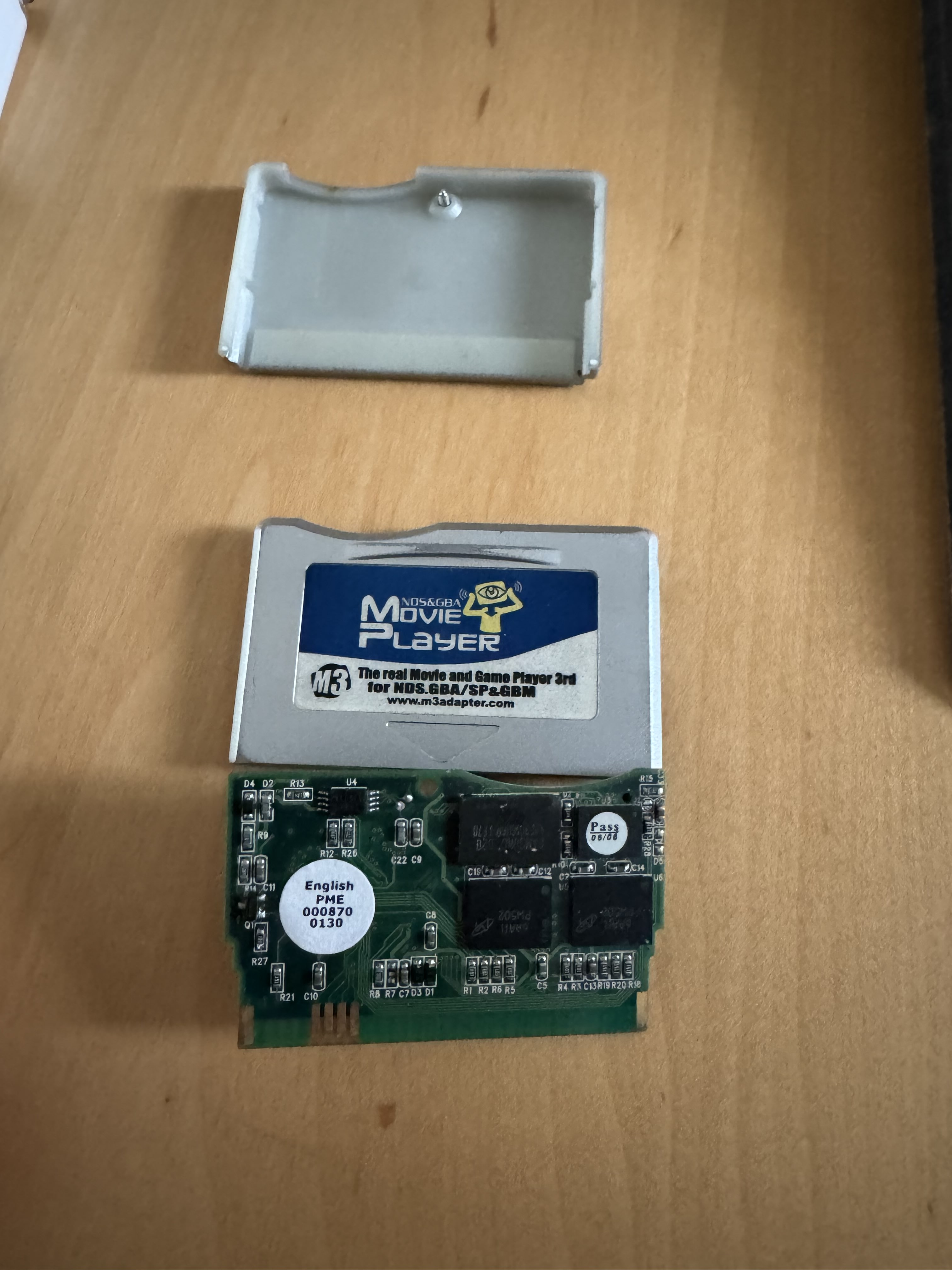

Is there a way to tell if either of these is the M3 Perfect or if neither of them are?

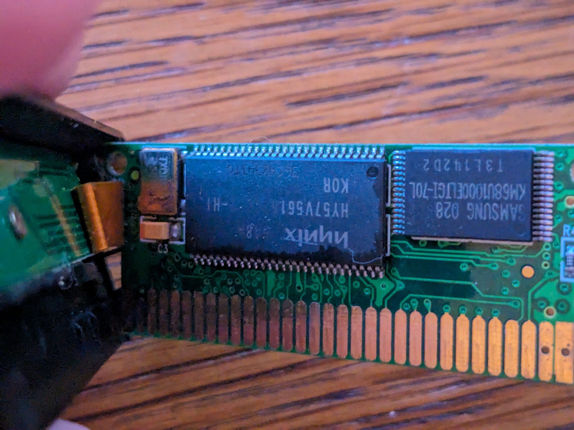

Open them and check for 32MiB/256Mbit of DRAM/PSRAM.
Or process a retail game through M3 Game Manager and try to run it (Pro can only run multiboots/256kb, Perfect can run most if not nearly all retail games)
Firmware and M3GM can be found here: http://linfoxdomain.com/nintendo/ds/ under the "M3 Perfect v31-v36" category. The prefix depends on the cart language, e* is english (and only goes up to v35. can still use M3GM-v36 with it). Most of these *cannot* be language-changed, only aware of the CF version being able to do so first-hand.
Also when soldering new batteries to these, please be careful. First of all, if the cart uses an ML (rechargeable) instead of CR cell (only aware of the lite doing this, but just in case), you *must* replace it with an ML (not VL, higher voltage!), or protect the battery from being charged. And secondly, use good tools, no direct-to-wall irons (not talking about portables like the pinecil, but those that go straight to an outlet with a regular AC cord) or gas irons, both of which are gonna scorch the fine pads and pull surrounding components off.

Which part do I check for the RAM?

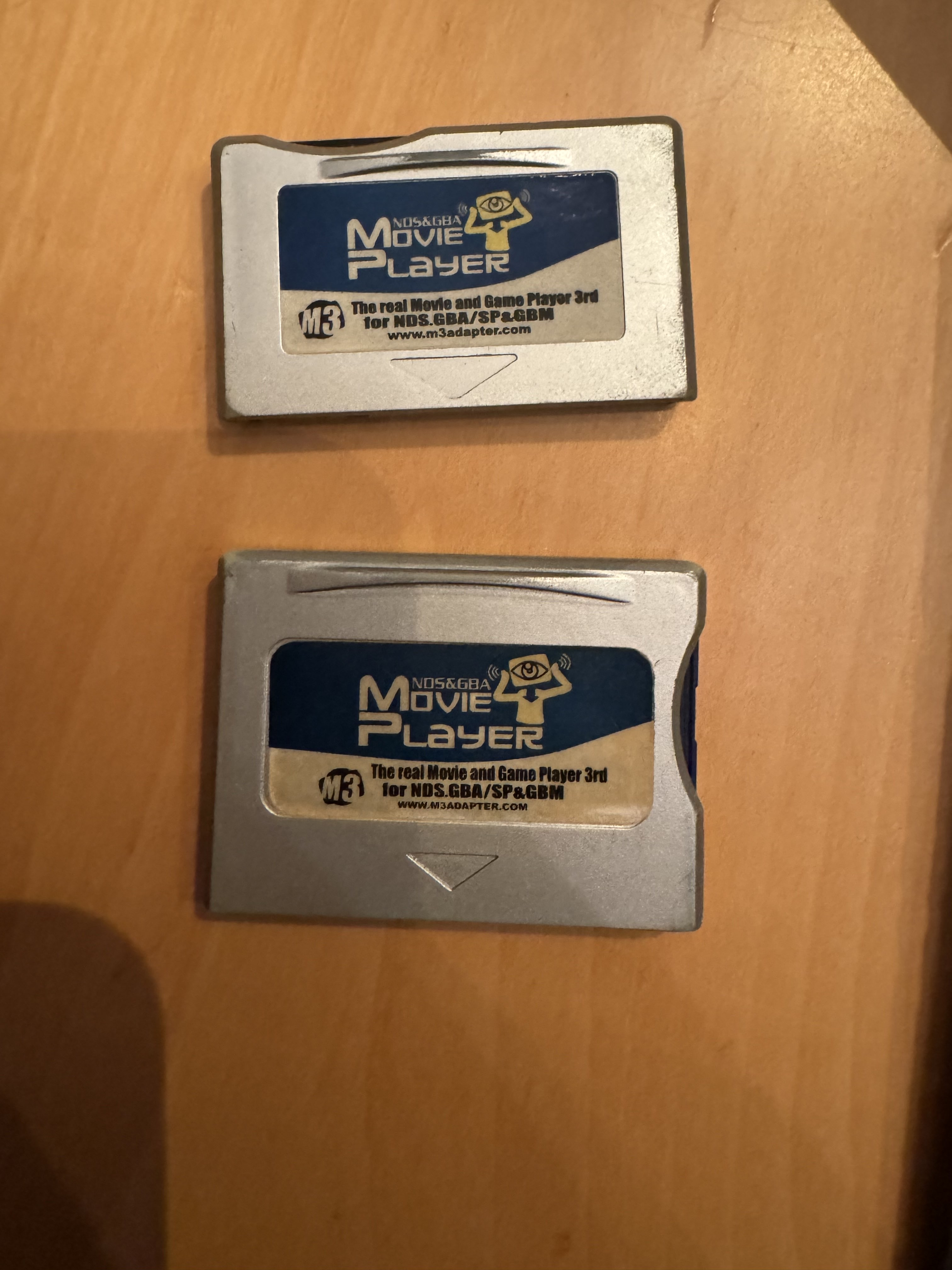

The branding confuses me, but the bottom one appears to be the M3 Perfect SD Lite. It should be good, I think.
The top one I have no idea. Google suggests it might be some version of a M3 Pro but I can't find a definite confirmation of that.
Confusingly, there is also a M3 Lite Perfect, which is a newer and entirely different cart only compatible with the DS Lite.
M3's branding and product naming is confusing, they had too many models, and information is hard to find nowadays, I'm actually unsure which models are good and which ones are not.
The only information on the top one I could find is this thread: https://gbatemp.net/threads/which-m3-gba-flash-card-is-this.353463/
Which suggests it could have either 4MB RAM (which would be bad for GBA) or 32MB (which would be good) and the only way to know is to open it up and look at the chips.

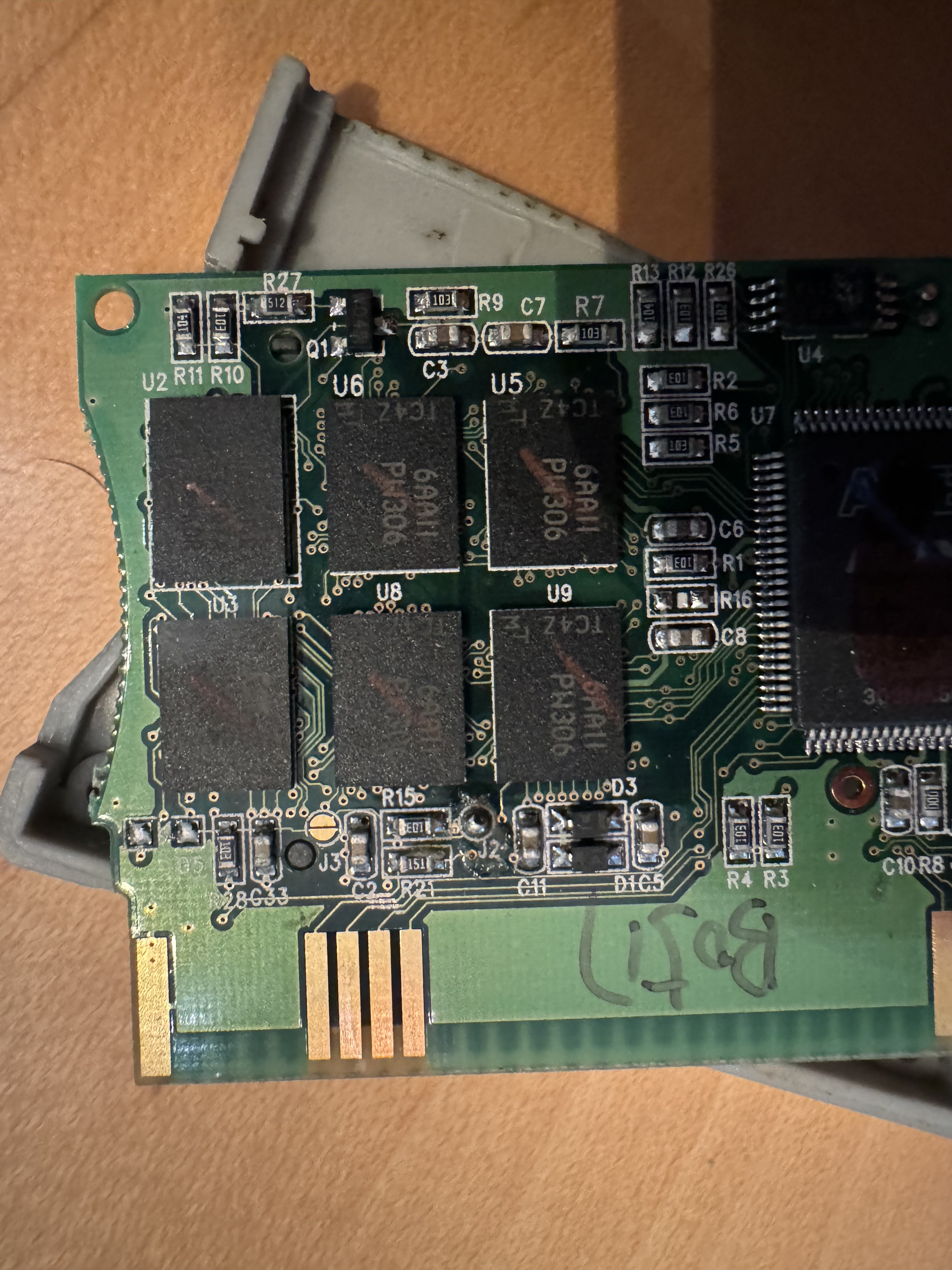

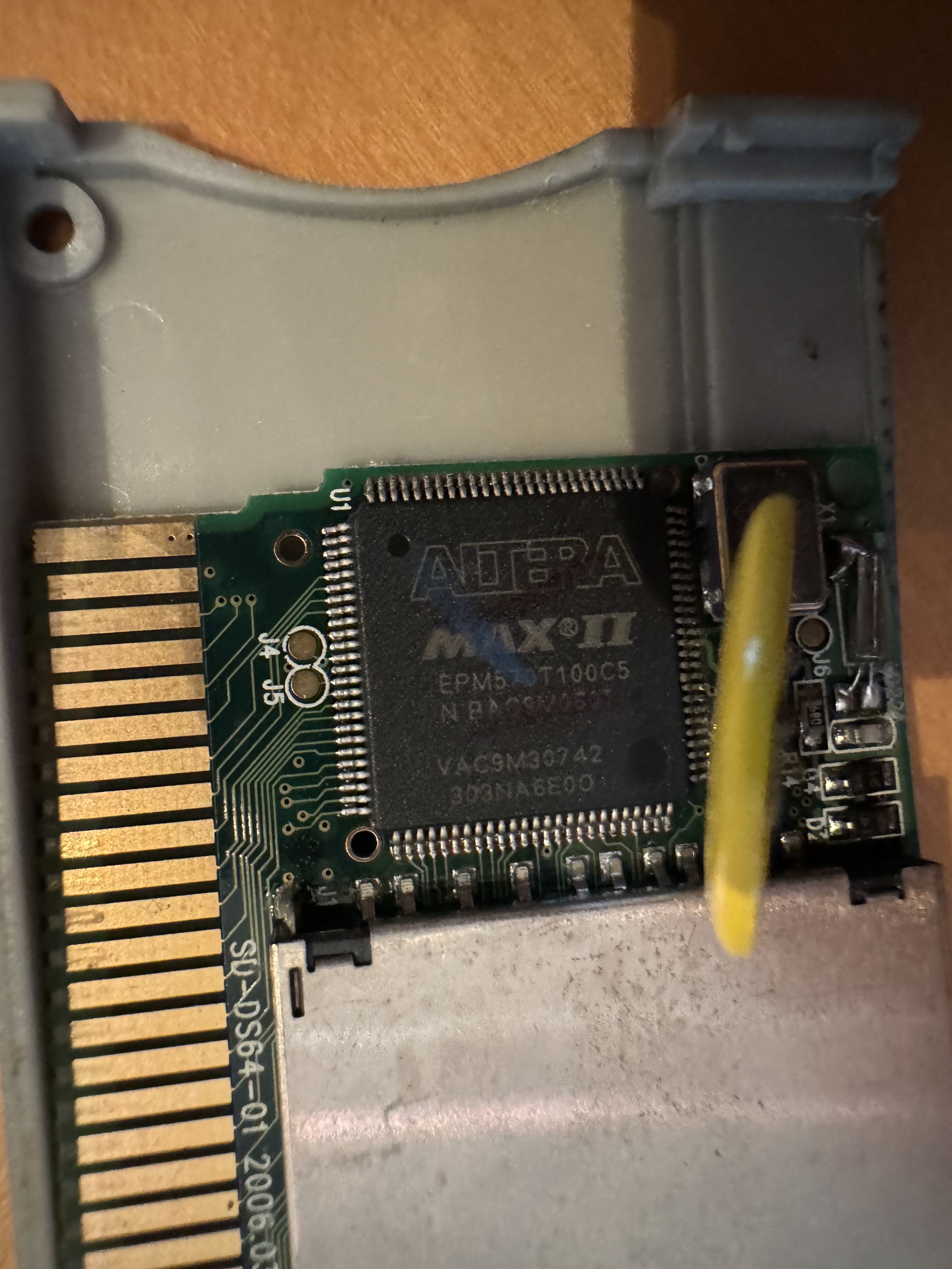

Both of the most recent photos were of the same card just on both sides of the pcb. The top loading SD card m3 didn’t just slide out so I left it.
Those BGA chips on the left of the lower image. That's definitely a perfect.
Okay so in all likelihood a new battery and updating the firmware will make it a great choice for backing up my old GBA games without shelling out for the ez-flash omega de?

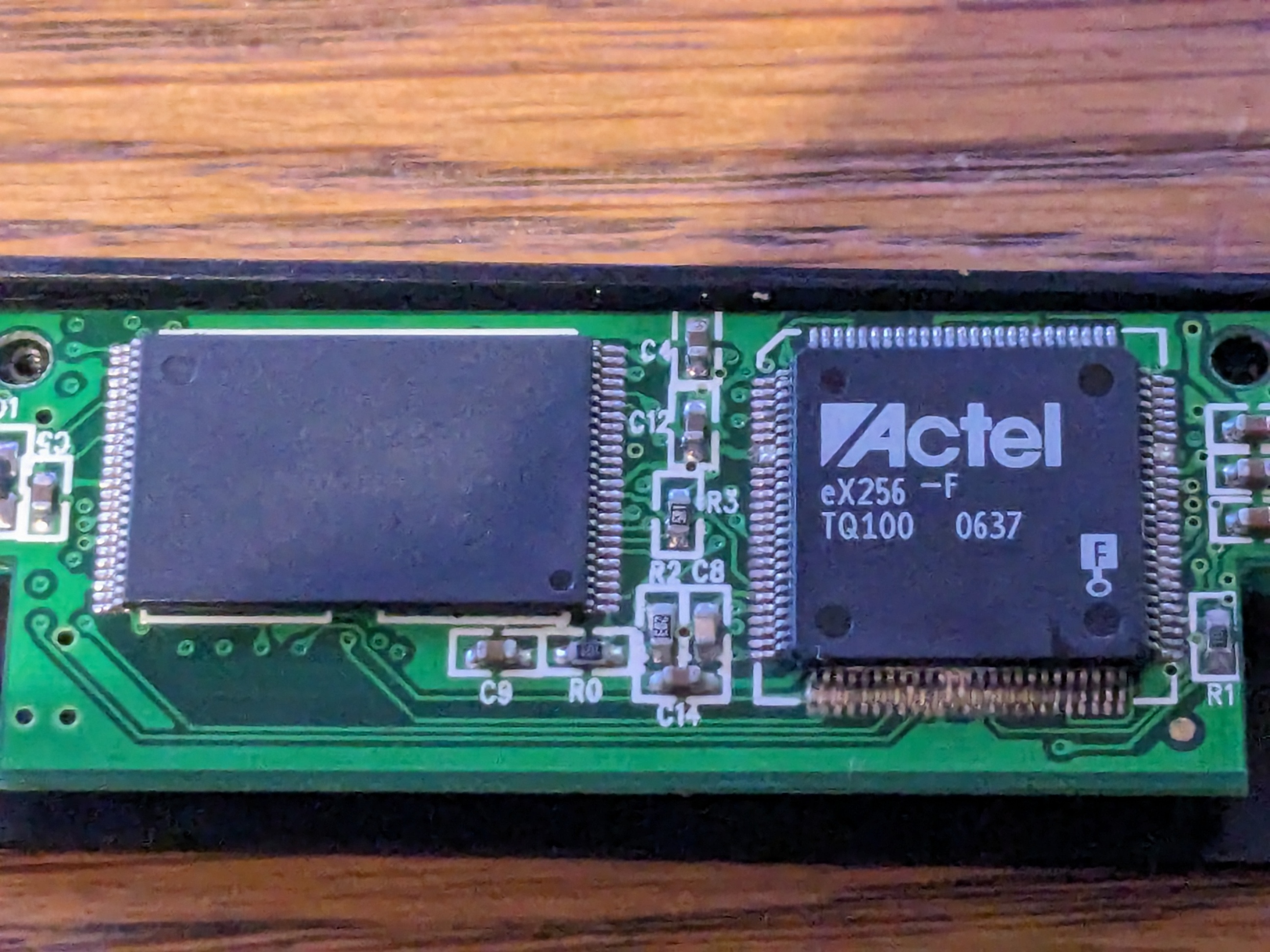

Here's the images of the toploading one better laid out.
