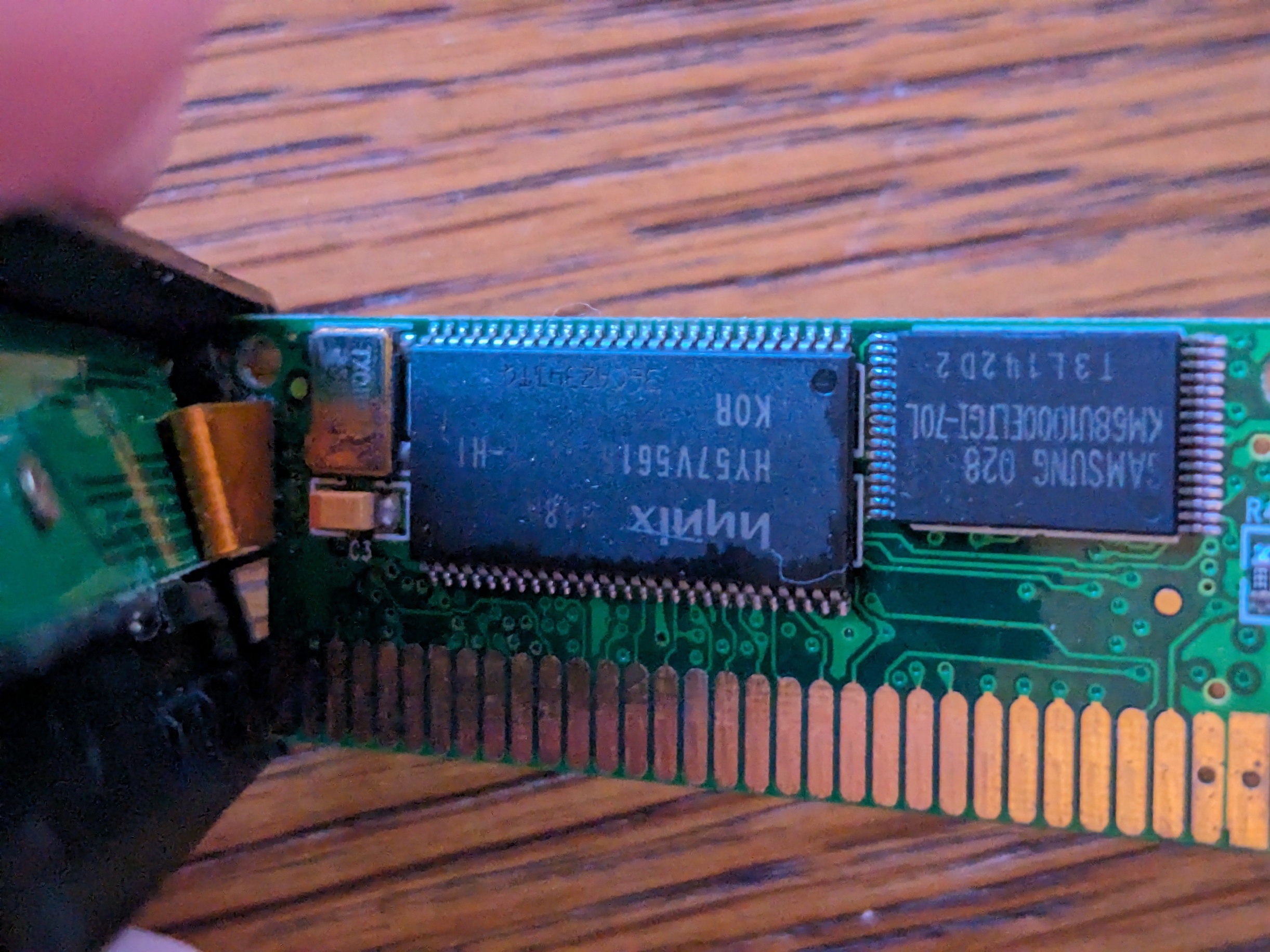

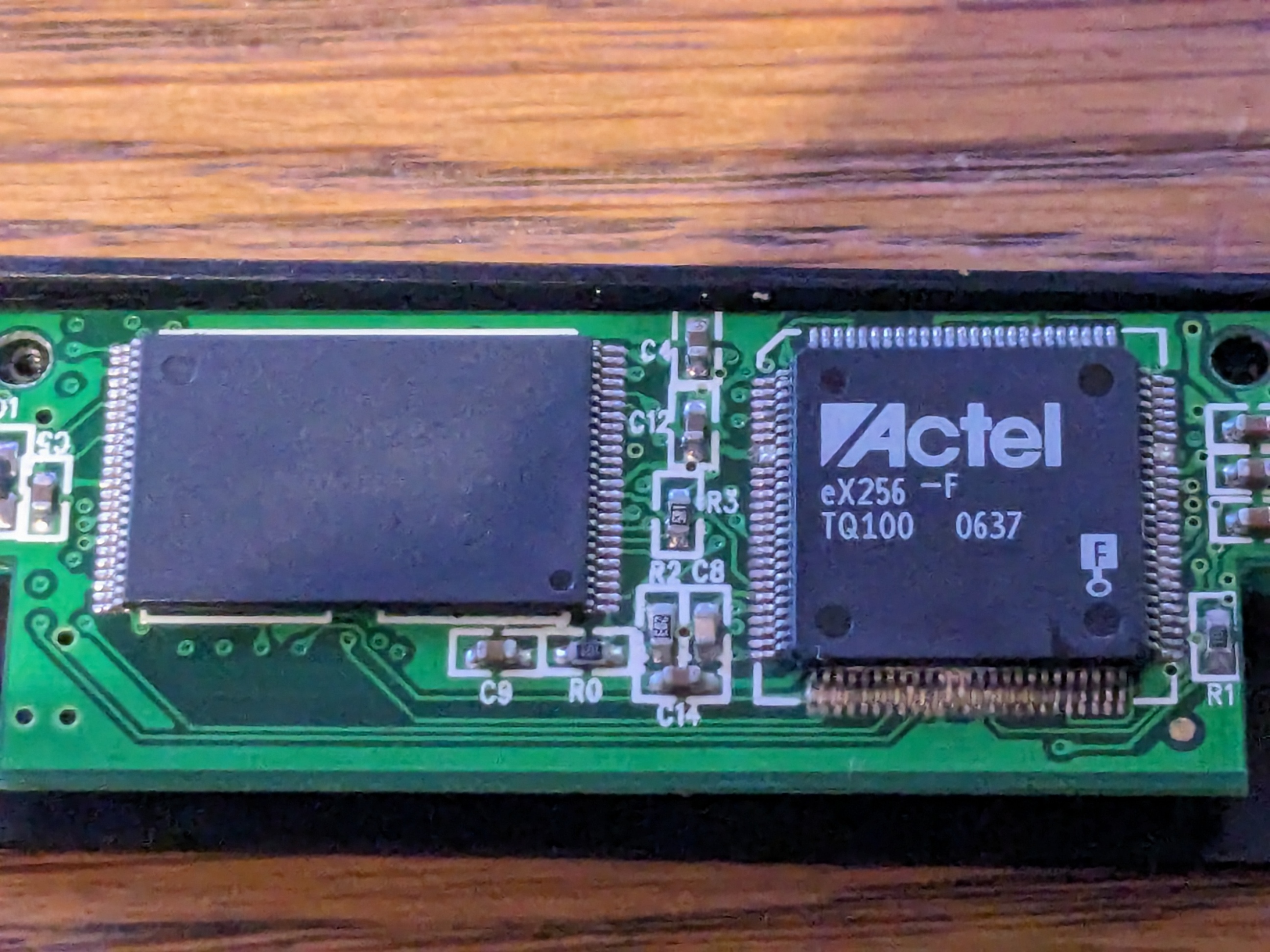

I'm not sure if the GBAMP has the onboard NOR flash or PSRAM that is needed for good GBA performance. When people refer to M3 as one of the best GBA flashcarts they are usually referring to the M3 Perfect, but some versions of the M3 lack NOR/PSRAM.

Is there a way to tell if either of these is the M3 Perfect or if neither of them are?
