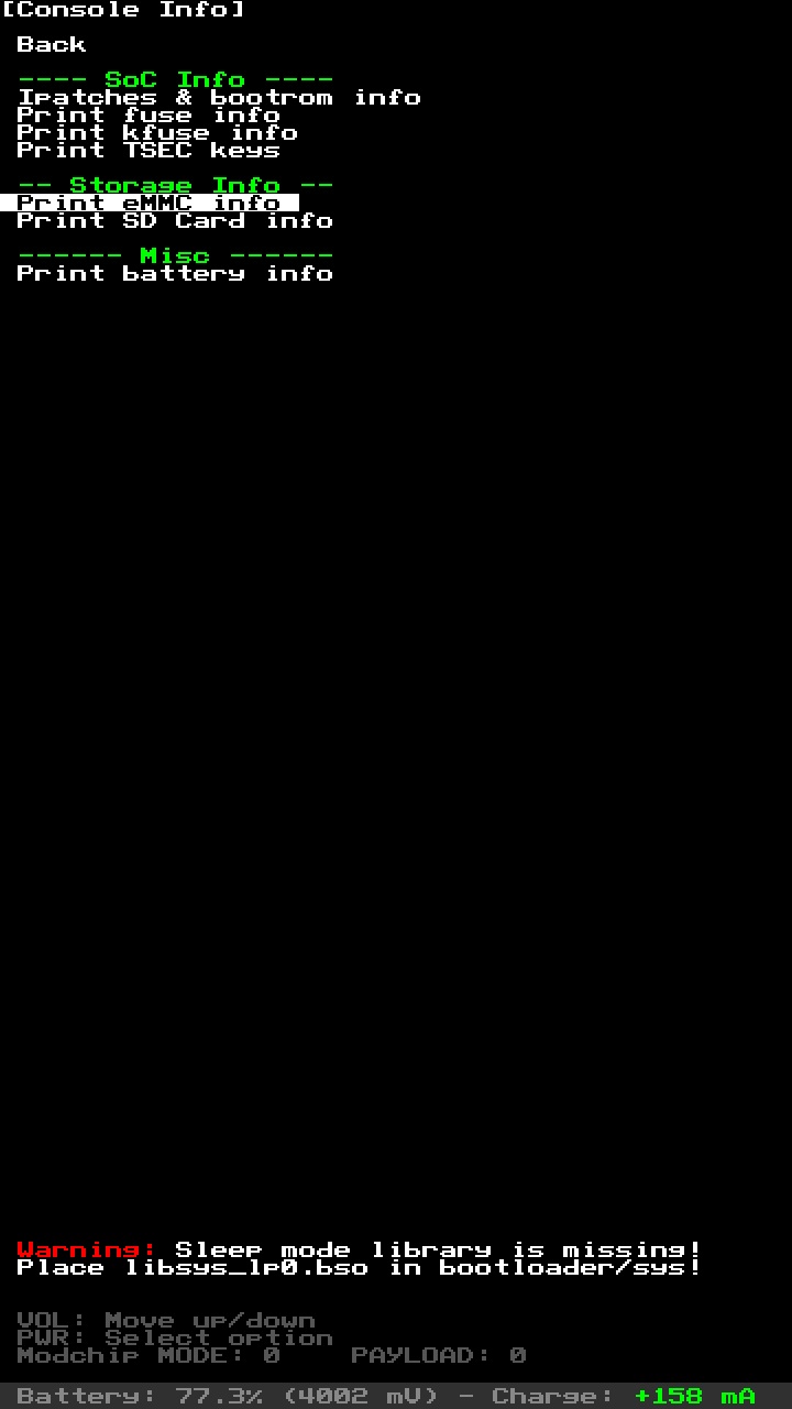

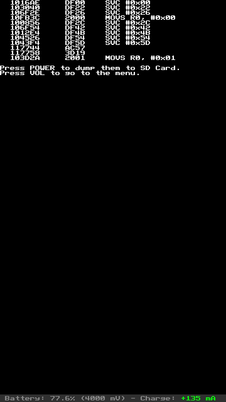

To whoever may be interested, I`ve made a screenshot feature for Hekate...
Example screenies here...
Do I put the feature in 0.9.9r2? Just a hold of both vol buttons. Would it be used?

As for the screenshot feature in hekate, I'd say get it in if users can easily toggle it on/off.

Attached is a bin file.
My take on Hekate with screenshot feature.
Wondered if someone would be so good as to give it a launch with TegraRCMsmash or rename to "payload.bin"
To use screenshot, on any screen you want to shoot, hold power button and touch vol+. Then let go.
You will see the screen turn upside down, then the right way again. Screenshot should be saved in sd root /Screenshots folder.
Someone give it a look and tell me if I should include in next release!
Cheers Matty

I`ve made a screenshot feature for Hekate...Do I put the feature in 0.9.9r2? Just a hold of both vol buttons. Would it be used ?
Tried Hekate with screenshot feature. Toggled to Mode 3 Argon NX and named the Payload 4 with Trinket M0. Held power button and touch vol+.
I find the screenshot feature pretty cool ! It's always good to have a bmp instead of a binary for convenience to my opinion.
