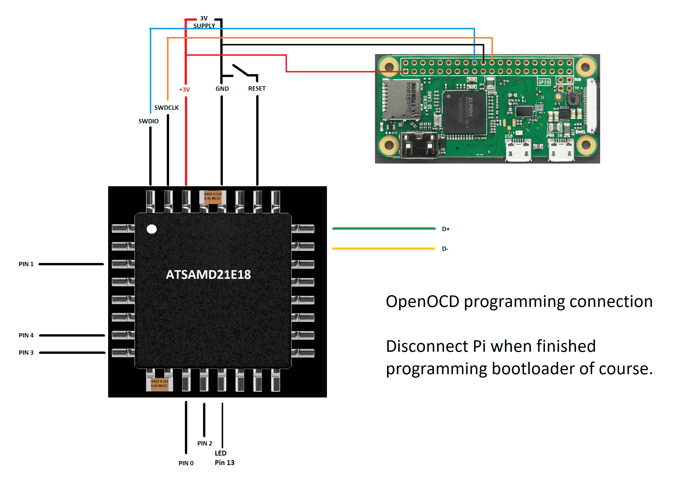

Amy chance of posting a video of your problem? Would help me more

What pins do you have connected on your board? Any chance of a picture of it?
Yes, thats right. Also same thing is happening when I plug it in when my console is off. And I think pics cant help cause my board is in still breadboard and wires are too complicated. Of course I still can share pics if you want :)
By the way, I followed your guide to connect pins. Like the diagram attached.
Seems strange.
The payload pushing code hasn`t been altered at all.
I`d check your joins one more time. I have a custom made "dongle" on breadboard and I cannot reproduce it.
Puzzled I am.
