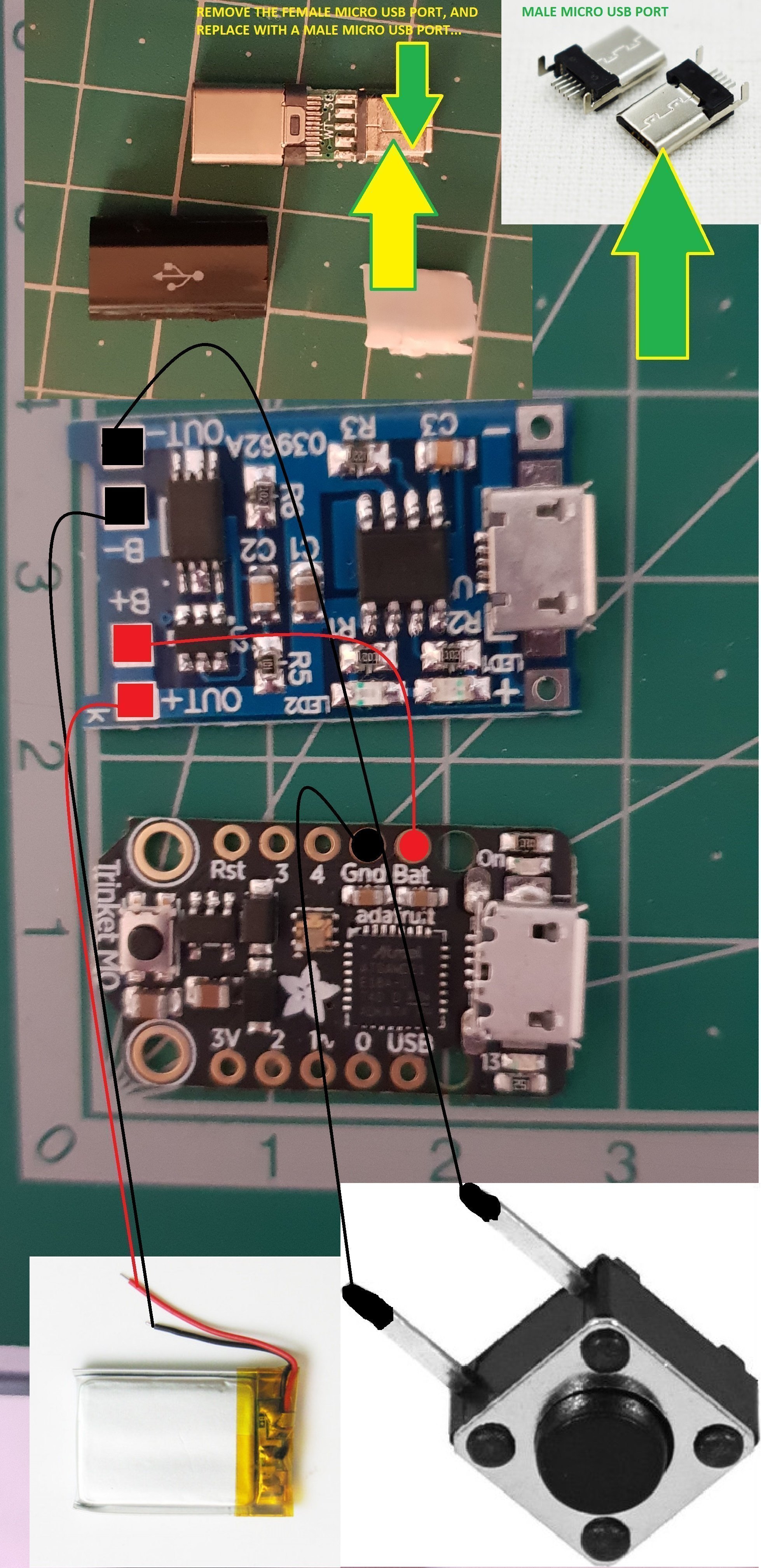

if you need a guide on doing a dongle then I sort one out, but still requires soldering. but it's a lot less risky than this one..
this one requires a micro usb male to type c male, which are easy to make.

If you want something with built-in battery header and integral on/off switch, I recommend a Gemma M0. I have a few and they work very well. Bound to really since they are SAMD based like the trinket...

In mattytrogs world, I use trinkets for internal mods and Gemmas for SX Pro clones. You can fit a TP4056 board to charge a Lipo battery if needed. Gemmas are ideal for coin batteries as they are erm... round.
I'm thinking in enter in mattytrogs world. In amazon.it i've found it at 15€, searching for coin cell battery holder on amazon.it
The process is the same for trinket m0 and Gemmas right?
