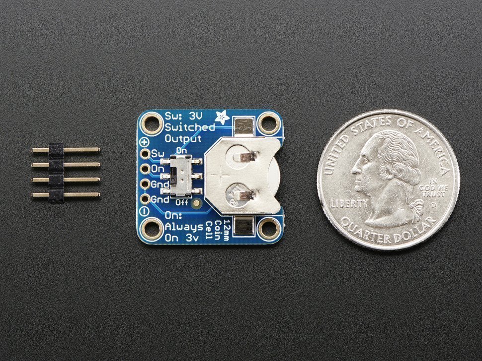

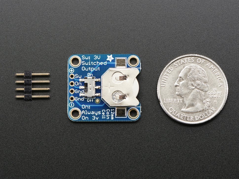

something like this will be ideal 12mm or 20mm with on/off switch for dongles.

something like this will be ideal 12mm or 20mm with on/off switch for dongles.View attachment 134321 View attachment 134322

Yep that's what i've bought! I'll stay with trinket m0 and this coin cell.

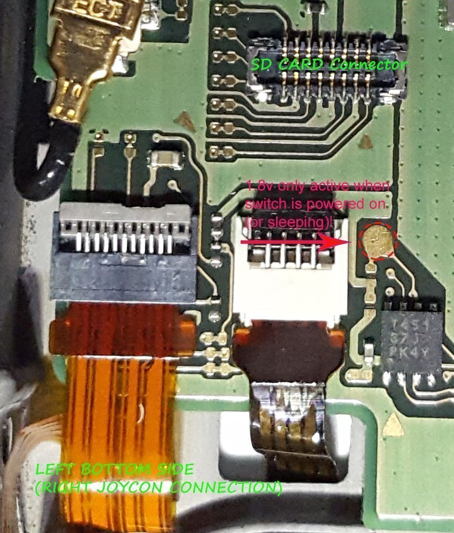

So I found a possible alternate power point that only puts out 1.7-1.8v, is definitely AFTER the voltage charge circuit and when the switch is OFF there is no power at this point (so no phantom draining the battery down to 0%). This would allow the LDO to isolate the trinket and only power up when the joy con rails energize. The original method is a constant voltage whether the switch is on OR completely powered off.
Here's an image I took showing the exact point:
I also want to find a better spot for wire #4, the points it hits are so small it's just asking for trouble from anyone attempting this themselves who isn't amazing with a soldering iron.
@YigglyPoof If we can find a better spot for wire #4 I'd say go for it but right now there's just too many tiny surface mount resistors/capacitors so close there. It looks big in the pictures but seeing it yourself you are just like GD that's a small spot to tag a wire to. I'm comfortable doing it and I don't even want to do it lol.

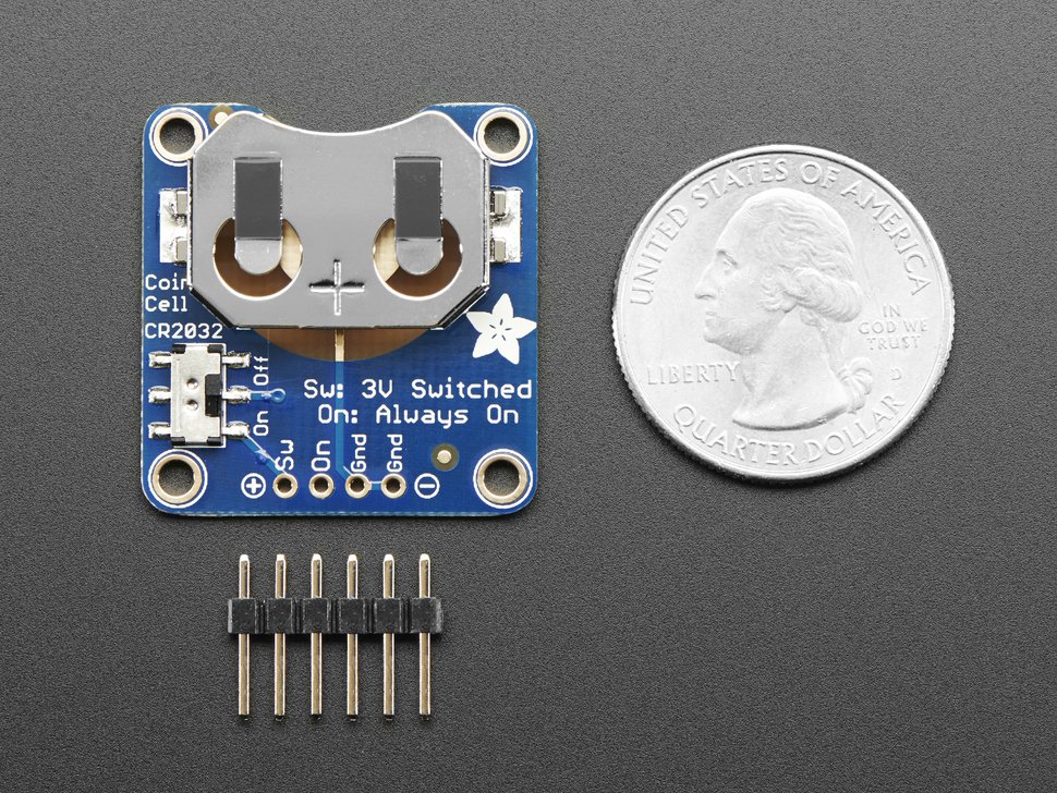

well them 20mm cell bat holders are twice the size of the trinket. maybe the 12mm version maybe more ideal to use for dongles.
the switch has plenty of points like that, as for a pad 4 or point 4 it gets 3.2v once the switch has been power on. so I'd say a point on the mobo that can do that then should do the job.
the usb point on the mobo may do the job, but I think that kicks out 5v when I tested it.
in theory you could get a regulator to drop the volts to 3.2 volts, just like the Xbox 360 does.
