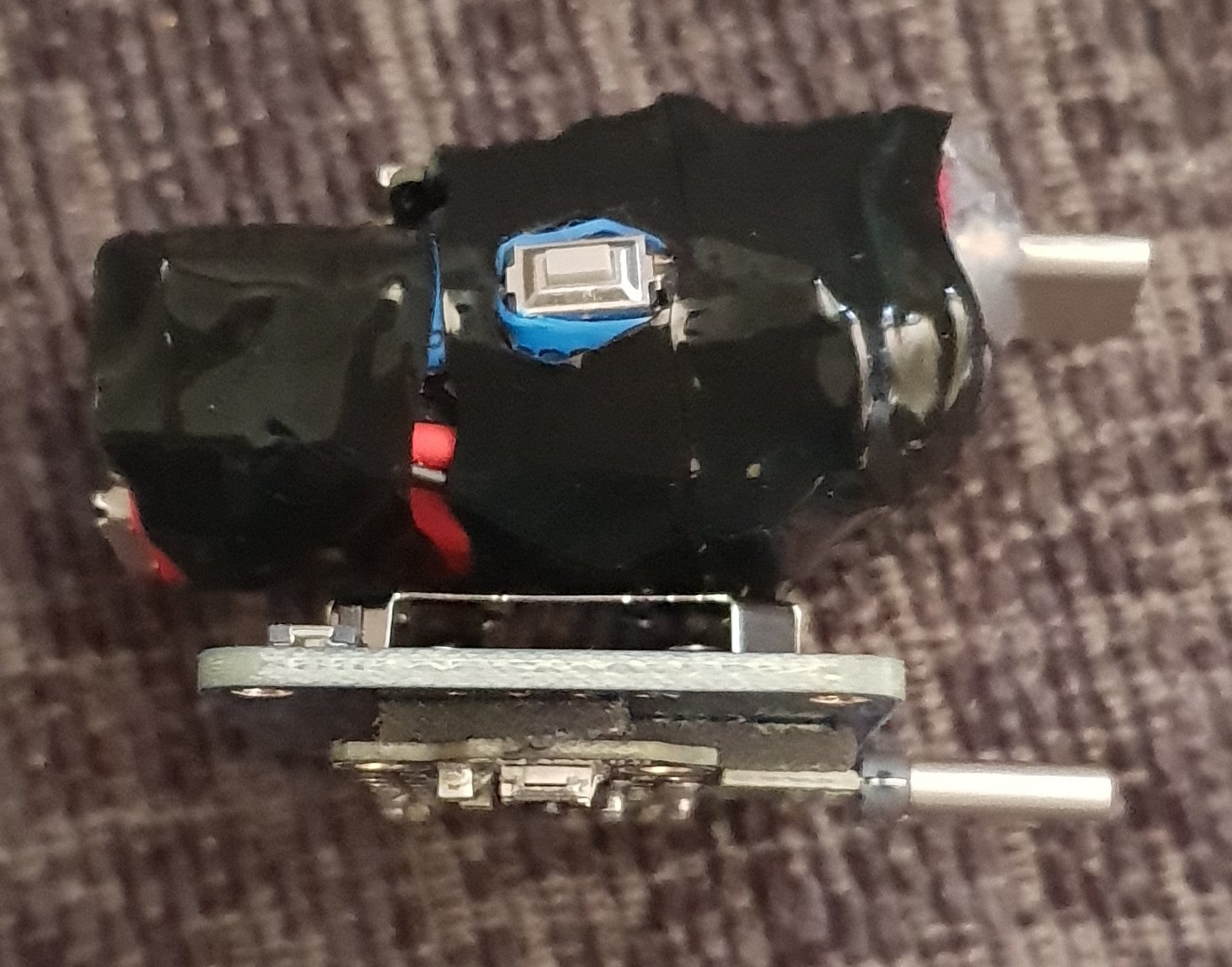

my 2 dongles once I put the wires on the second one, a lot thinner than the first one, bet the team matrix dongle be something like the second one but in a case lol.

ok so had another play about with this, this is another variation of the install using 2 different codes, one that was posted by nihoh-fox in a thread on here and the other was done by Xboxexport or Xboxexpert can't remember exactly.
both codes seem to work fine with this method, I have not used pad 4 at all as I'm trying to figure out a easier install for them that ain't up to par with soldering aka the novices.
we all know that the cap for pad 4 can be tricky, anyway I think that this may do for another method for the install.
I have decided not to use the volume up button as that chucks out 1.8v not pressed.
anyway I noticed with the first code flashed to the trinket that if I pressed the reset button then the switch went into rcm mode.
so as the rst pad gives 3.2v I decided to test the power button on the switch and it gives 3.6v but maybe more if my battery was fully charged.
so I solder a wire from the rst pad going to one of the points for the power button and bingo.
press power button twice to reprogram the trinket.
