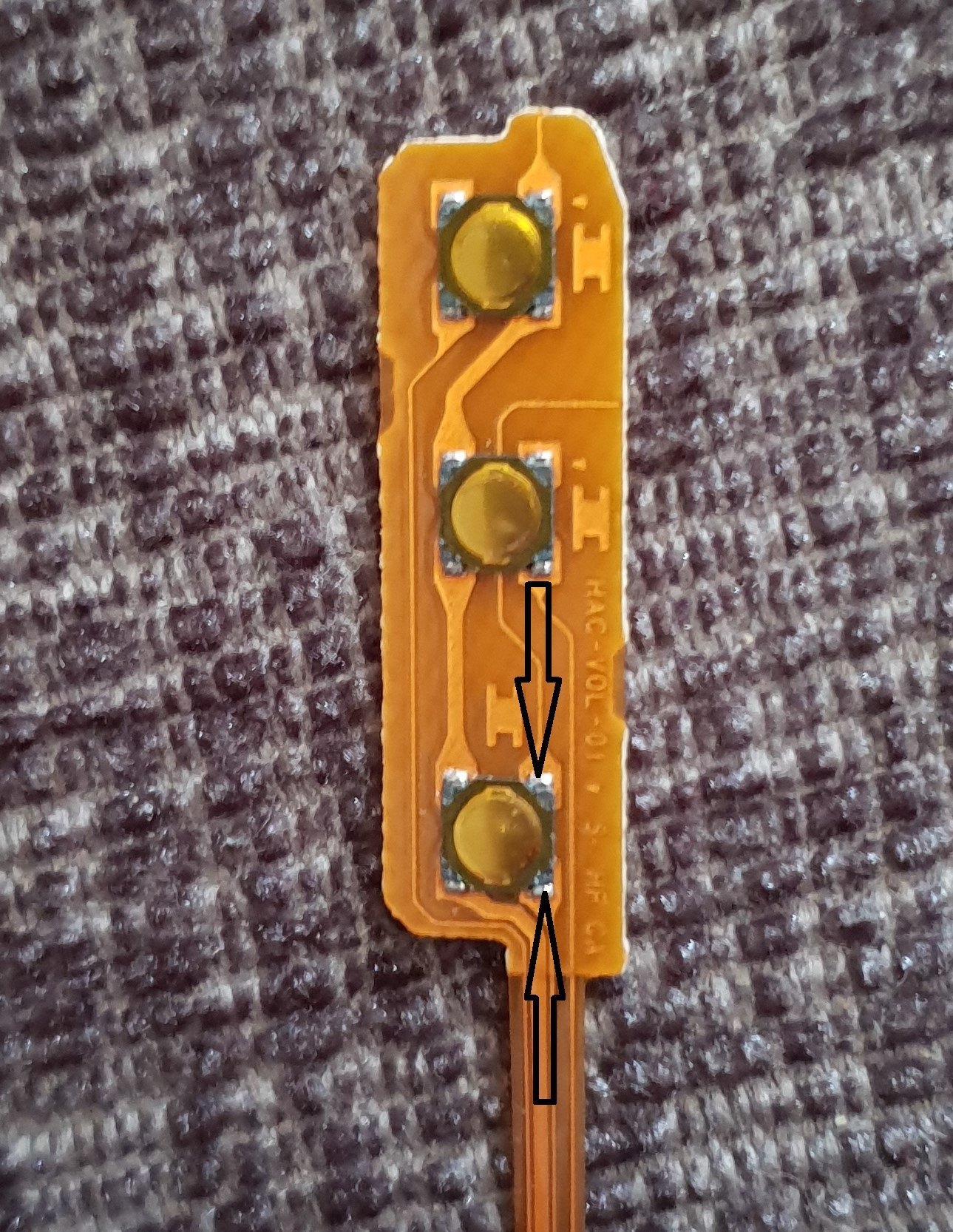

images are in the op showing what pads on the trinket and the poibts they goto on the switch console.

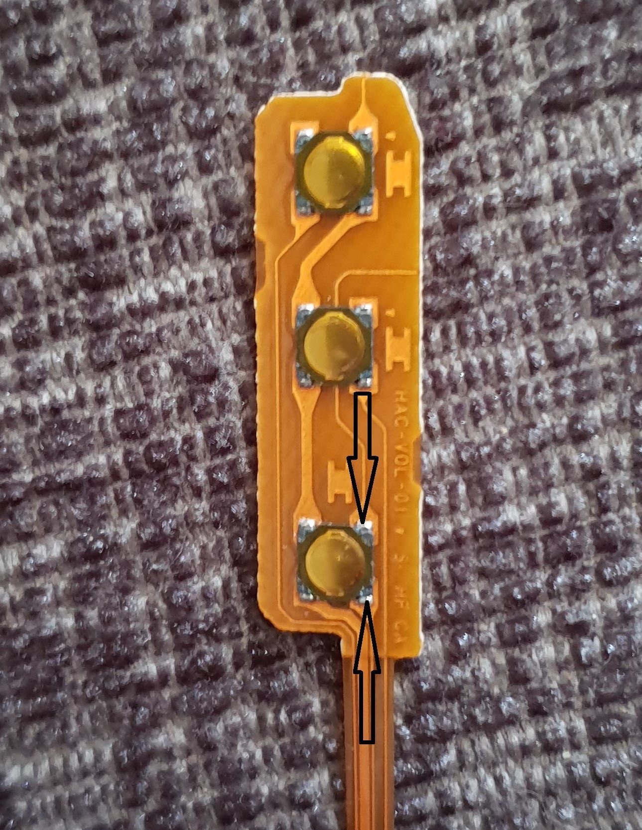

the ino is for here looking at it has a volume up button line added but not sure exactly what it does as never tried it.

this was the actual pad I used on the vol button.

this was the actual pad I used on the vol button.View attachment 134564
omg lol I was just about to upload the volume + key ground image too xD
Edit: Ok so in the original code it looks like the volume + was being grounded for us, so you wouldn't need to hold it down. That's where the pin 0 references are from.

using the vol+ button as you have described would only be doing the same thing as any other method for rcm mode. just use the PAD 3 from the trinket going to PIN 10 on the joycon rail your not getting a continuous contact with this method.
or use your normal method to get into rcm mode, PAD 3 is optional.
