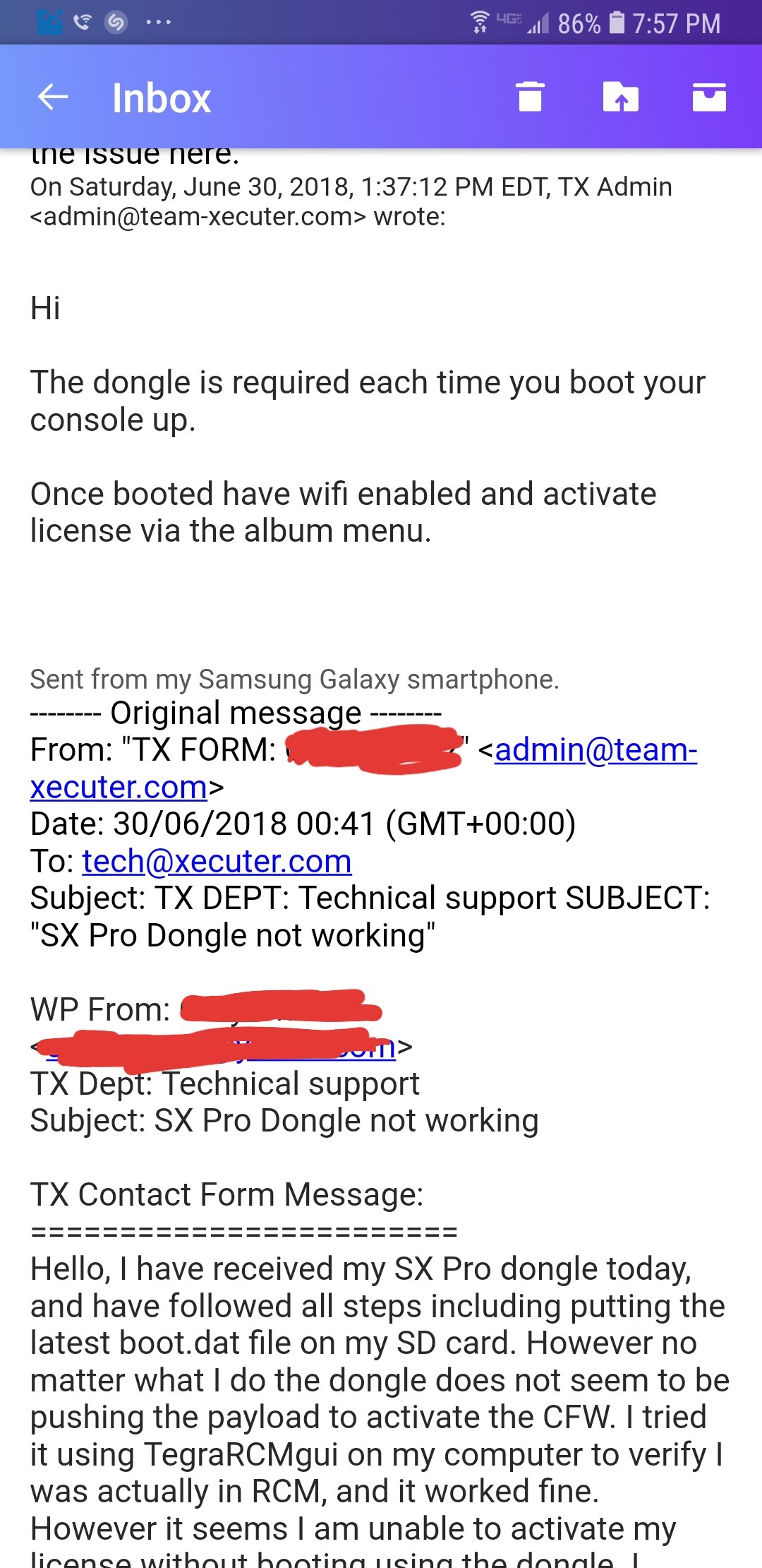

I emailed TX and got an obvious copy + paste response that made it clear they literally couldn't even be bothered to read my email. Seriously starting to regret this purchase if this is the level of professionalism I can expect from them.

I have it charged up with the green light, latest boot.dat file on SD card (even redownloaded it to make sure it wasn't corrupted). Nothing is getting the dongle to push the payload. I know it's getting into RCM correctly because I was able to boot SX OS unactivated with TegraRCMgui. Tried booting it both with the dongle in on power, and tried putting it in after powering up, neither did anything. I've emailed both ModChipsDirect and Team Xecuter about this issue, but wanted to post here to see if anyone else has run into this issue and/or has come up with a solution.

That email was from Team Xecuter, not ModChipsDirect.
