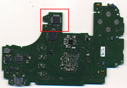

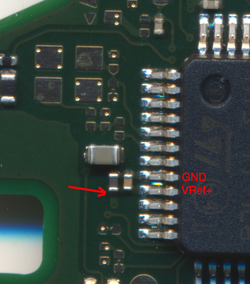

Since both your analog sticks don't work, it is likely that something is wrong with the chip that converts the analog signals to digital signals.
Maybe check in this area if there is damage/ scratches/ knocked off components.
If your buttons are working, presume the chip itself is working.
For converting signals from analog to digital, a reference voltage is needed by the STM32F038C6 chip.
It seems to be shared with the audio IC on the other side of the board and that needs a VRef of 1.8V.
I could not find where it comes from because it goes under the ALC5639.
If the audio was working, then presume that the component that generates the 1.8v is working.
If the audiio also does not work, maybe check if all components near the ALC chip are present.

Thank's for the reply, very helpful info!
I'm not home right now (I can't check my Switch Lite rn) but all digital buttons work properly, and both speakers/audio are functional.

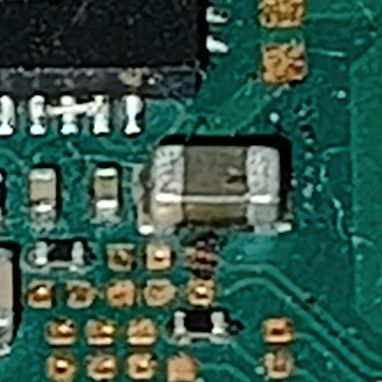

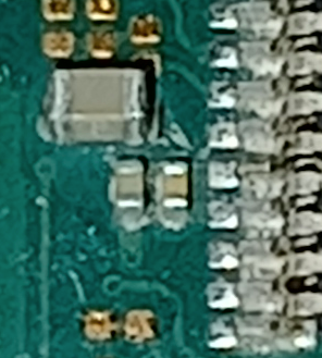

Here are the pics of the area STM32F038C6 and ALC5639.
Did it have water damage?
This looks a bit corroded between the capacitors and the pins.
Maybe a good clean with IPA alcohol might solve your issue.
Maybe this is just dust on those 3 pins in the corner,
Also check out the big capacitor.
That area looks strange but I don't know if that is coming from the capacitor.

Sorry for the bad quality photos, it might've over sharpened some aspects of it.
I can't confirm if the SMDs near the STM32F038C6 have corrosion or not but I now have access to a multimeter, I can check if the 1.8v reading is present or not later.
Can I ask if there are specs for the three SMDs? (like the Switch V1/V2 here https://gbatemp.net/threads/compone...stly-the-motherboard-and-main-console.525026/)
The 3 pins on the ALC5639 absolutely looks fucked, I'll check it later if it's just dust or not.
