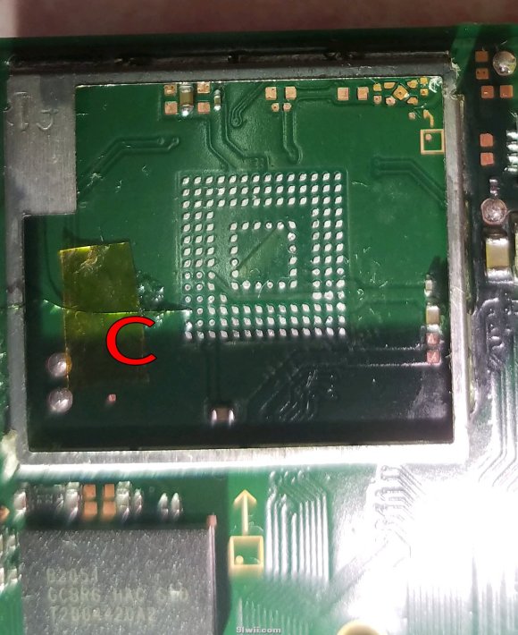

Some guy posted simple installation picture on Chinese website.
It seems that they detached the eMMC lol
https://tieba.baidu.com/p/7573220146
If C is the only possible attachment point you can probably get the wire there without lifting the nand chip by heating the nand up and slipping the wire into the flattened solder ball... actually that's not going to work because the grid is much smaller than the size of the chip, it'll have to come off unless another point is found. You might be able to drill to it from the opposite side of the board with a stencil... but that's probably not going to work either because the other side has the oled and daughterboard connectors in the way.

So the only difference in installation of the core chip would be just direct cabling to the Nand. Is everything else the same
If someone can help. I have friend who does installs for YouTube. Can someone give pictures or just a labeled photo of where to solder to on the SX chips. He would like them for both core and lite but either one is ok. He just wants to make sure he knows the correct points to solder stuff to on the SX board. Once he has them he may attempt an install.
We literally don't know...
The pictures on this site show you the points:
The last picture shows a Core modchip.
