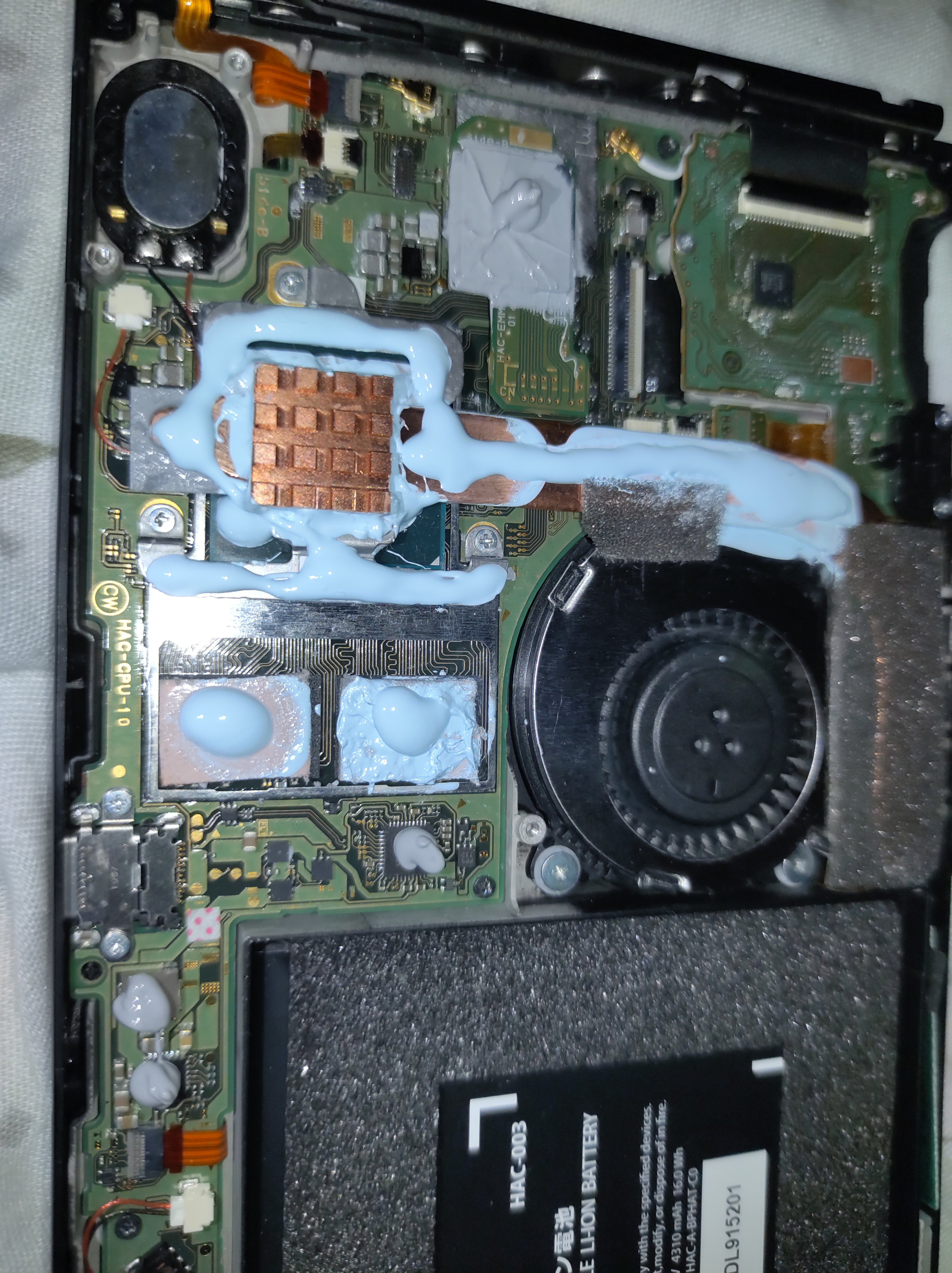

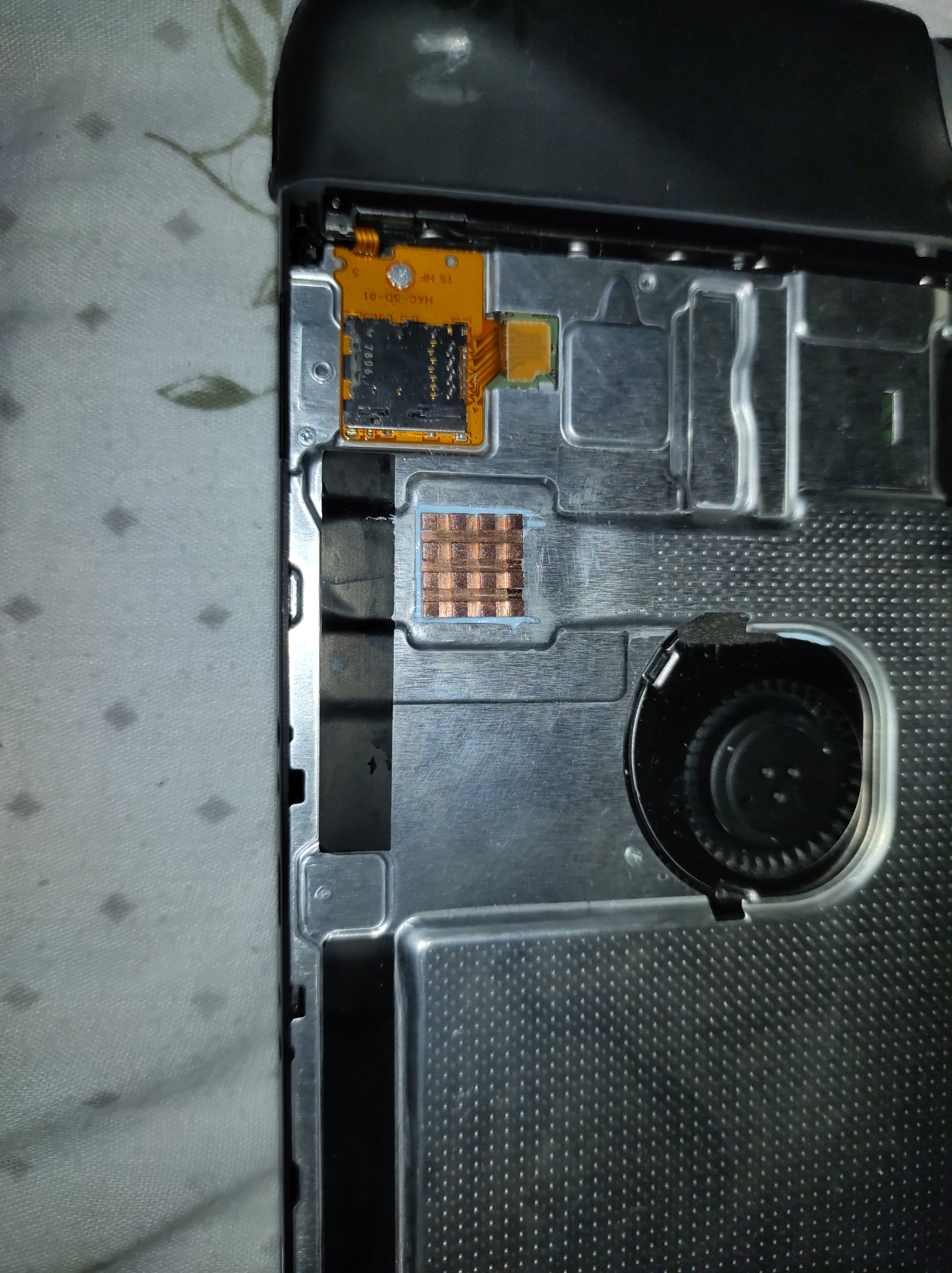

Care to spill some beans about that 'modded cooling'?
I already posted more than once on Gbatemp in different threads...
But here you go:
Basically:
- the perfect amount of thermal paste :D (blue = MX5, gray = MX4 and on the die I might have used Thermal Grizzly Kryonaut, can't remember);
- no SOC copper sheet + no SOC metal shield + 2 sadly a bit thick thermal pads stolen from my old AMD GPU;
- small full copper memory cooler on top of switch SOC cooler heatpipe with thermal paste below;
- Switch metal backplate cut to accommodate the small cooler (and probably gets more efficient cause since the fans push air from below it there should always be at least some tiny airflow going trough in their way to meet the fan);
- the rear Switch plastic cover put pressure on the added copper cooler to make good contact with the Switch cooler pipe.
Nothing of this is needed anyway and I have no measurements cause I did it some time ago and never tracked temps back then in SX OS, but it should probably have very similar temps to stock at least handheld but with the fans just running always 100% silent in min setting (I have no custom fan curve so it shouldn't be far from a stock Switch which will simply increase fan rpm to maintain whatever temps of it's stock fan curve profile).
EDIT: In the future I might improve it by using better appropriate thermal pads and see what chips are having no contact with the backplate to clean them and use proper thick pads, but it will be a huge pain in the ass to clean all this thermal paste mess :ha:
But here you go:
View attachment 346607View attachment 346606
Basically:
Looks great. I will try to do the same with mine once I get some free time on my hands
If only it wouldn't require taking out that cursed SD cards slot.
Mounting it back in was a nightmare for me
