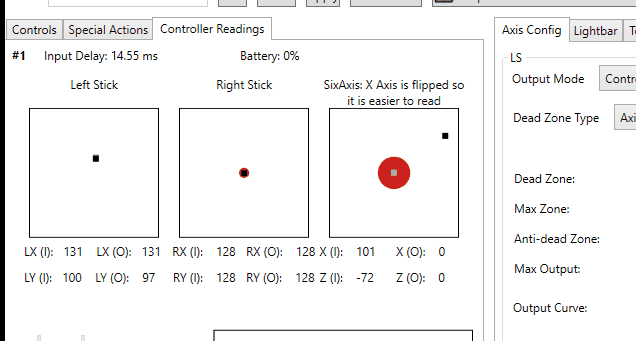

Hi guys,
Recently my left joy con analog started acted up in a strange manner. It is not drift. Whenever I fully push the stick up. It registers an up and down continuous motion. I have tried calibrating but in vain. I already had this analog replaced and I had 2 more spares. Replacing them still did not fix it. Which is the strangest bit. Anyone else faced such issue.
I doubt this is a console/OS issue because I could still reproduce the issue on PC connecting it via ds4win.
Hi guys,

As you can see it in the gif it is not moving on its own. Whenever I press it up. It registers a down and up, continuously.
Yes the idle is a bit off from the center. But it doesn't cause any movement in game
If you only push up and it register a down along with it, it is moving on it own, you should get replacement analog stick and replace it. I recently had one of my joycon drift, where it move on it own, I end up replacing the analog stick.
I have 2 spare analogs. I replaced and tried both. They also exhibit the same issue. It is hard to believe that the analog I replaced 3 months ago started having issue. Now 2 more as soon as I installed them have the same issue. Are they all faulty or could this be another joy con related issue?
yes welcome to Nintendo quality, has been people whom suffer for drift in weeks after replacement and others live years without it.
I do recommend to look for kits from reputable source. bad what for now there is not a really good Hall Effect replacement for joy cons.
