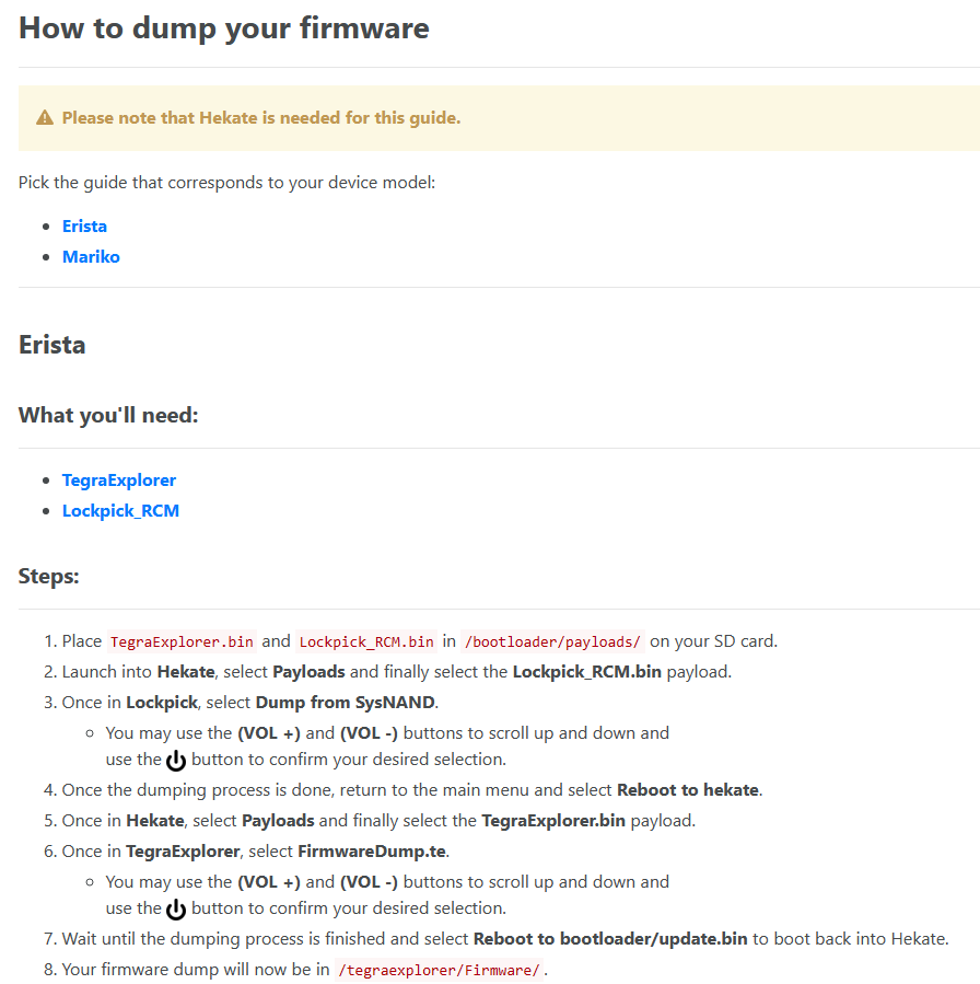

how do i know if im mariko or erista?
see pics below:
Im using modded switch Version 2. maybe this info can help.
Im seeing SXOS, Hekate and Atmosphere when starting up, or maybe its called Recovery mode.
then:
4Flash Spacecraft-NXView
5Update Spacecraft-NX firmwareView
then this two but do i need it?
see pics below:
then:
Check what model you have, Erista is V1, Mariko is V2.
