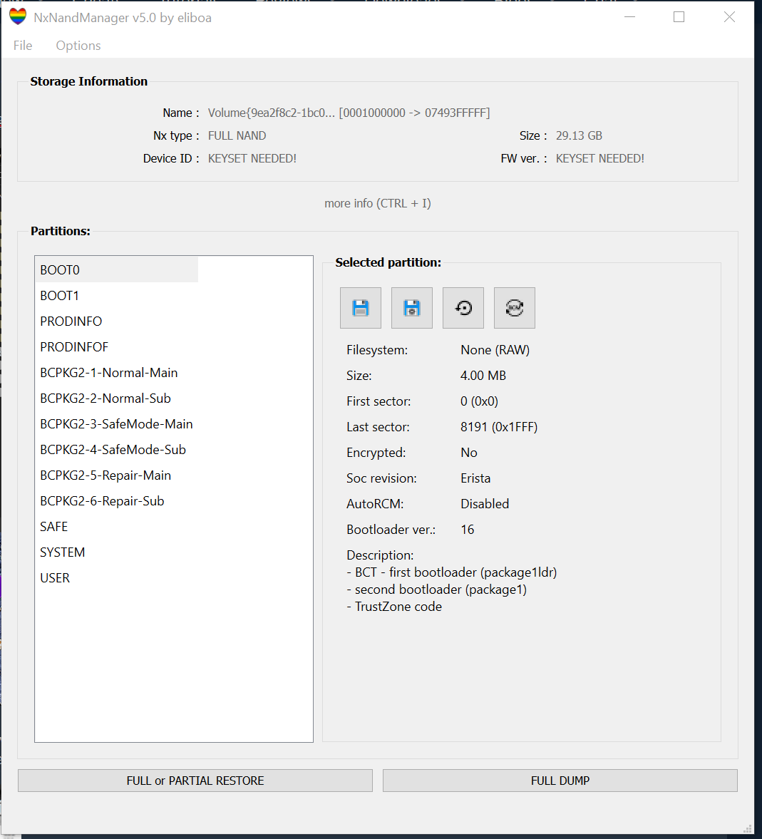

awesome i got my NxNandManager working. in the Hekate tools section i can only see misc: fix archive bit and calibrate touchscreen on the left side and on the right side it says under Others: AutoRcm off and a button for Dump Package 1/2.
should i click on fix archive bit in Hekate?
Yes. It should come back with “0 files fixed”
for NXNandManager, put your SDCard in your pc and try to open the emunand on it.

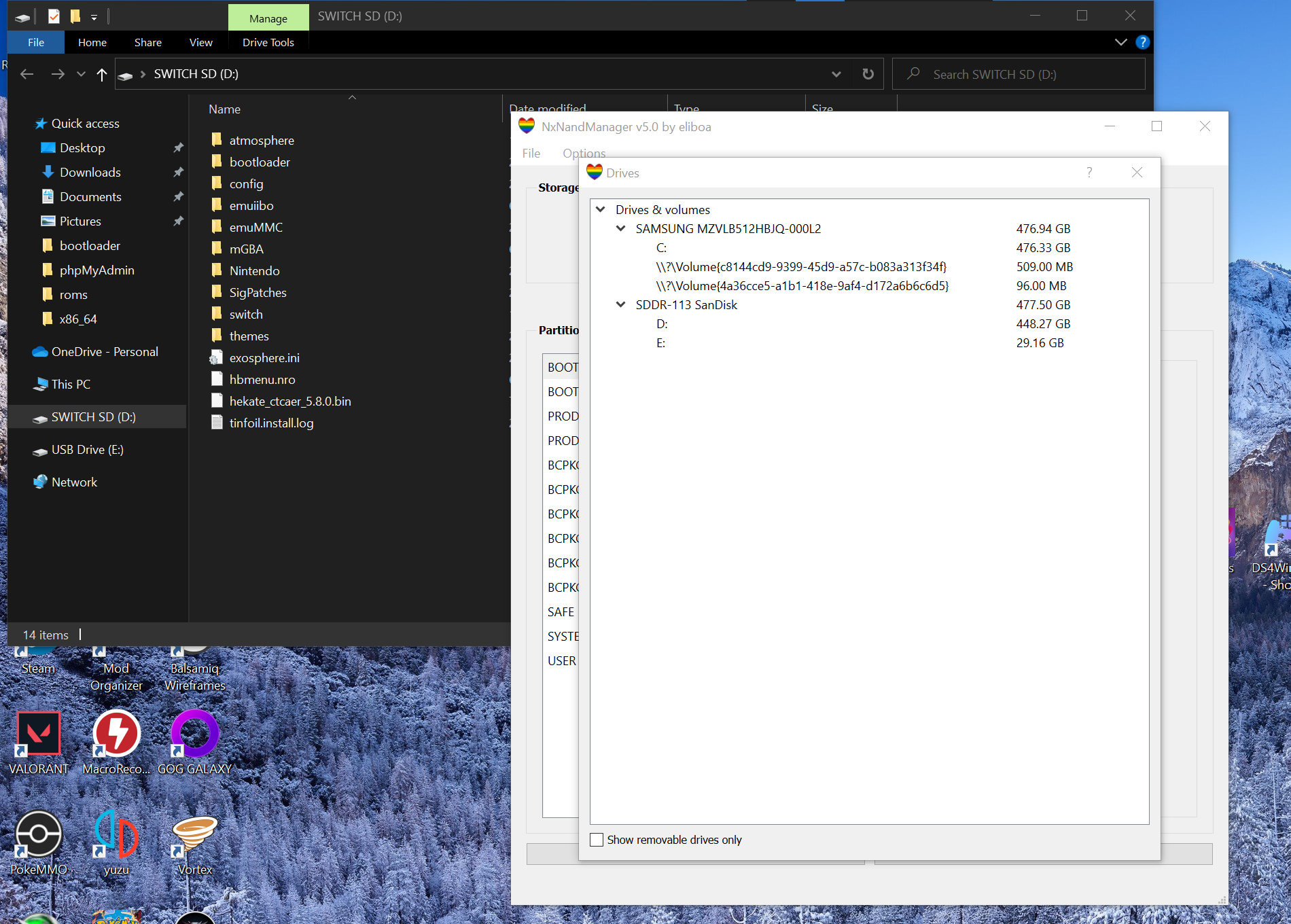

awesome, just did the fix archive bit and it said 1 unset and 0 set.
in my NXNandManager i see this:
my sd card for the switch is on my D drive. when i select my D drive it says input file/drive is not a valid NX storage. however i can select the E drive which is 29.16GB it shows me this:
That’s actually good news on both counts.
1) It corrected “something” so there’s a slight chance it fixed things for you. very slight but still. If it works we can stop everything here and you can enjoy your switch. If not…let’s keep going…
2) you have emunand data that we can back up to your PC.

i succesfully dumped my keys onto my sd card with lockpick_rcm. Just to make sure, in NXNandManager do i need to go to the options tab and click on configure keyset then select from file and then select my prod keys? after i have done this i need to select the 29.16 gb drive which is i think my emunand. After selecting this i need to create a full dump and format my sd card using rufus. after all this i need to follow a guide and at last i need to restore my backup. is this correct?
You have good instincts. All correct.
