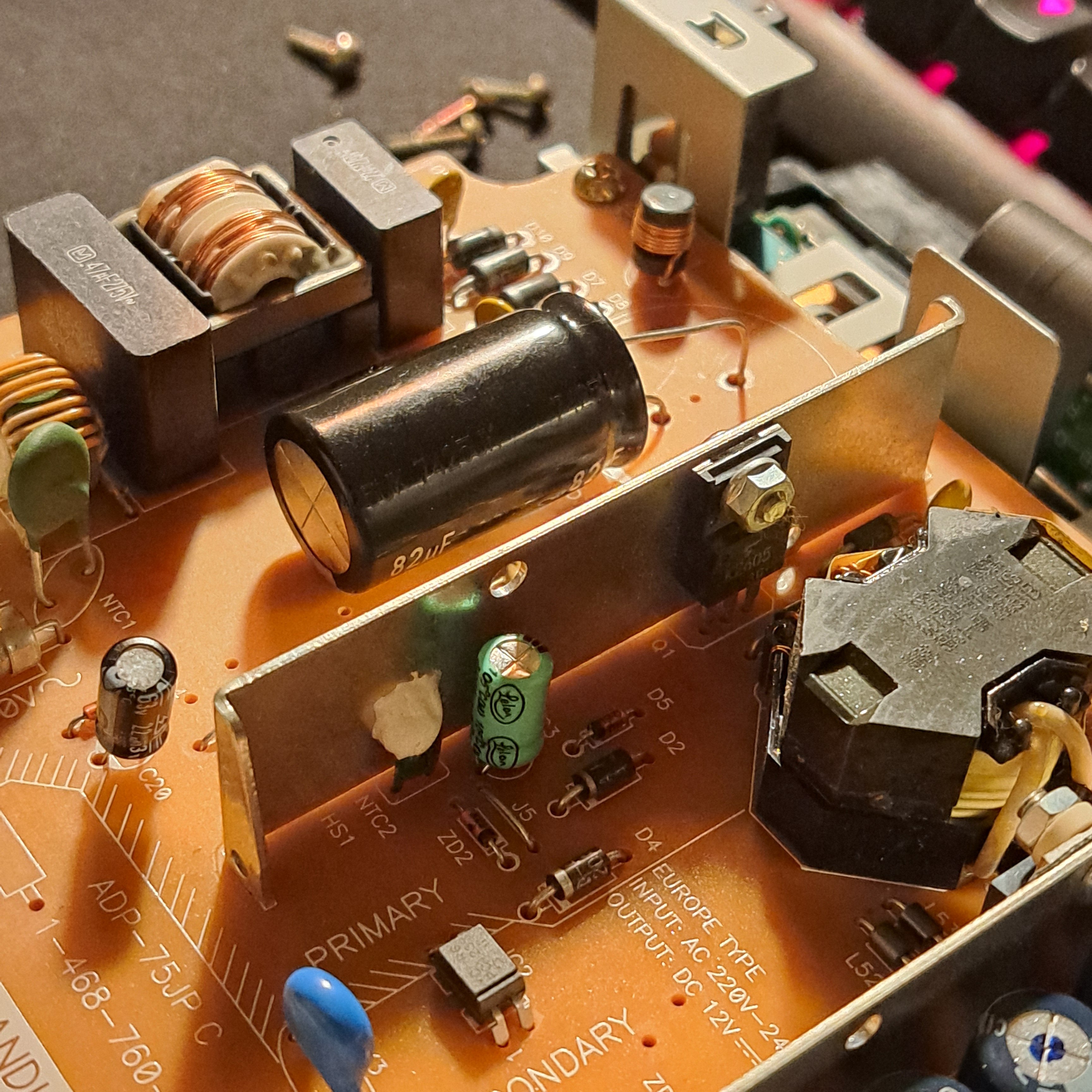

Hello,
This guide looks very helpful and I think it will help me solve my problem:
Yesterday I bought a 50004. Plugged it in to give it a test run but noticed the standby light didn't come on.
After trying some basic things and searching online what it might be, I suddenly noticed in the corner of my eye a lovely red led come on. Must have been at least a minute after plugging it in.
Played some games (ps1 & 2), a dvd movie and music cd and all work flawlessly.
Could this be a sign of a dying power supply, something else broken? It couldn't just be because it has had no power for several years, right?
I left it unplugged overnight and it did the same thing this morning.
When switching it off and after a minute on again, it turns on immediately.
So I suppose it's a capacitor (?).

Hello,
Check if the power supply is giving two 12v signals (section "B" in OP's image).
Thank you.
I checked and double checked everything.
Psu is giving exactly 12v, capacitors give a reading that is exactly correct, fuse is working (multimeter beeps).
Capacitors look really clean and no bulging, and the whole psu board is clean and no signs of something burned or broken.
It still is "slow" with building up the 12v so perhaps I'll change out the two small C20 C3 capacitors, just to be sure.

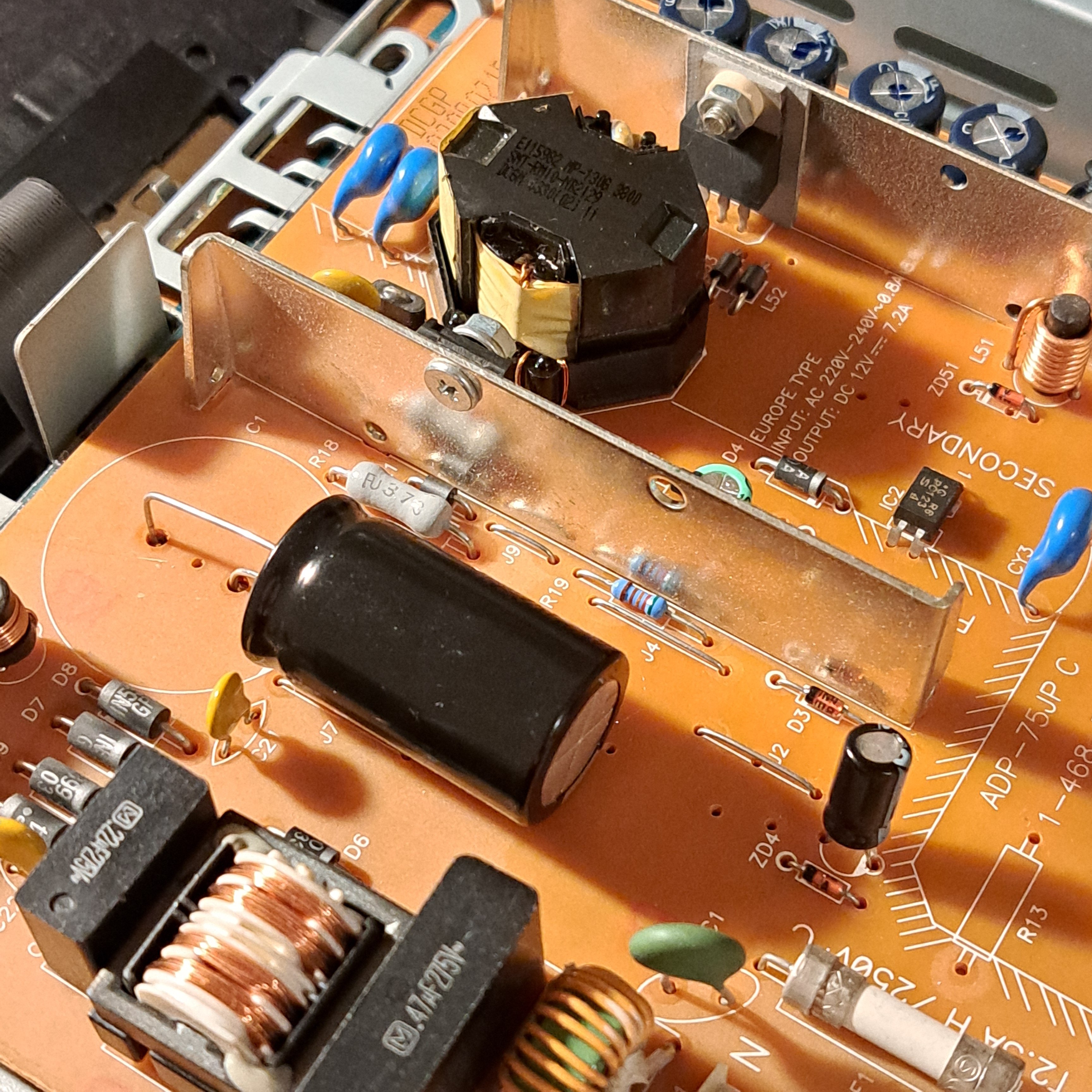

Found a replacement 82 uf 400 v for the C1 cap.
C1 apparently was the culprit on my system.
After replacing C1 and testing the standby led came on immediately.
I also replaced C3 & C20 just to be sure.
Works fine now!
