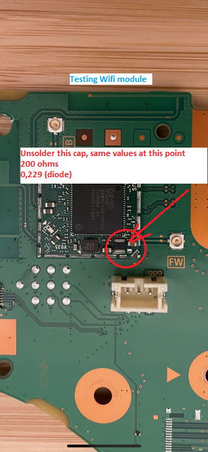

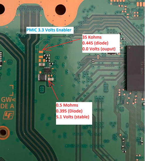

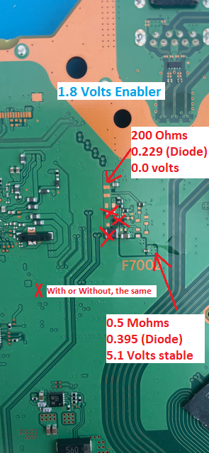

So i mesured resistance to ground for these faulty rails
3,3 volts => 35Kohms / 0.445 volts in diode mode
1,8 volts => 200 ohms / 0,228 volts drop (diode)

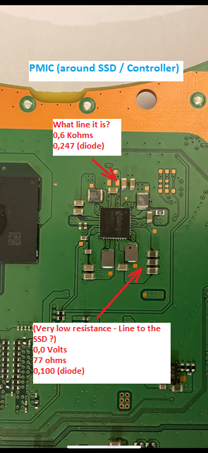

0,8 volts (D9081 output) => 77 ohms / 0,100 volts (diode)
I don't understand why 3,3 volts isn't generated, 02V PMIC is good, 5v input is present, but 3,3 volts isn't, like 1,8 volt

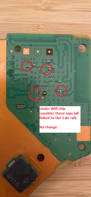

I tried to inject voltage on 1,8 volts line. I only have a 0,02A consumption at 1,8 volts, unable to warm nothing at all and finding faulty component.
I do the same on 3.3 volts line => 0 A consumption. Nothing seems to be shorted.
Any idea of what can i do next ?

I guess that the sb is not powering on, if you have 0A.
The pmic ic (RT5126/DA9065) should power the sb. Maybe the sb is bad too?
