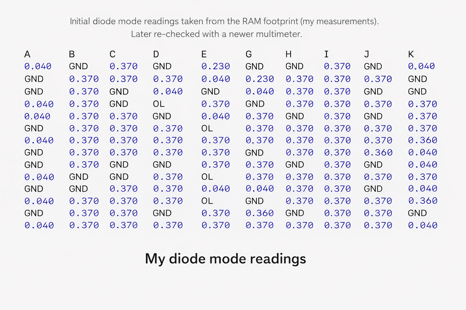

• RAM VDD/VDDQ → GND: ~23–26 Ω, equal across all banks
• Diode-mode checks show one shared RAM reference-type net with significantly lower readings, present even with the RAM chip removed. A shared RAM reference-type net (many pins on each RAM + many nearby MLCCs; “Net72” on PHAT boardviews) measures ~0.040 V in diode mode to GND across multiple points, while other nearby nets read ~0.24–0.37 V.

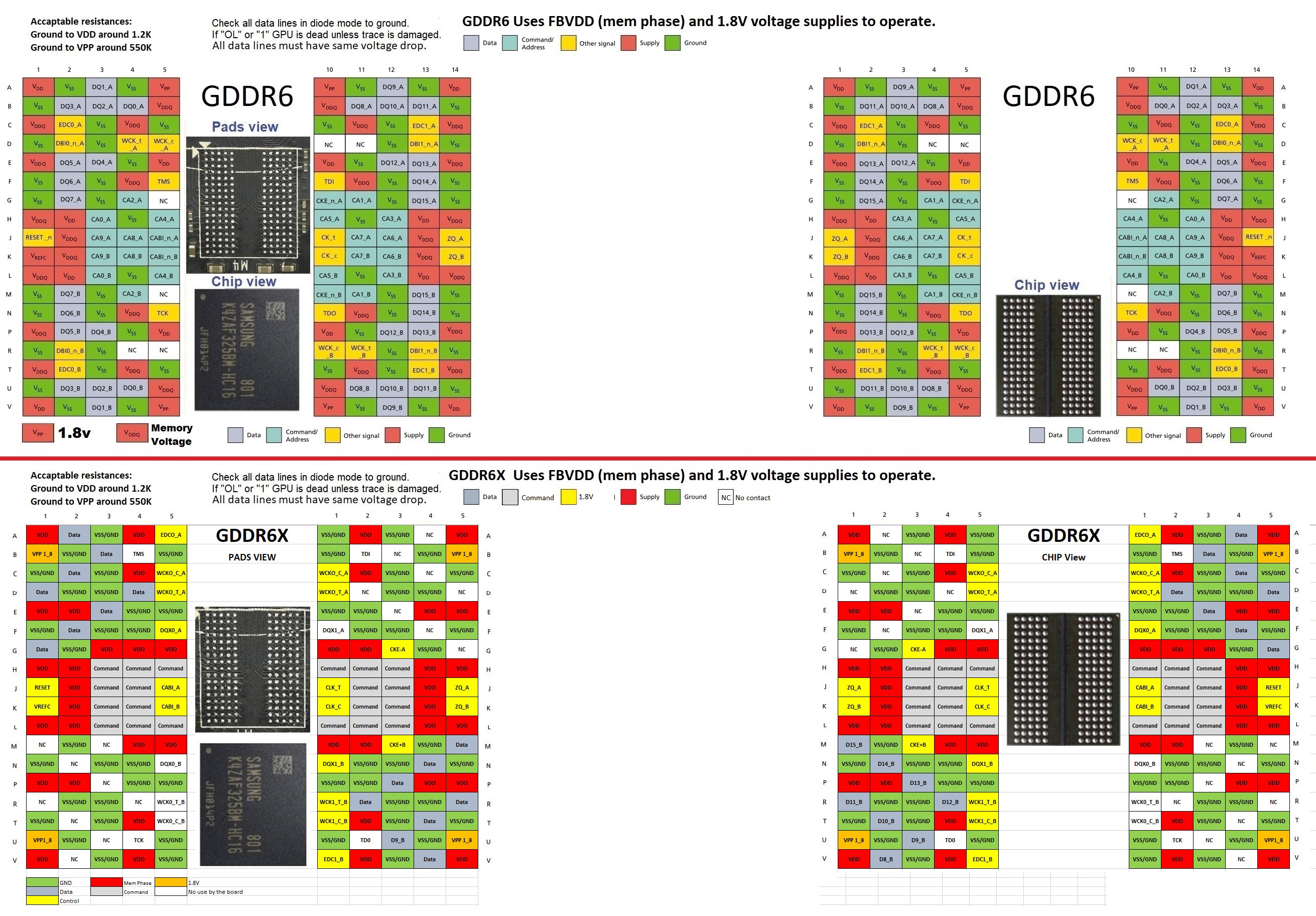

Disclaimer : I'm not an expert at repairing PS5s but out of interest I took a look at the PS5 service manual.
Each DDR6 chips has 2 pads, ZQ_A and ZQ_B which are used for the impedance calibration.
DDR impedance calibration ensures signal integrity, reduces reflections, and matches driver impedance to PCB trace impedance to compensate for voltage and temperature variations.
https://www.levirepair.eu/infusions/forum/attachments/gddr6_gddr6x_2.jpg
On the EDM-010/020 each ZQ pad is connected to a 120 ohm 1% 1/16W resistor to ground.
On your board, I think those resistors are the 2 resistors next to each ram chip.
In the datasheet of the RAM chips, it is mentioned not to leave those pins floating.
So my assumption is that either the trace is bad, the resistor is not seated properly or the resistor got damaged by the heat of the ram.

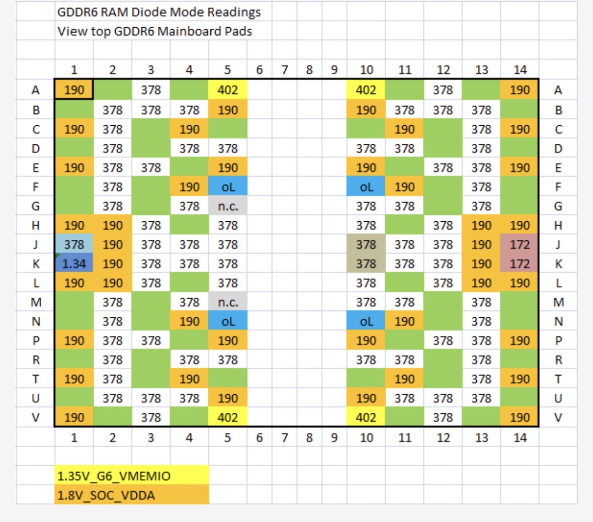

I did some reading up and it seems that the calibration is done inside the DDR6 module but it has no way of letting the APU know something is wrong.
The dram controller in PS5 APU does impedance testing on it's own and concludes that something is bad or out of the tolerated range.
Other things less likely are cracks in the traces or some issue with the vpp reference voltage which might lead the dram controller to conclude that something is wrong with the impedance.
The VPP reference voltage are pads V10, A10, V5 and A5.
They are connected together and connected with a capacitor to a voltage line.
The capacitor value is 1uF
The board you have probably has all those capacitors on the opposite side of the DDR module.
The small capacitors are all 1uf. The big ones are 4.7uF.

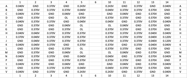

Thanks for the input, makes sense.
I checked the VPP side already: the 1 µF caps on the opposite side of the DDR are present, in continuity, and diode/resistance readings are consistent across multiple RAM banks, including the failing one. No anomaly there.
Same for ZQ_A / ZQ_B: both 120 Ω to GND, identical diode readings compared to other banks. Traces and surrounding passives also measure the same bank-to-bank.
At this point it looks less like a discrete RAM / VPP / ZQ issue and more like the APU’s own impedance training failing internally. Reworking RAM and verifying the external reference networks didn’t change behavior.
Open to ideas, but I’m starting to suspect IMC/APU rather than the memory side.

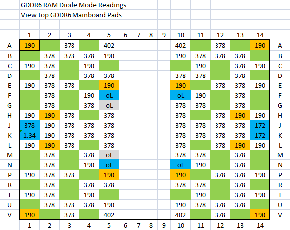

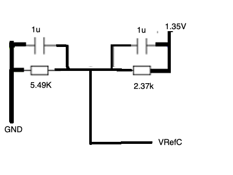

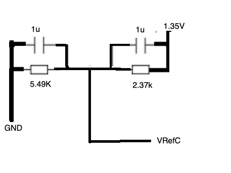

What about the K1 pad (VRefC) reading (in the RAM_pcb_reading.png)?
Compared to the other readings that seems to stand out.
It's a voltage divider to get a voltage like ~0.4v.
If I'm not mistaken, in diode mode that pad should read something like ~0.5–0.7 V
If it ain't that, then maybe something is wrong with the traces to the APU, pad under the APU or the APU itself.

Thanks — I checked that. On my board the only net matching that VRefC divider behaviour is the one I measured at ~0.361V in diode mode and ~2.18kΩ to GND, and it’s consistent across multiple RAM banks (bank 5 and a known-good bank on the same board show the same readings).
The ZQ resistors (120Ω) also measure identical across banks.
So at least from DC/diode measurements, the VRefC divider and nearby passives look normal; the fault may be elsewhere (signal integrity / under-APU / internal APU memory controller domain).
from my side I can only say that I did not find obvious shorts or abnormal readings, but without a known-good board for comparison I cannot state with certainty that everything is within spec.
What I did verify is:
  • ZQ_A / ZQ_B termination resistors measure ~120 Ω on all banks, including the affected one.
  • Diode-mode and resistance readings on the backside components (caps and resistors opposite the RAM footprint) are consistent across all RAM banks, including the one reported by UART.
  • Replacing the RAM chip and reflowing does not change the error.
At this point, it would help a lot to know what values you normally read on a known-good board, specifically:
  • Diode-mode readings on the capacitors and resistors located on the backside of the board, opposite the RAM footprint
  • Typical resistance-to-ground values for VDD/VDDQ, VPP, and reference nets in that area
That would allow me to determine whether my readings are actually normal or only “consistent but wrong”

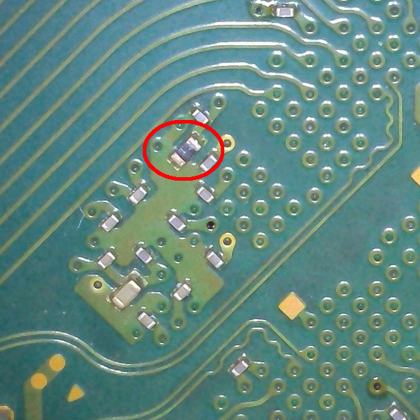

Sorry, I have no Slim boards at hand at the moment.
What is up with this capacitor?
Is it just dirt? It should look like the other ones.

Thanks for checking and for the Scribd reference. I’m already using the EDM-020 service manual as a guide.
That capacitor was already inspected under the microscope and cleaned thoroughly with IPA.
What you’re seeing in the photo is just light staining, electrically it measures the same as the corresponding caps on the other RAM banks (same diode-mode and resistance readings), so it doesn’t appear damaged or leaky.

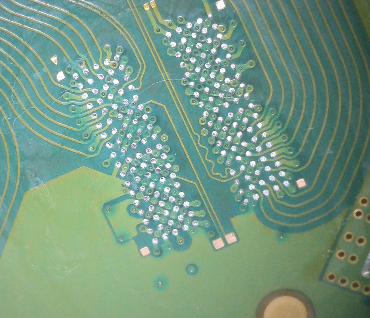

Hi Slimmy182, were you able to solve the problem?
I had one with the same UART fault, but on chip 1, and I fixed it by reballing the APU. I hope that helps.
