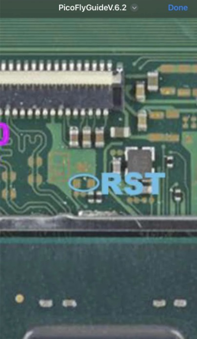

Hello, I tried installing a picofly modchip for the first time and at first everything went smooth, I managed to make it show the picofly logo, but then for some reason the console turned off and when I tried to reboot it, the modchip started flashing various errors (*=, *=*, =*).
I tried resoldering everything, and ended up ripping off the left B point pad, and a CPU capacitor (SP1).
During the resoldering phase I tried many stuff, and at first I managed to boot to OFW, but then the CPU started making an high pitch noise (probably for high temperature) so I unplugged the battery many times.
Does anybody have some advice to try to fix it?
You need to post hi-res pictures for anybody to be able to even think about helping you. We don't know exactly what you did, to include what you used for resistors and mosfets. For all we know, you put the capacitor back on backwards. The B point (at least on an OLED... haven't looked a a lite board) is one of the easiest points to deal with.
EDIT: You actually have 2 pads to choose from... you didn't rip off both, right? Don't EVER tug on a wire. You touch it with the iron until you move it with the iron... and move it off before you grab it. I learned the hard way myself. And again with reballing (practicing on a board I already messed up). I grabbed a hold of an emmc with a pair of tweezers and lifted... instead of nudging out of place first... ripped like 11 pads off of the board.

Here are the pictures.
The wire is connected to the pad at the right of the broken rst, I though that was rst too after I saw a schematic of the switch lite, I'm not sure though at this point.

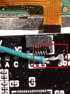

Edit: Forgot to mention, my modchip, as you can see in the pictures, shipped with an fpc kit.

Oh boy...
Don't use those flex cable, better go with 36AWG wires.
Unsolder everything, clean everything with IPA (including CPU) and see if the console boots to OFW. Send some pics after everything is removed and cleaned.
And what in the hell is this?

As for that cable, it was a desperate attempt to see if i could connect the B point somehow.

Just, no. There is no such thing as "too much thermal paste" to clean. You should clean every bit off to begin with. And you should apply a proper amount of new paste when reassembling. 99% IPA and a q-tip will easily clean most of it off. The rest, you can loosen with a soft bristle toothbrush (don't apply pressure... the IPA will do all the work, and you're just moving it around) then put a tissue on top of the board and lightly brush on top of the tissue.
Also, that wire you're trying to use for the B connection is both too big, and junk. You need a single-core wire, especially at your skill level. enameled magnet wire at .3mm would be the LARGEST I would recommend for that point. Or AWG36.

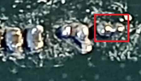

What am I looking at here? Is the CAP still there? Is it damaged? Is it bridged?
The cap is still there, though it was bridged, didn't notice it. I removed the bridge.

That cap that you bridged supposed to be a filtering one, though I'm not sure if that short circuit could have damaged something.
In the meantime:
  • verify if you don't have short to ground on +3.3V rail and if it delivers that voltage when you try to power on the console;
  • check caps around M92T36 and BQ chips for shorts, and measure each pin of these chips in diode mode (there're plenty info online with the values that it should read).
Holycow, 😩
The ripped pad on the rst point, not sure if there is any via on that pad, have to verify. If there is, then you have to connect it.
The 3V3 line check if it is bridged. Looks like it is on the photo. Test all your power line and see if nothing is shorted.
