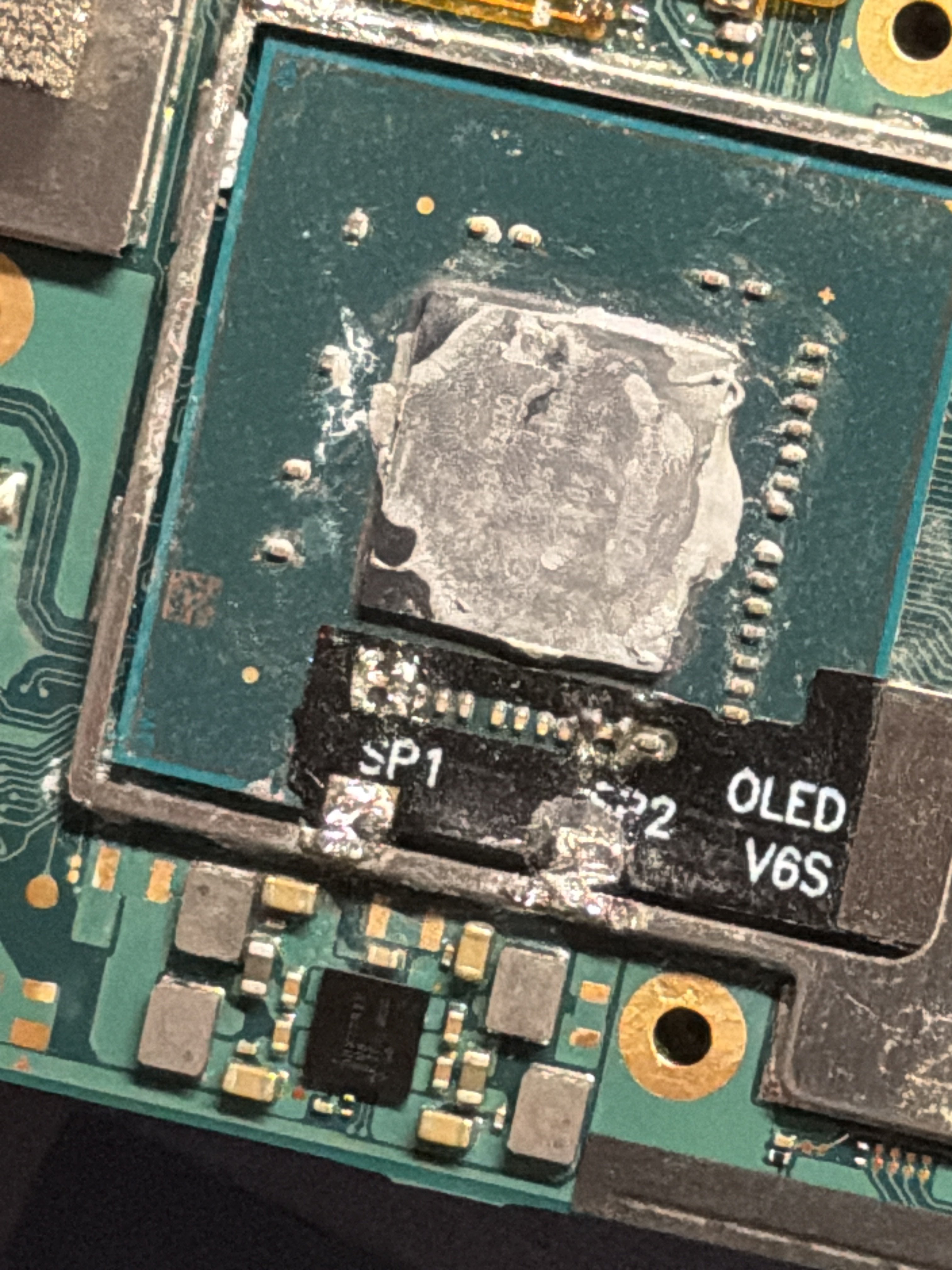

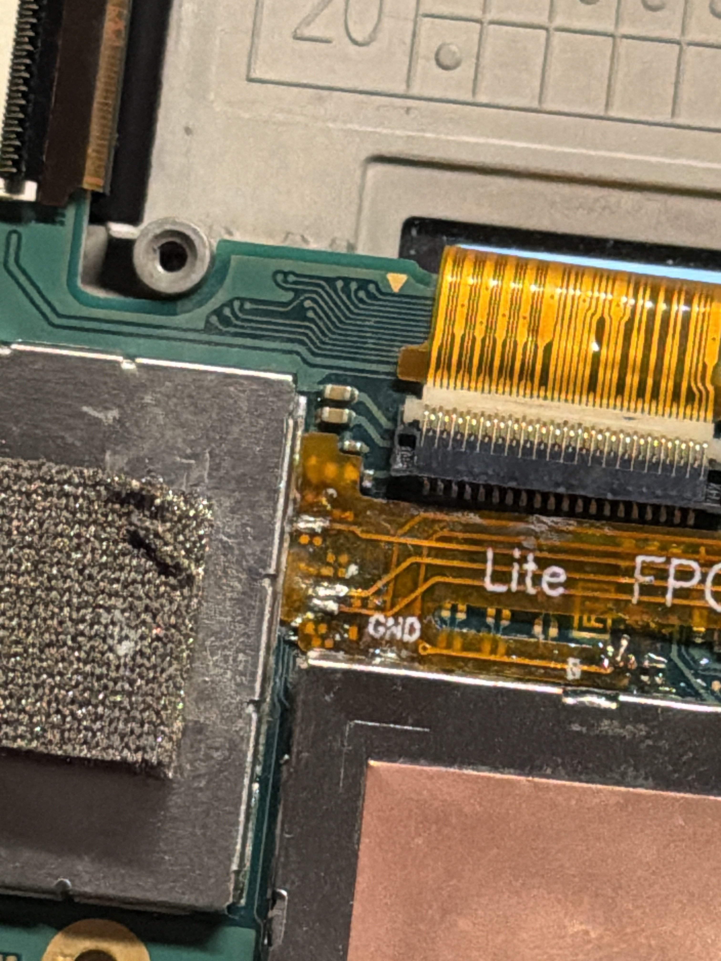

I soldered the picofly chip and got the code =* meaning DO not connnedted I was getting it booting into ofw but no matter how many times I resoldered it did the same thing. Then it started booting wihh the sound but no screen then just stopped turning on altogether including the chip. Don’t know what to do. Anyone know?

Your LCD ribbon cable probably isn't seated correctly in the connector or damaged your lcd ribbon cable.
This can cause a short that might have made things worse.

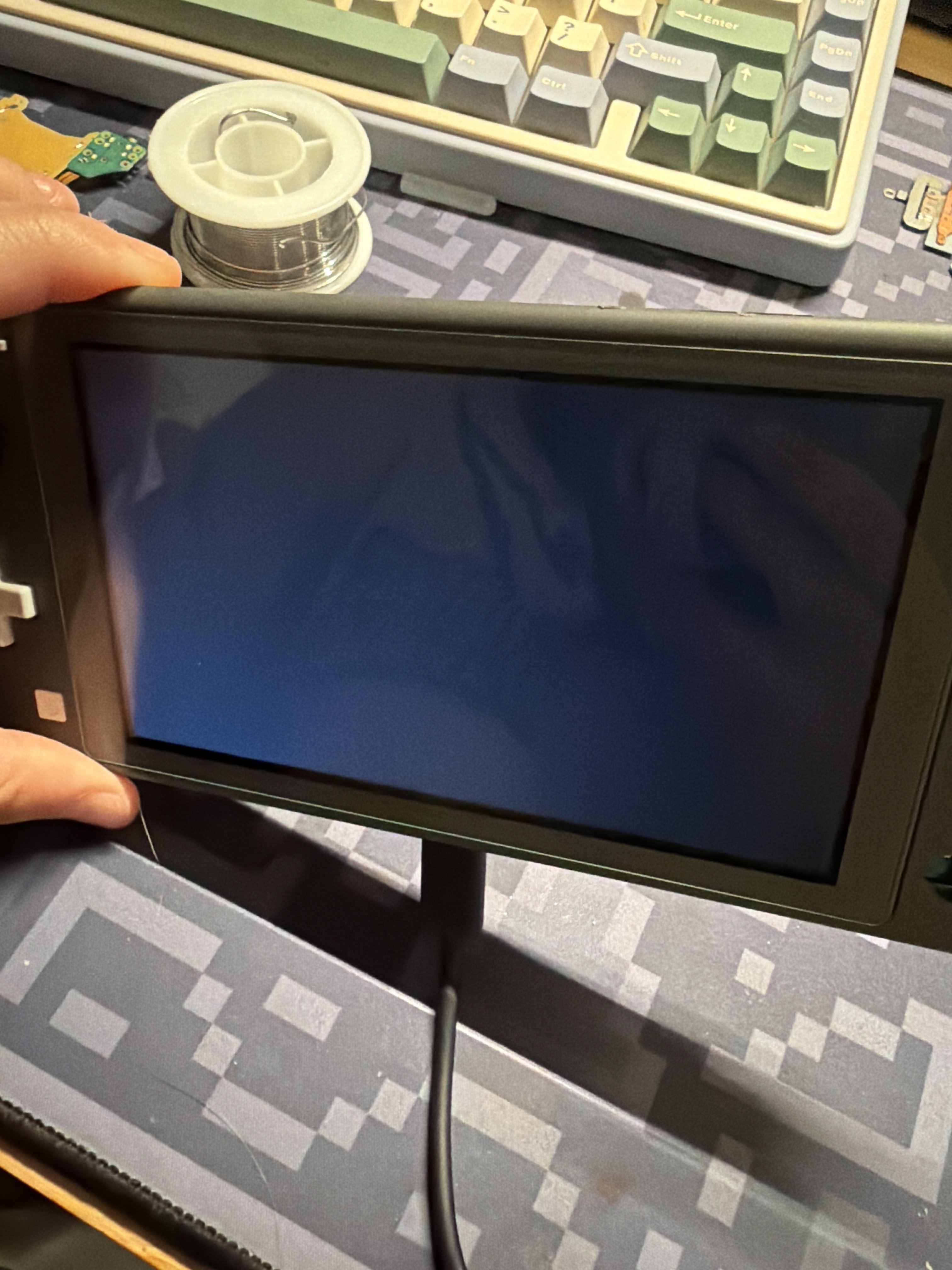

If you have a strong flashlight, shine it at the screen to see if you see something.
If that is the case, the LED driver circuit has some issue.

When I plug it in it turns on just nothing on the display but when I unplug it it turns off the chip isn’t flashing either. I shinned a flashlight at the screen and didn’t see anything. Also where’d the dat0 point on the board
