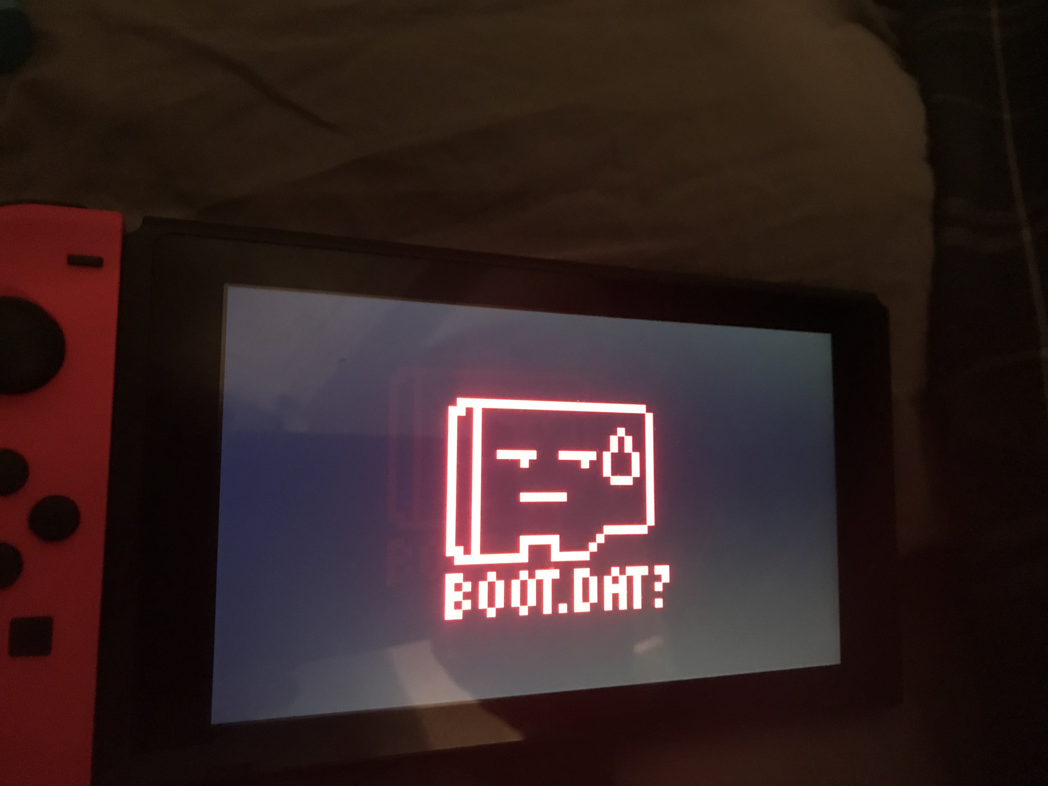

seriously there is nothing I haven’t tried formatted different sd cards the sx dongle refuses to inject the sx payload see pic I realise this happens when it can’t find boot.dat file there is nothing I haven’t tried last night I even swapped sd card readers in the switch exactly the same result ... the thing is the switch is banned and it won’t even play retail games wants the update effectively making the switch a brick ... the sx dongle works perfect on my sons switch ,,, switch is on 6.2 and yes the boot. Dat is on the root of sd card

I know this is a stupid question but you do have the boot.dat file on the micro sd, right?
Also can you boot atmosphere
If you have boot.dat on your MicroSD card, it should work. Boot your Switch up normally and go into Settings - Data Management. Does your Switch detect your microSD card?

I assume my switch recognizes card because it will format the card for me and it also recognizes if I take sd card out
Let the Switch format the SD card. Then download something from the eShop, something free. Let it install. Run the game, make sure it boots. Power the Switch off. eject the SD card. Power back on, try to run the game.
If the game does not run (tells you to insert mSD) you're good to go. Power off your Switch, extract boot.dat to the mSD. Finally, reinsert SD and eject payload.
Ignore everyone telling you that the payload injecting is at fault. If you get the Boot.dat? screen, the payload is being sent successfully. The issue here is that the Switch does not appear to be recognizing the SD card.

Let the Switch format the SD card, then hit the screenshot button a few times. Power off, put SD card into the PC. Do you see the screenshots? They will be in the Nintendo/Album folder
Ok thanks I’ll try it tonight when I get home is that two see if the sd card reader is working
If the screenshots appear on SD when you do that, we have options to get this Switch fixed. If they don't appear, format the drive as FAT32 on a computer and test again. If they still do not appear, your Switch is damaged in some way.

What I said is what I mean. Depending on what you see when you follow the steps I posted, I may have more steps you can follow that will result in this Switch being fixed. But if the screenshots do not appear on microSD even after following everything I posted, there is likely a hardware issue with your Switch that I can not fix over the Internet.
I suspect that your mSD is formatted with the wrong file system, but I can't figure that out until you get home and are ready for support.

Ok thanks tried formatting exfat via pc then switch nothing changes but I read something on here someone said format by pc with ntfs then put it in the switch and allow switch to format but never had to do this before so not sure
