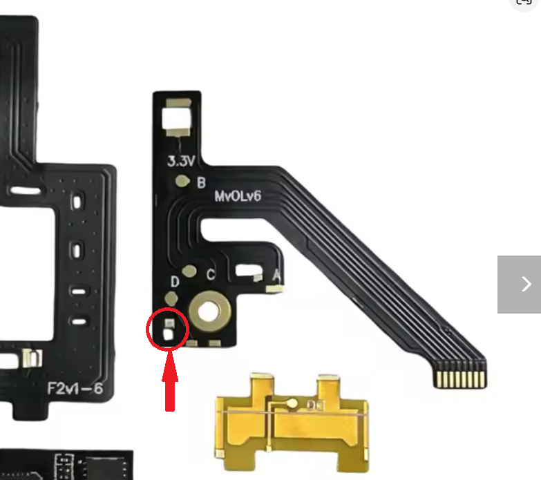

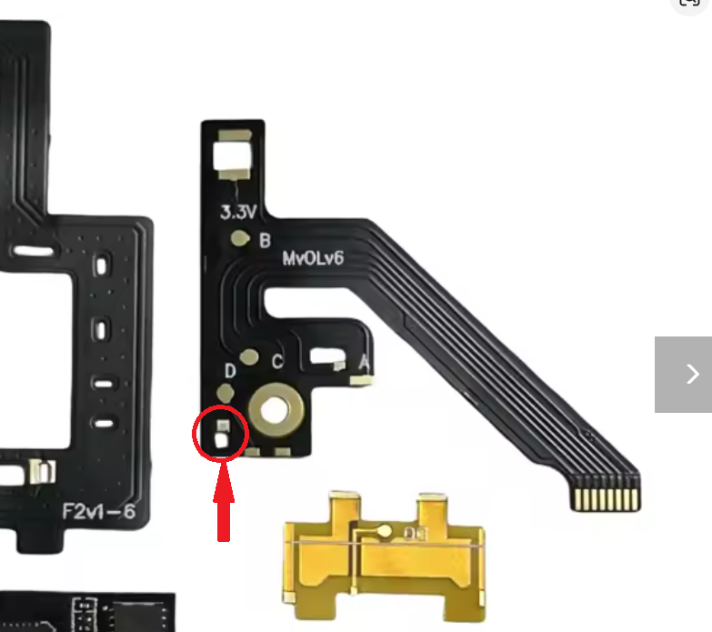

Guys I haven't posted in years in this forum, I used to post all the time.
To the point, I was installing a Hwfly Picofly chip on my brand new Oled Switch, I did everything correctly, checked all my connections, but the damn chinese flex broke (copper trace came off) in this part I will show below, anyone knows where this trace goes? Because I have no problem doing this with a wire:
Hell I would be happy to replace that entire flex cable with wires! Sadly there is not much info on these modchips, this is mine:
Thank you all!!
EDIT: If anyone has this chip, I ask you with all my heart, to measure that trace and where it goes to the end of the flex! Is not about money BUT TIME! Thank you so much.
Same cable with the exact same pad coming off is mentioned in this thread :
https://gbatemp.net/threads/will-modded-boot-without-this-connection.660106/
And as usual @jkyuho knows all the details :
https://gbatemp.net/threads/will-modded-boot-without-this-connection.660106/#post-10484012
that point is connected to ground, as long as you have other ground pad having connection.(i.e the pad under label A) you are good
Reactions: nashismo
Thank you all!!
Thats just an anchor point

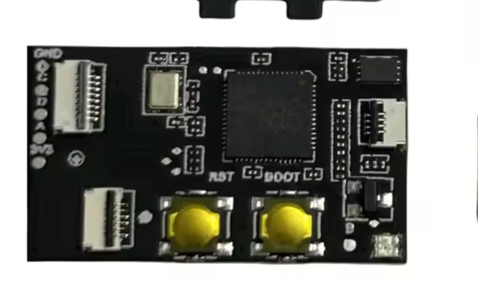

I’ve come across an issue never seen before and hoping someone can share some insight.
I’m working on a v1 unpatched and the installed modchip (rp2040 core from Ali) is showing the error * * which means RST not connected then boots to ofw. I’ve tried a new modchip- same thing. I tried running wires with a rp2040 zero - same error.
What’s really odd is I can inject a payload with the RCM loader!
Anyone seen this before? Reading way back, someone mentioned the code looks for voltage on the RST line to be 1.6-2V. I measure about 1.2V. The RST line goes to the max IC on the underside so perhaps the chip is bad?
Are you sure about the quality of the soldering at point RST? If you have changed multiple chips but the error persists, it is definitely a problem with point RST on the motherboard.
Yes positive the soldering is good. Also the core chips from Ali use the point off the eMMC connector on the motherboard and I've tried 2 different ones.
The fact that you can use an RCMLoader does imply that all your lines are working correctly.
Do you have pictures?
Maybe it is something to obvious that you have overlooked it, like using the wrong point for the RST (which will also give 1.6v diode readings in some cases).
Can you also measure that there is a good connection between the RST and the resistor on the board of the modchip?
Sometimes it is just a bad board/flex/connector.
