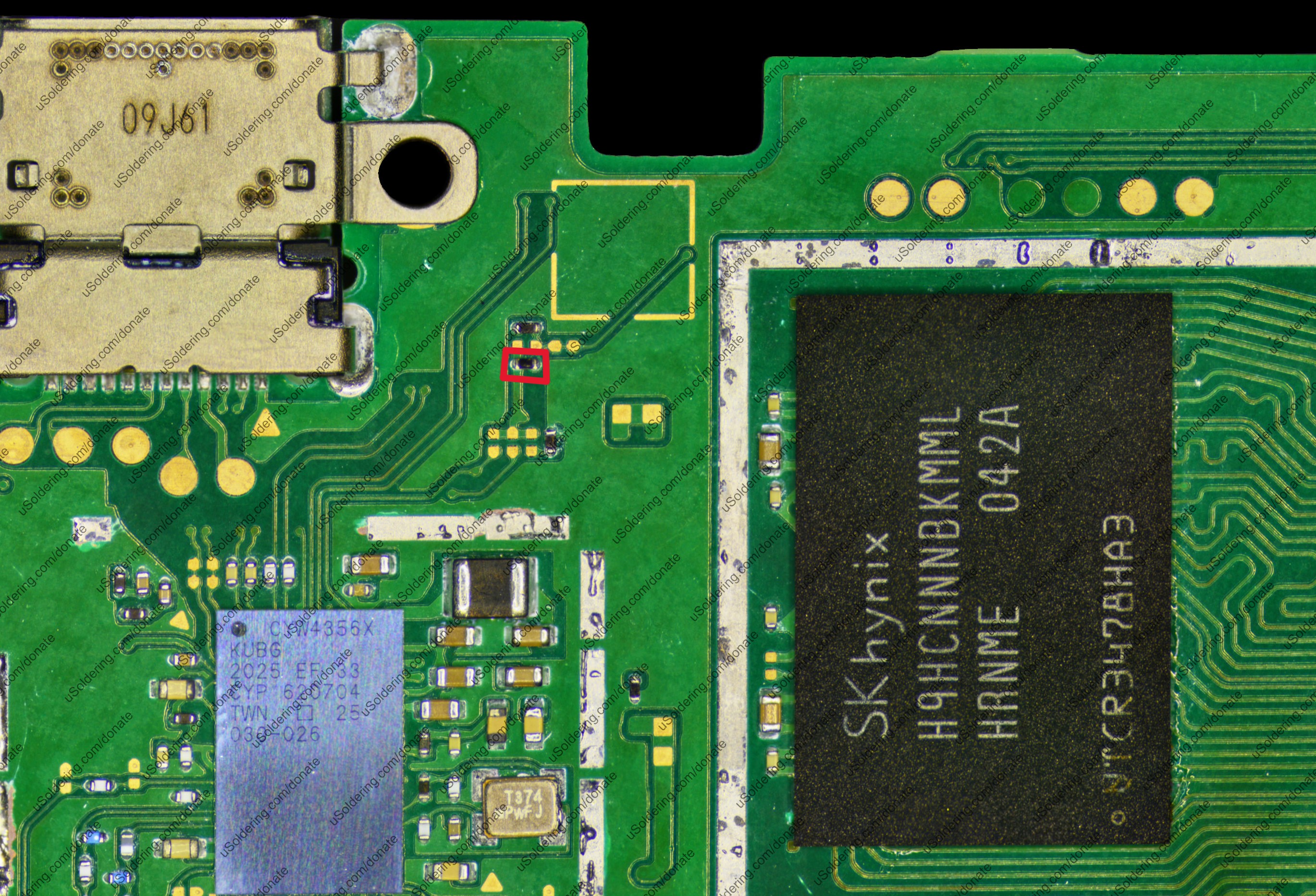

Hello, gentlemen, I need some help.
I have to replace a component marked in red on a Switch Lite but I don't know what its reference is.
I have a MARIKO donor board if it has the same component on it.
Sorry for the English, I'm using Google Translate.
