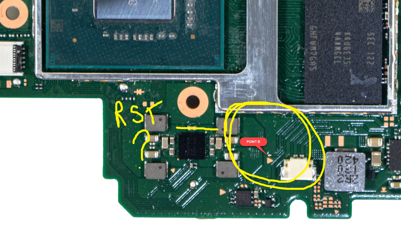

This B Point in Nintendo switch oled, can be used as an alternative RST point ?
I'm trying not to have to completely disassemble the console, since I now master the kamikaze method.
that is the alternative RST point to do the installation completely from one side only without disassembling the motherboard

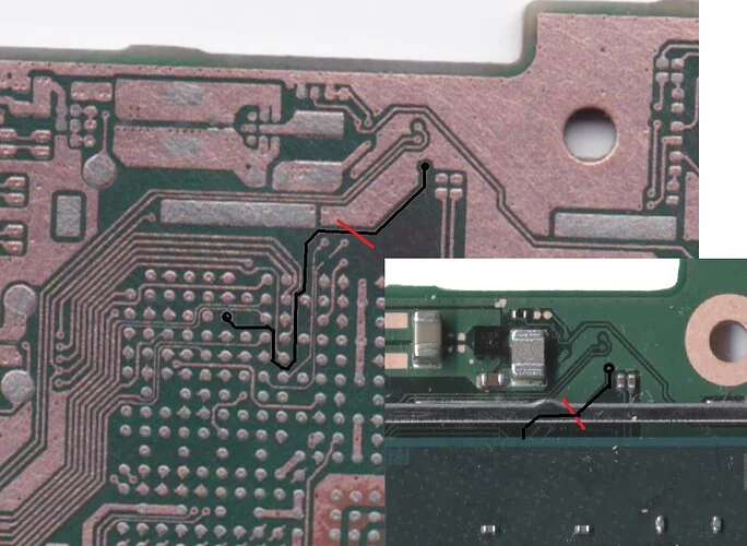

Hello, gentlemen, I ripped off the SMD when I was soldering the RST Point, when I tried to put it back I ended up damaging the track, is there any way to get around this?
Sorry for the English, I'm using Google Translate.
