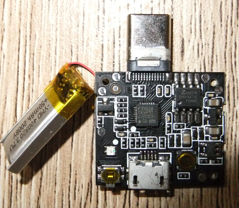

is this rcm chip can soldering in nintendo switch motherboard is it fake it is boot normal to hekate i need digram after i press power it only do blue led blinking i chose tool outo rcm enabled now only if i press in + boton in chip it is soldring ready in switch. need digram if there any info.
That is 'just' a RCMLoader , this has nothing to do with the picofly.
https://www.amazon.co.uk/Loader-Nintenton-Switch-Payloads-Injector/dp/B0C1BX75DZ
You can only do something with that if you have an unpatched original Switch.
Maybe you need a firmware update to get it working again :
https://gbatemp.net/download/rcm-loader-one-plus-firmware-v2-02.37758/
thank you so much.it is go hekate and emummc. after press + and power in console.i think it is fake.
i will change it with x86 rcm chip.
yes it is unpatched console. you meaning can soldering picofly chip?????

If it is unpatched, you don't need a picofly.
If you set up AutoRCM, you almost never need that rcm loader.
Only when you drain the battery.
But you can use a PC/Mac/Android phone as a rcm loader too.
The only advantage of the picofly is that you don't need any other device to turn on your switch.

thank you bro... 👏 it is working now with picofly. and for safe way will buy x86 chip rcm. for unpatched coz it fit super nice very small tiny.

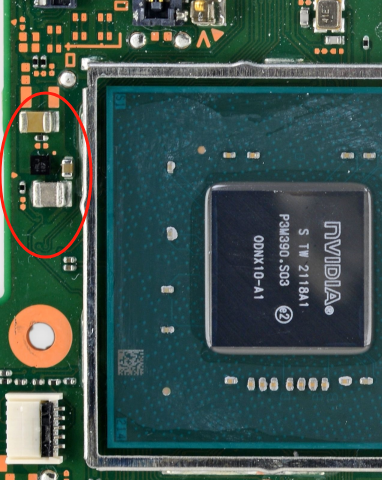

Dears, I managed to install the modchip on my oled, and it works well! (using better solder and flux was key). I've used the (rp2040 v3?) modkit with all its flex cables and adapters.
Only one issue: when i attach the left joycon, it recognizes with animation/sound and plays fine BUT doesn't charge. Joycon charges fine on another switch. I tried reinserting the ribbon cable on the left and I'm sure it's inserted well now.
Please let me know where on the board should I look to find the most probable issue (broken trace or component)? What options might I have to fix it?
check around here if you have broken the ic

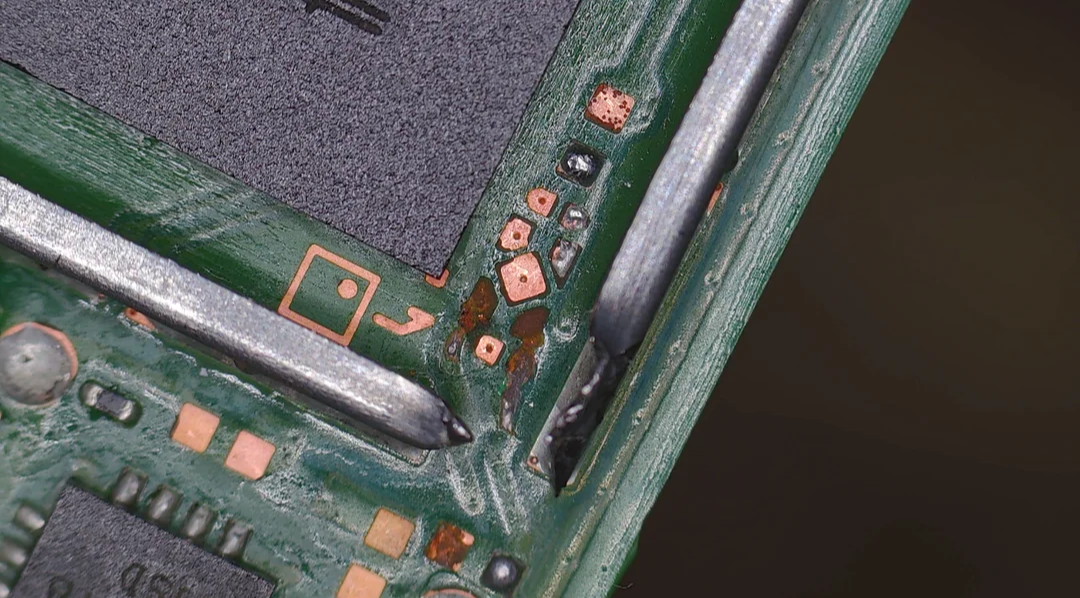

I have an OLED Switch I'm working on that seemed to have previous water damage, when I got it still was pulling 0.46 amps, but never showed a battery symbol on screen or powered up. I tested around to see if there was anything related to the IC chips but didn't find any obvious shorts, which left me clueless as of where to go. I swapped the usb port & m92 just to be sure that the charging amperage I was seeing wasn't a false positive, but alas I'm left with the same outcome. The 3v3v, & 1.8v seem okay, so it left me thinking that possibly the nand, apu or ram were blame.
While inspecting around the board I found these ripped/corroded pads near the nand. So basically my question is are they related to the nand or some other chip that is needed to start the system or show anything on screen? Any help would be greatly appreciated
I've been told to post questions related to fixing switches here & I've had people help with questions I had on here before.
in this forum, yes. In the picofly thread, no. If you have picofly problems you can post in this thread. For other problems, find a suitable thread or make your own.
Reactions: cowboy619

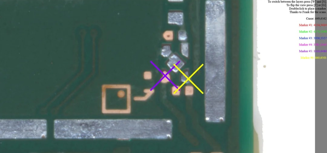

Hi-res pictures can be found here :
https://files.zzattack.org/index.php?dir=img/console/switch/oled/Layers
Nothing seems to be attached to these pads. No connections to other layers either :
