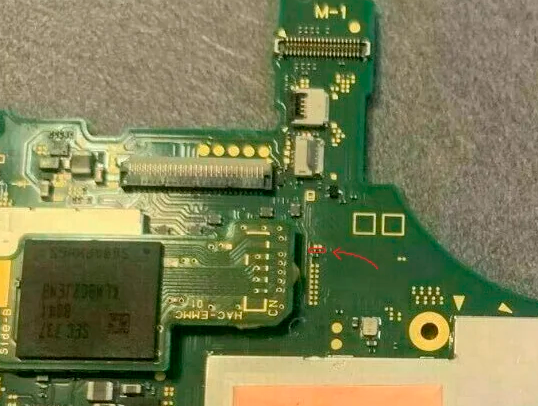

Nice work! Would you be able to add a spot for a CC0201KRX5R7BB393 to the DIN for the RGB mod, or do you already have something in place that fixes the disconnecting and pairing issues with that modification?
I do have the din line, but the decoupling cap is missing. Im not sure what the value should be but I can add it no problem. 🙂
Can you explain what the issue was? I've got one with missing the 3.3v and need some hints.
it was this that neened to be replaced
Reactions: karatefeet
it was this that neened to be replacedView attachment 484265
why this chip damge coz that happend to me what happend is my soldering tip hit the chip when i soldering 3v3 wier or transfer heat close to it to corner or hit it little bit broken some time soldring paste go under it... becarefull. i replace 2 chip one of them i damge it coz i learn how do working ask person here buy other new chip. 👏 it is good job need know what temp 1 then 2 then 3. change hot air.
Reactions: twins333

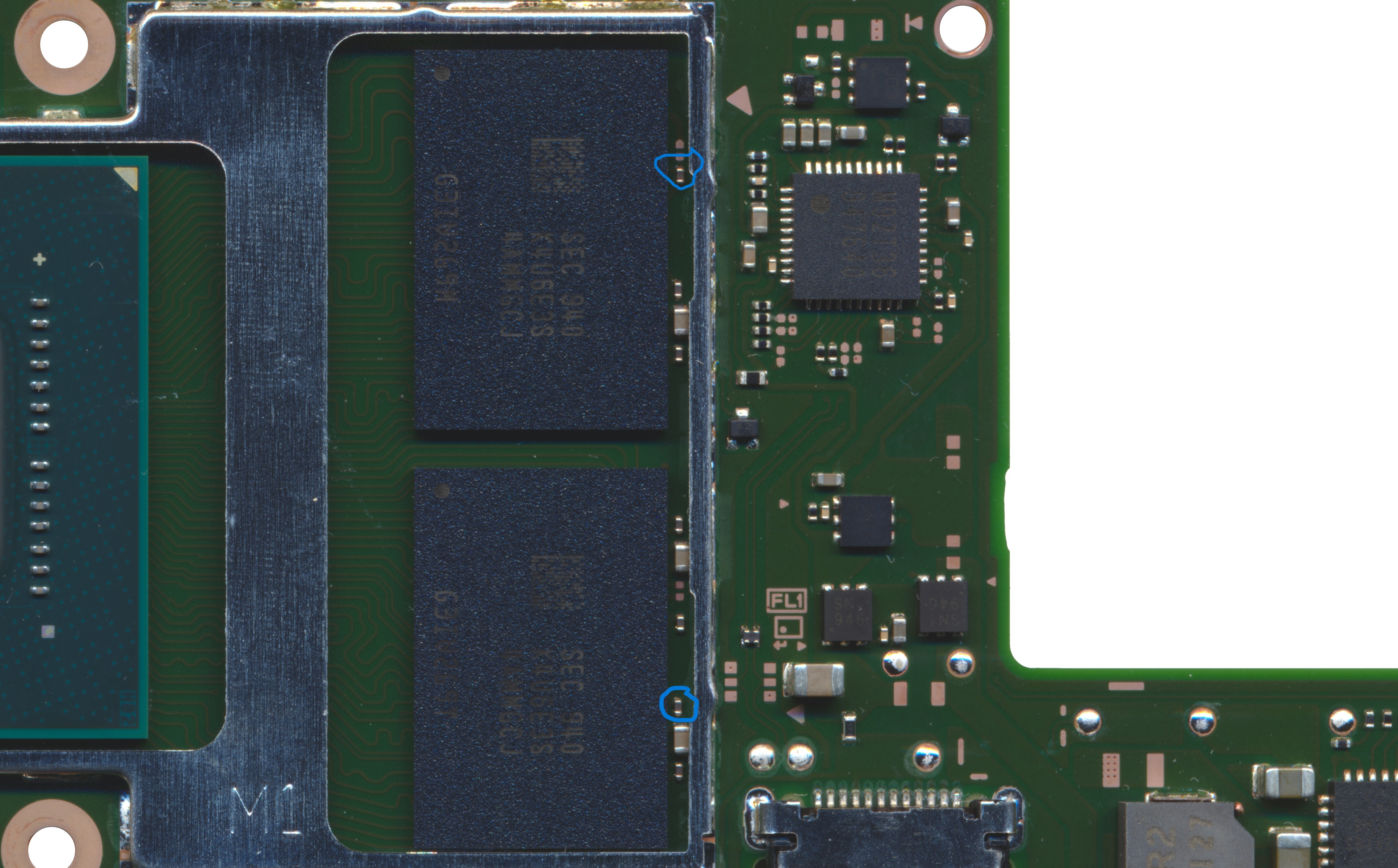

Does anyone know the value of these resistors next to the DRAM on a V2 switch?
I can't find any info on the values but they are likely capacitors for smoothing the voltage line.
Something like 100nF should be fine but maybe the Switch will work without them anyway.
Just like the caps on top of the CPU.
Reactions: Danook28
I've found one that maybe like that that maybe could work? https://www.mouser.com/ProductDetail/KYOCERA-AVX/06036C104MAZ2A?qs=9g9l2Gjnh0s/Yval7p6%2B1g==
But I accidentally knocked off those two when installing my modchip and I believe that's why I've been having issues installing hekate and my switch now blue screens when trying to boot OFW. Which is weird since I've made sure i did everything else correctly.

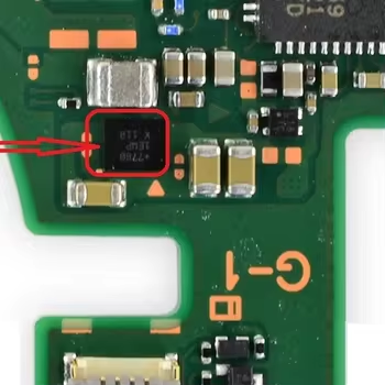

any one know what value for the resistor in joy con not Orginal there some heat spot here black transestor i think and the resistor i put alcohol it dry i feeling heat from plastic case. but it is was not working i try unblog battery conector then blog it it is working now the heat is same if i replace this resistor or transistor LTH7R v3 me be...it will stop heat here?!?
LTH7R looks to be the charger IC.
Usually charger ICs get hot if they are broken or something connected to them draw too much power.
Does your battery hold any voltage (3.9~4.2 volt)?
If your battery measures anything below 2 volt then your battery is probably dead or shorting out the LTH72R.
the resistor is hot and the LTH7R... but the resistor is dry alcohol also... it is working joycon i think bad both.
battery i think me be. thank you for info.

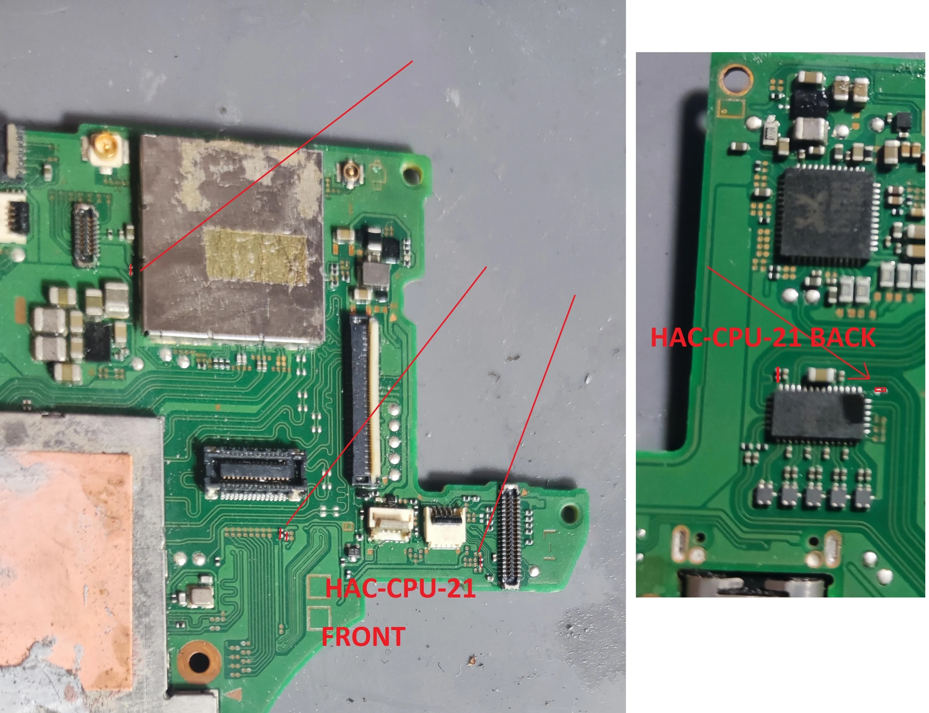

Can I use this resistor (taken from a donor board switch v1) to replace the cmd resistor on the oled switch? My order from mouser will arrive on saturday, and I would like to test if my repair worked.
If not, is there another 4k7 resistor (4.7K OHM 0201) on the switch v1 board? I have several boards that I can use as scrap.
Yes. Here are some alternatives as well.

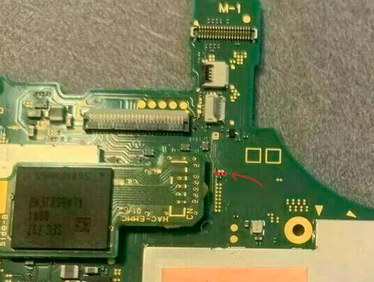

Hello everyone... does anyone know what this resistor is for? It seems I damaged this resistor because after testing it in beep mode, it only reads 0.115. My OLED is still working. However, what are the side effects if this resistor is damaged?
