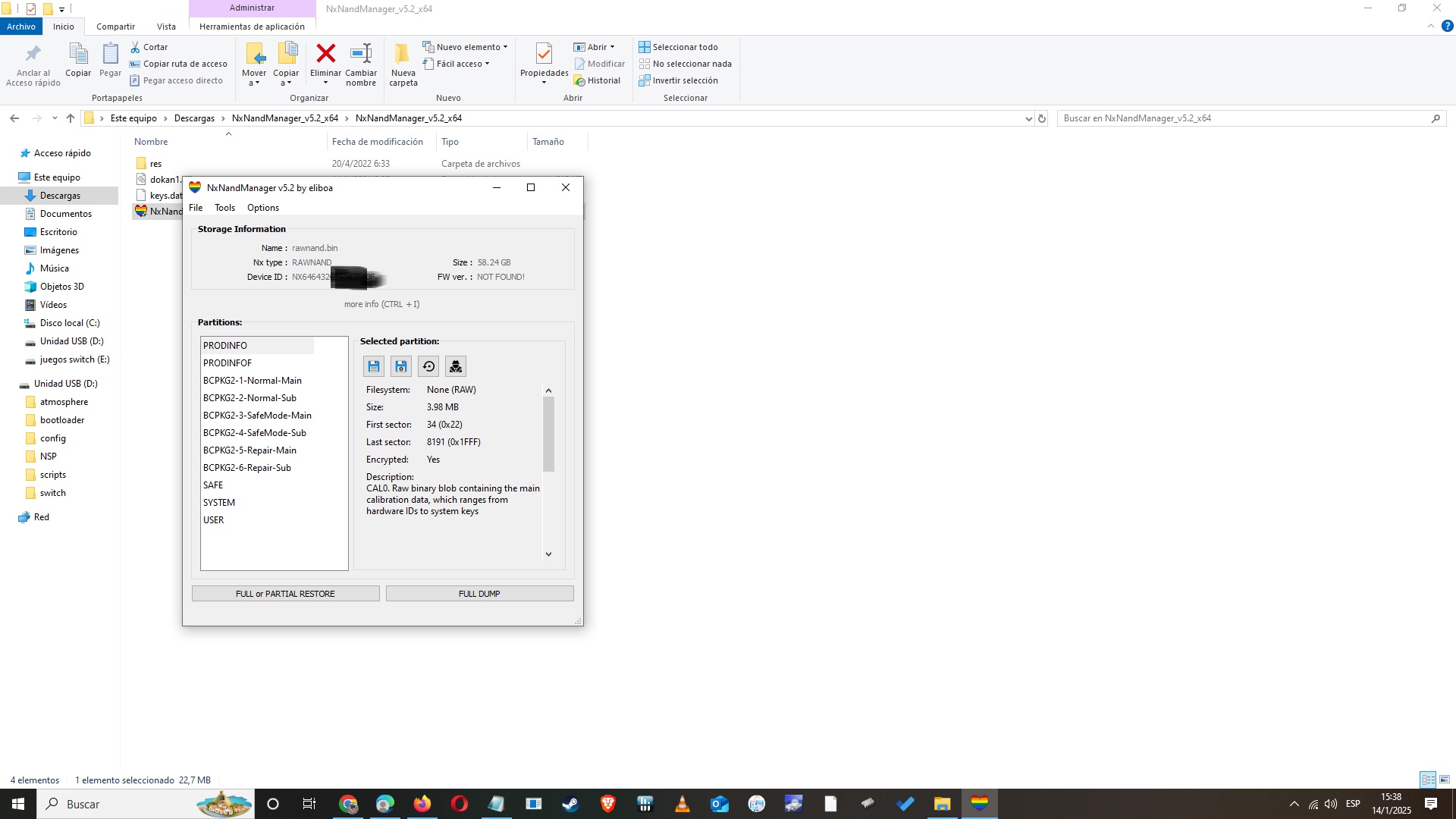

i think somethhin is worng with the nand, because it says fw version not found,
how should i proceed

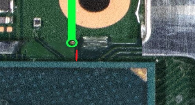

Ok, and what consequences would loading the payload have on the emmc, if it were done with the clk point cut, in the place that is marked in green, but not making contact with the cpu, because after that the console stopped working

If its really cut then theres will be no white light, since the sync failed. The clock are the basis of sync in digital world. Without it there will be no digital works. In simple words, picofly cannot communicate with the dat0 at all. You'll get different error. The evidence you see the white light means picofly could read, confirm, then write the payload. And if the glitch works its another evidence that the picofly can communicate with the emmc, since it needs to sniff the dat0 to check whether the glitch works or not. I guess you have another error not on clock. Maybe some component failed. Usually about power component.

It is not like that, in more than one console it has happened to me that I have placed the chip with the clk cut off and the white light does appear, my assumption is that it corrupts the nand, I am going to see if I fix it using the sthetix level unbrick method 2

If the white appear, then the clk definitely not cut off. Its certainty.
Its the synchronization beat in digital world.
To communicate (sending/receive 1 or 0) to the emmc you need to be synchronize.

I can assure you that if you cut the clk track and connect the chip on the opposite side of the cpu, the white light appears and the console is useless, only the hekate works, I'm going to try with a donated nand to see if I fix it

If you clk trace between emmc and the cpu got cut, not even the cpu could read your emmc, there will be nothing shown, hekate wont run, since the cpu couldn't read the emmc, hence the payload to boot the hekate. There will be only black screen.
If you think I'm wrong you can try it on an OLED and you will see that it is like that, and then the console will not work, as I said it has happened to me more than once and I have installed more than 1000 chips
I may not have installed 1,000 modchips, but I can confidently assure you that if the CLK signal is interrupted or the trace is cut, the screen will remain black—modchips or no modchips. I've repaired around five consoles with cut CLK tracks (tracing under the eMMC), and in every single case, the result was a black screen. Even without those repair experiences, anyone familiar with the function of the CLK signal would understand this fundamental point. The fact is, your CLK trace was simply not cut

i think you did not understand, only firs time was cut, pico show with light, then i fixed the clk track, but console does not work, only hekate
This could be a corrupted NAND issue for various reasons. Rebuild your NAND to confirm, and then test it. If the issue persists, there may be another hardware problem with the console.
If you cut it the first time, it will be black screen and no white light.
The picofly couldn't communicate with the emmc since theres no clk signal, hence no white light.
And the cpu couldn't even run any code since it cannot fetch the code from the emmc, hence black screen.
If its really the data corruption it might occured from various reason, but almost certainly its not because the clk trace got totally cut off.
Since hekate working, you might try install ubuntu (switchroot) just to make sure theres no hardware failure.
Get an old unpatched V1.
Or start practicing with a soldering iron and rework station.
This is how most of us got started.
For $30 you can get a brand new Chinese knock-off rework station with soldering iron.

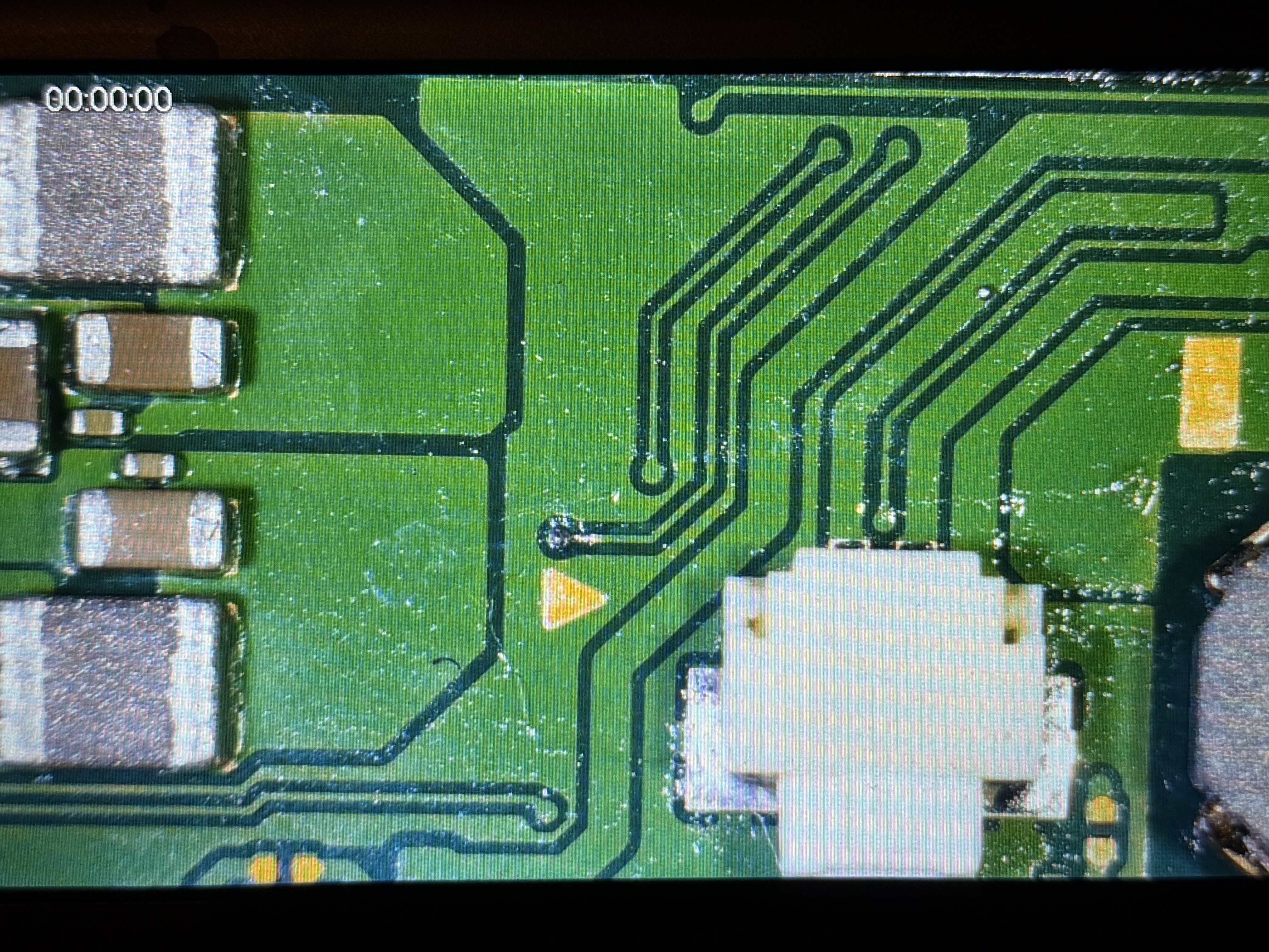

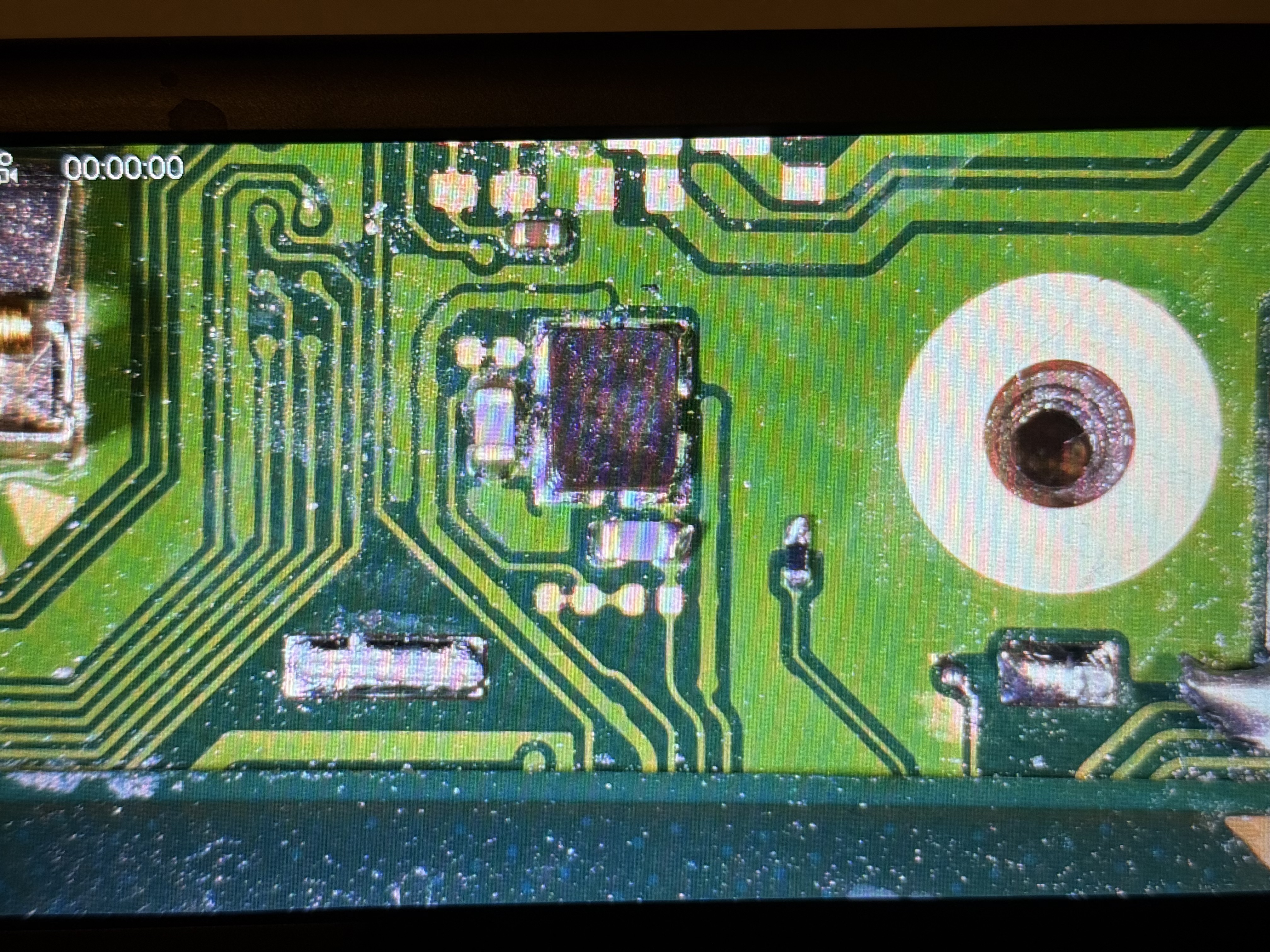

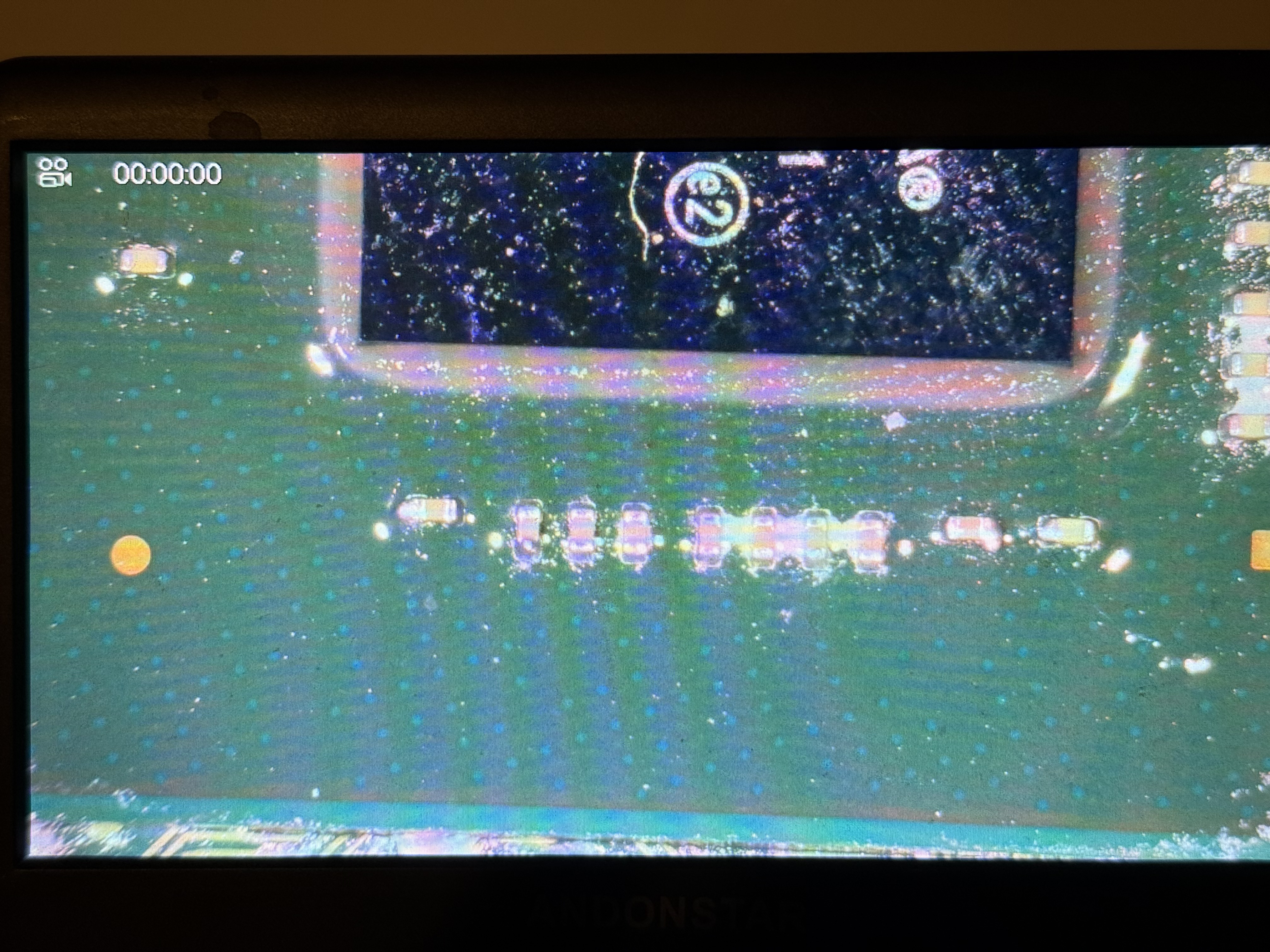

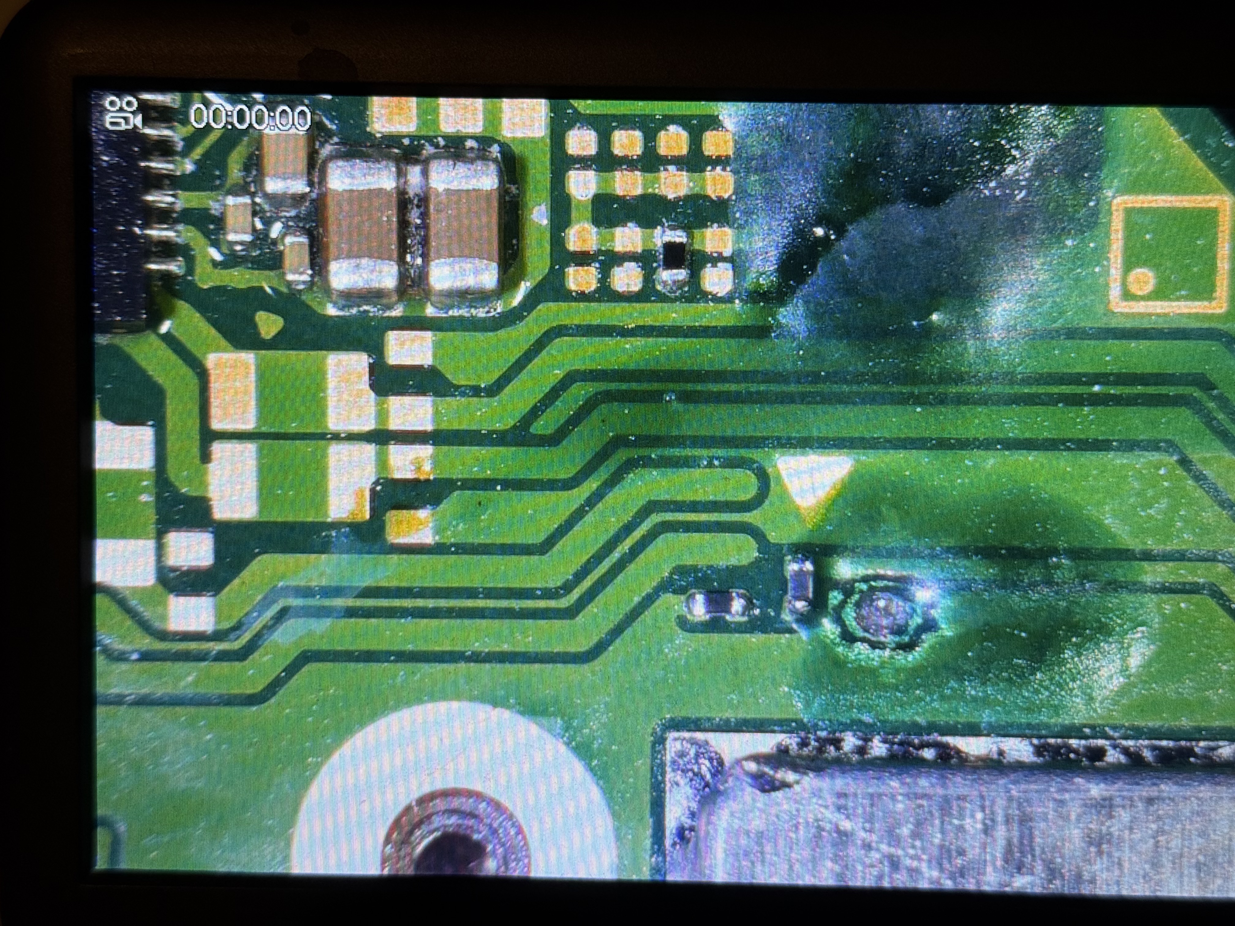

I’ve done this mod so many times that it muscle memory at this point 😭 I’ve genuinely looked around the board to see if i could see any chip cracks or any caps shorted and nothing, the console is stuck at 0.4 amps and does not power on. When everything was set and done i turned it on and nothing happened the chip didn't light up. I looked around the areas where i couldve ruined a trace and couldnt find anything. Any tips on what i should try next? Thank you!
