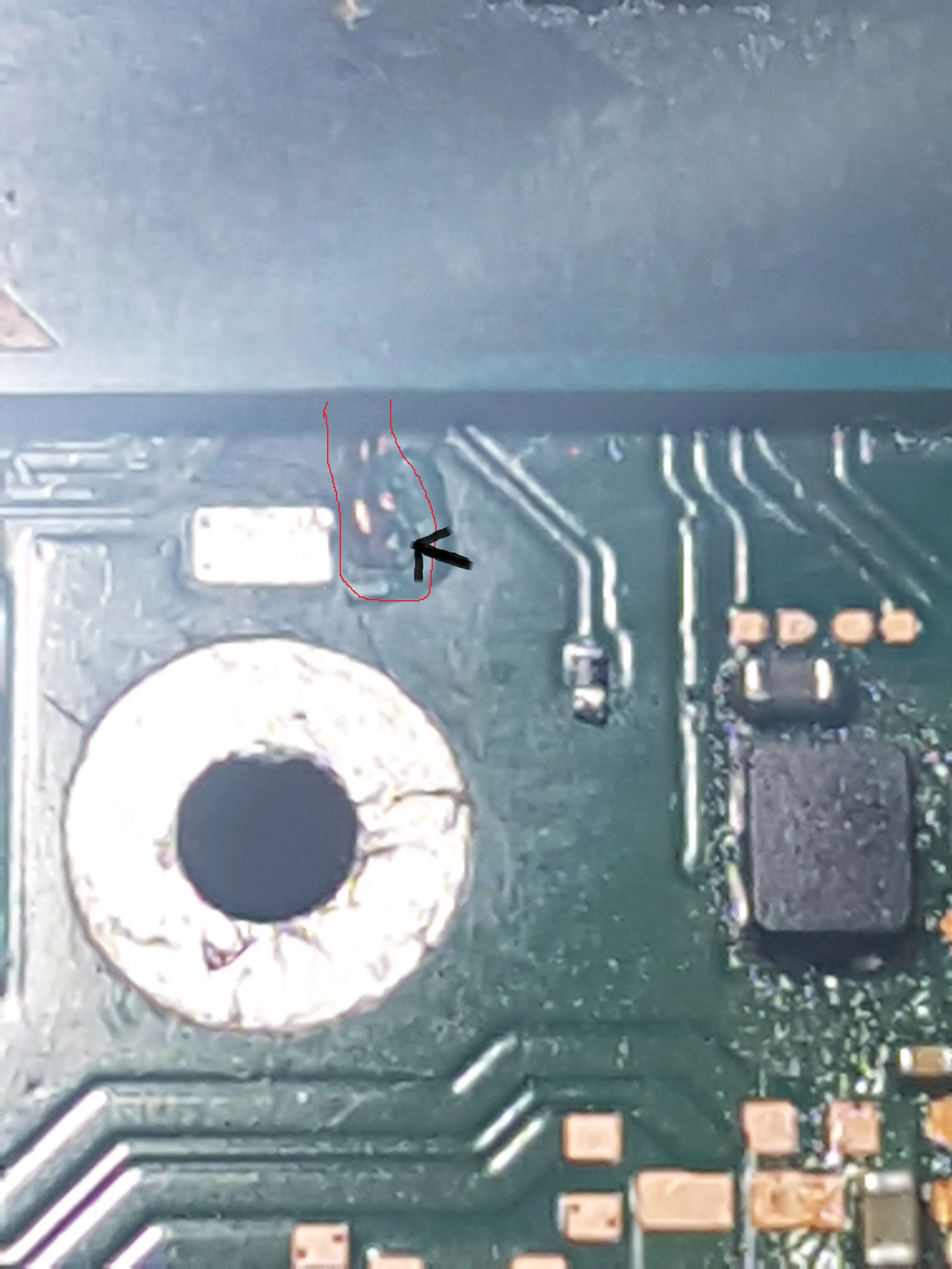

The clk track was broken on an OLED switch and when I inserted the chip after the first white light, the console no longer turned on in original mode. is there a solution???
when i started the console picofly was solder here, and now console only boots hekate

HELP PLEASE!!!!!
add clean pic i well help you.

The green part is where the chip was soldered, the red part means there was no track. When I turn on the console with the chip, after the first white light (I think it injects some code), only blue light from the chip. Now I repaired the clk track but the console does not turn on either original or cfw, only hekate
are you read point before do all this
soldering?????
you now want to boot ofw there are clk point under emmc chip you must soldering it to the clk point it self if it damge much coz the first pic is not clear the next pic is it before damge clk!!
it is risky clk must not ground or will dmge cpu and mod chip so bad... 👏
soldering?????
you dont understand, clk trace is restored now, but the console does not work, because the chip injected code when the clk point was cut. I put the console only runs hekate, so clk point now is good
i understand dont worry. are you fix the console now?
no, only hekate works. i think its because picofly injected code with the clk point cut the first time i test it
can you read sp1 sp2 point from cpu and back motherboard. also there are dat0 point if it cut make black secreen. also you can read capacitor near charge chip you can know if cpu dead or no.
read all point add value here. 👏

it is not a hardware issue, like i said the error existe for the test the chip the first time with the clk cut, i think there is something corrupted
when you chose cfw sysnand or stock or emummc what happend. can you backup nand or go to nx nand manger on pc???? prod kyes see is there emmc info in hekate or sd info or ram info???

It's trying to glitch the console. Doing so if the clk trace is broken should not do anything. Didn't think this was asked before, but what kind of chip are you using? It's been known that some hwfly style chips can corrupt the emmc.
rp 2040 tiny, the same one I have used hundreds of times, the chip glitches when the blue light is on, but when it turns on the first white light it is doing something else, I think it modifies something somewhere with code...
