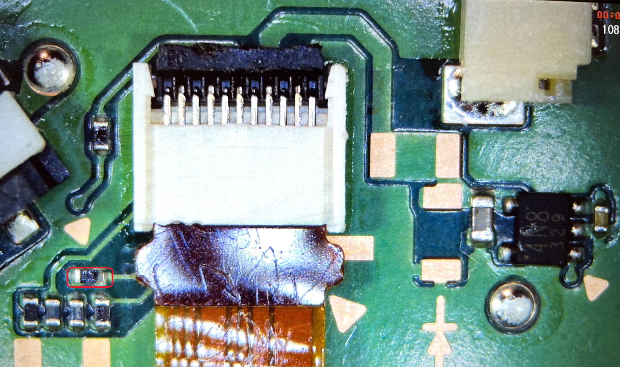

A quick update on my problem of the left joy con not being recognized after a Picofly installation anymore:
I measured all the resistors of the left joy con IC shown in the quote above, the values match with what sthetix gives as correct resistance values as shown here (https://github.com/sthetix/DIAGRAM/blob/main/OLED-JOYCON-ERROR.jpg)
if your right side joycon working fine, just left side cant be detect when attached, check this resistor if it still in 100~200 ohm range.View attachment 476455

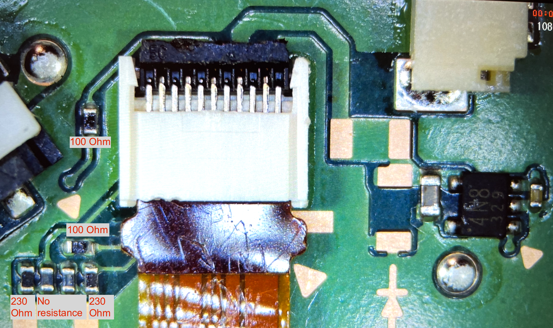

The resistor you mentioned has 100 ohm. I measured all of the resistors in the area, readings are as follows.
The only thing that looks out of place to me are the two resistors in the middle showing continuity without resistance at all. Maybe I got the readings wrong or it is supposed to be like this. In any case, I will try to check the continuity of the rail next.
EDIT: I checked the continuity of the pins from the rail to the connector and I did not find any continuity issues. I am all out of ideas at the moment..
I'd be really glad if anyone had more debugging ideas.
I have to correct myself, you were probably right. After searching for the problem and retesting everything I now think that this resistor is the problem. When measuring its resistance it mostly shows 100 kOhm and only sometimes 100 Ohm. I thought that maybe some more solder on the right side of the resistor may be the solution, but it did not really help, so I guess I will have to replace it.
Do you know which size this resistor is and where I can get it? I do have a schematic whilch says it should be at 100 Ohm, but I do not know its size. I also accidentally soldered together some of the SMD components right below of it (I'm not used to soldering things this small...), so I will probably have to fix that as well.

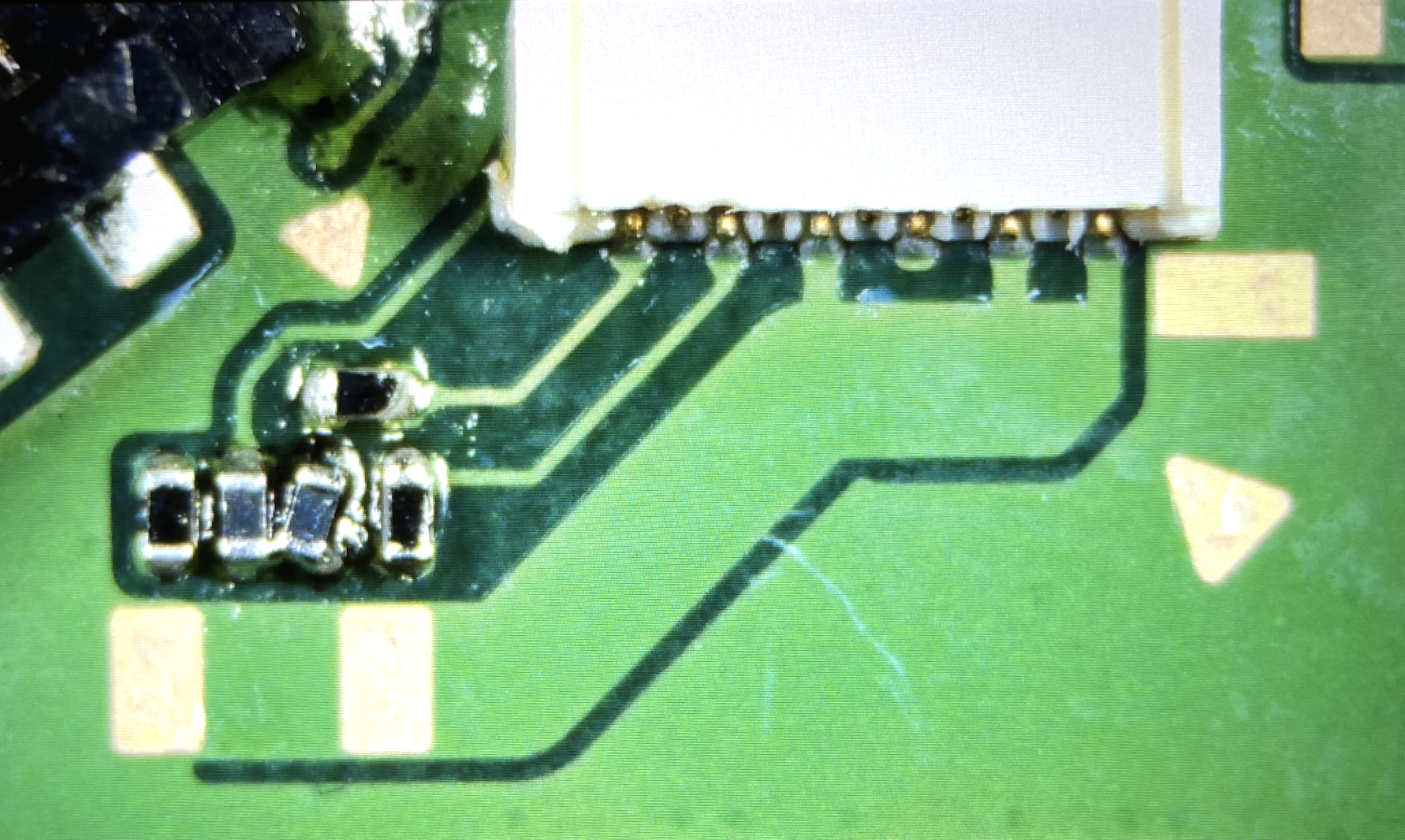

At the moment it (sadly) looks like this:
I know it looks pretty rough. Would you recommed a hot air station or do you think it's doable with a soldering iron?
Thank you so much for the help again!
Update 1/25: I managed to replace the broken components and also the resistor that didn't work in the first place (the one in the top), now everything works again!
with nice soldering tip and very good flux you can do it easy reflow the resistor to move in place but microscope is need.
Reactions: dibas
I ordered a new set of 0201 100 Ohm resistors now, I guess that should be the correct one.
I still have no clue on how I am going to remove the existing resistor with an iron though. I have a few good tips, but no hot air station, and with just a single tip I don't see the solder melting on both sides of the resistor. I also am not sure how to fix the mess with the components below. I tried it with flux and a soldering iron, but the resistor would not move.

You must have microscope tweezers and the melting point must be sufficient to allow the solder to move under the component you want to repair... with soldering skill.. only
If you tip the left and right side repetitively, they will come loose after a while.
Consider also replacing the one on the right to get better access to the one that has rotated.
