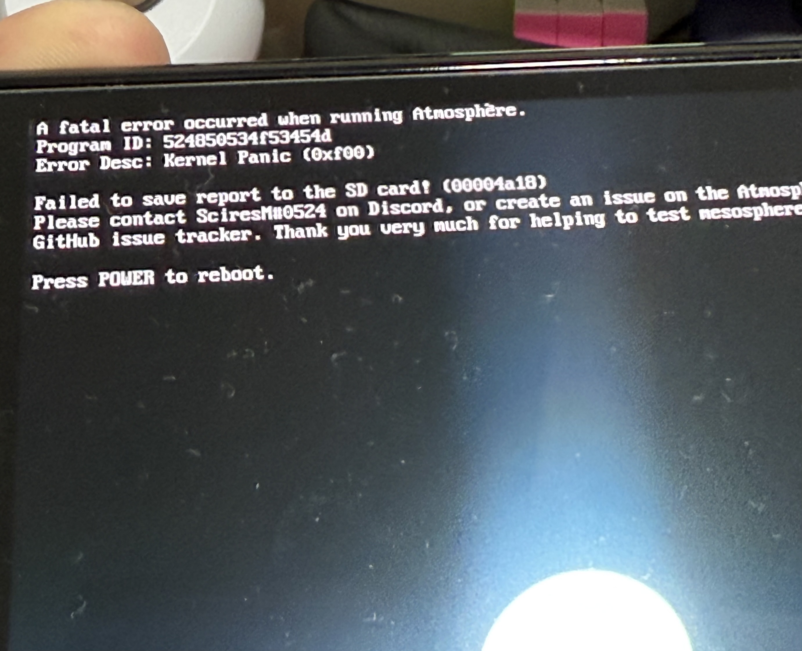

does any one has this issues ?
i booted successfuly into hekate 5 fist times
i tried to boot hos with 2.61.uf2
backed emmc, created emunand then when after inject hekate 6 bringme up to this issue
i trieed to clean the picofly with flash_nuke.uf2 but not luck at all

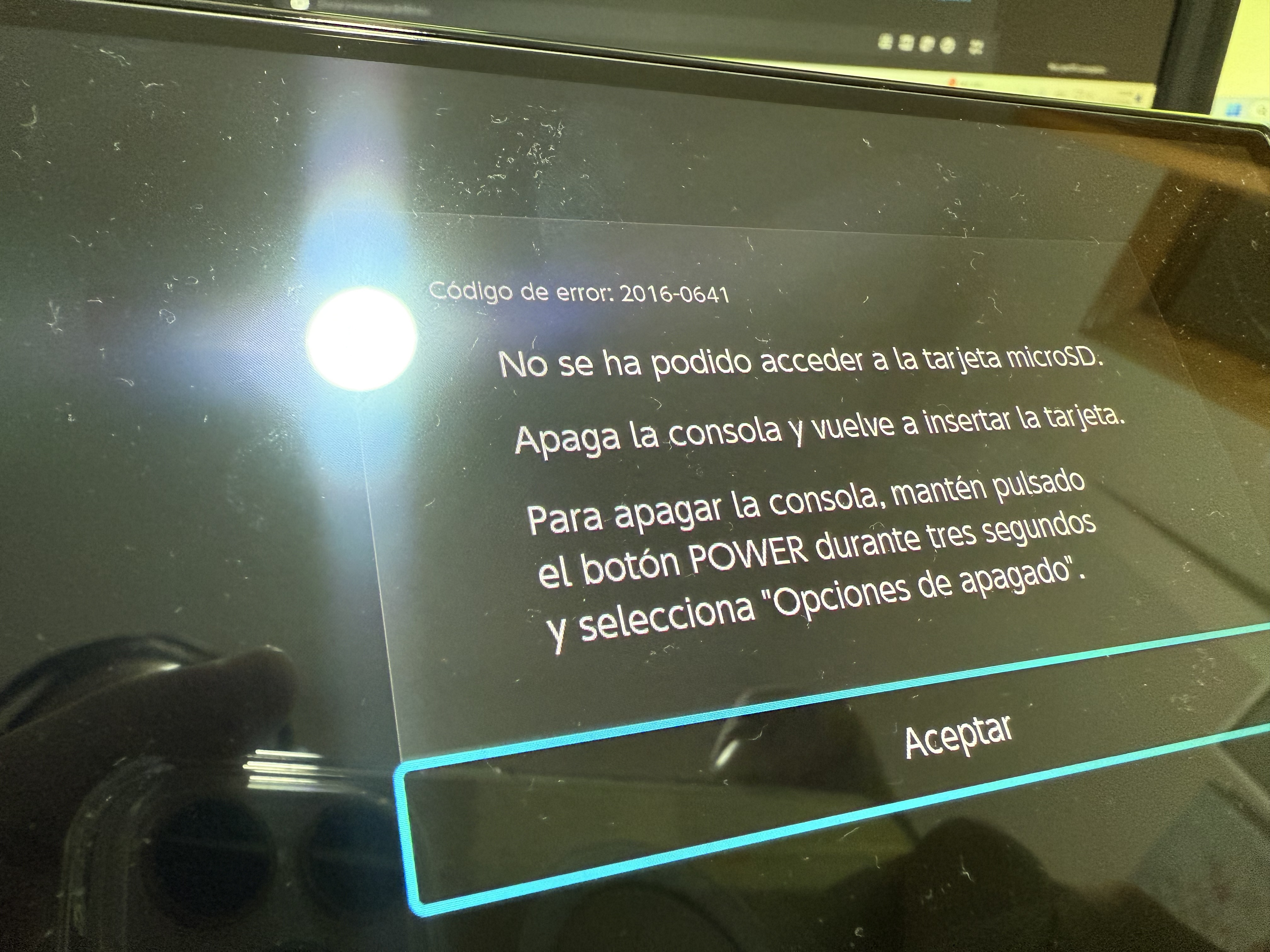

Hi everyone,
I recently installed a Picofly modchip on my OLED Switch using the Kamikaze method. Everything went fine, and the console was working great for two days in both OFW and CFW.
Last night, I left the console installing some games using DBI, but this morning, I found an error on the screen: 2016-0641. Now, it won't recognize any microSD card, which means I can’t boot into CFW. It does boot into OFW, but the error still shows up.
What I’ve Tried So Far:​
  • Swapped the SD card reader with another one from a working console. Still the same error.
  • Tried several different microSD cards (formatted correctly). No luck.
  • Removed the Picofly modchip completely. Checked everything, and it looks fine, but the issue persists.
Any idea about something to check?
Have you checked the female connector on the motherboard for bent/missing/loose pins?
Also no missing components or deep scratches?

Hi everyone,
Clean the coppper debris of the kamikaze, it can make shorts on the connector

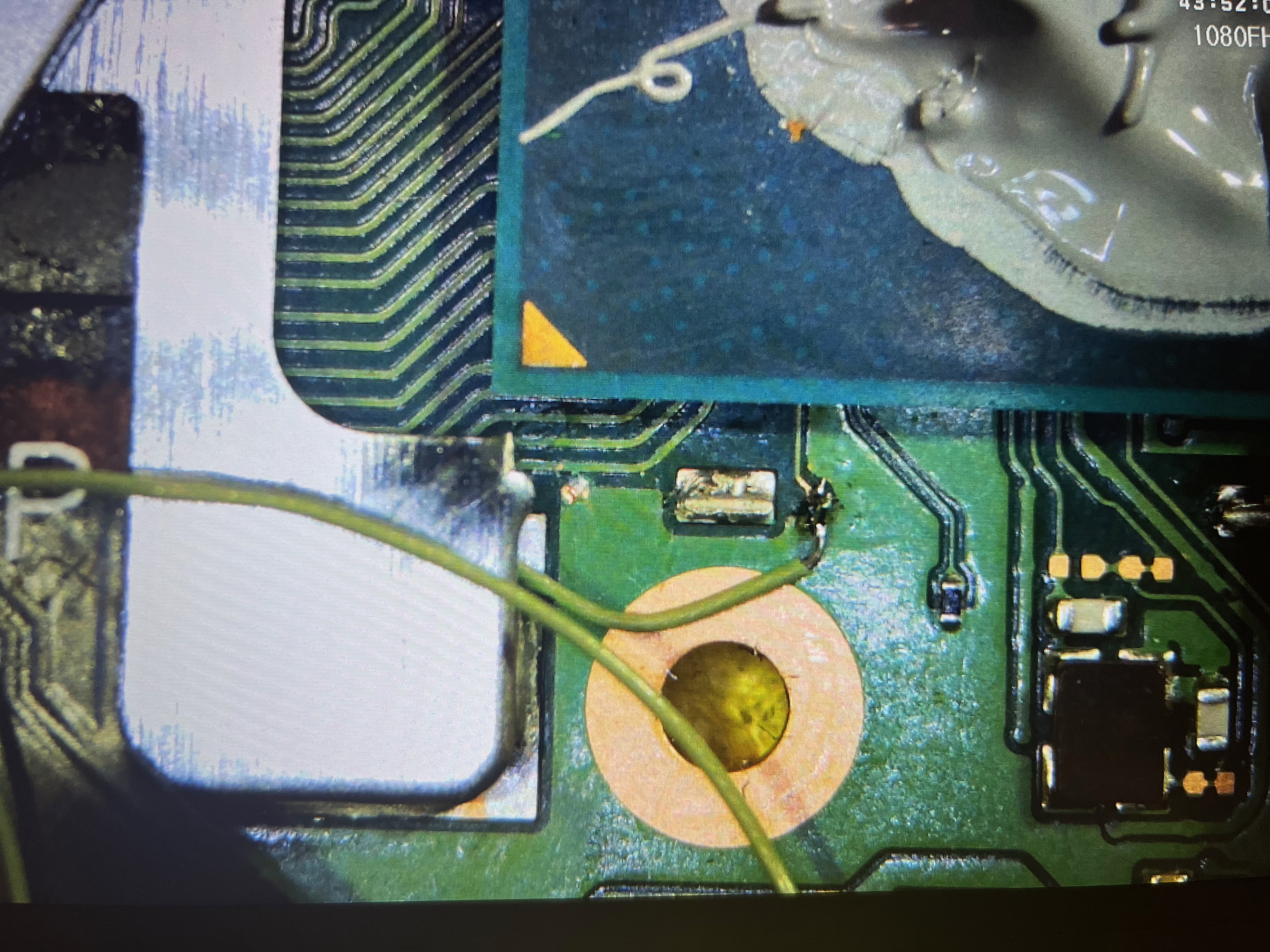

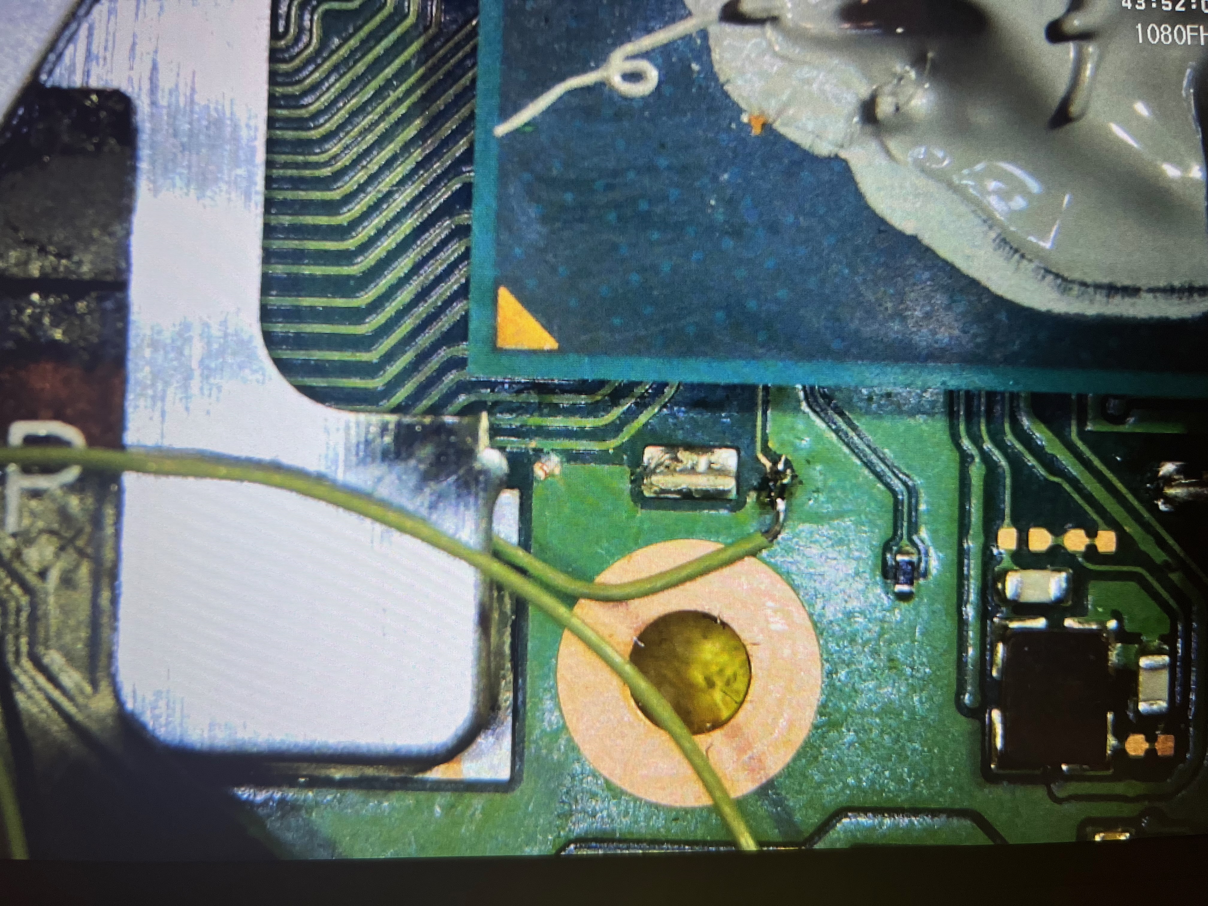

Hi, I'm modding a patched V1 switch, and it glitches fine (almost instantly even), but in hekate I get the "slow eMMC error" (see screenshots).
Diode readings are as follows:
DAT0: 468
CMD: 465
CLK: 468
RST: short
CPU: open? my multimeter indicates out of range I think
Could it be that I've burnt the resistor next to the RST point? Is it causing the slow eMMC error? If yes, what value is the resistor so that I can replace it.
I also burnt the points (the pads ripped off the component) on the back where you can optionally solder the MOSFET, but I think this is not really an issue.

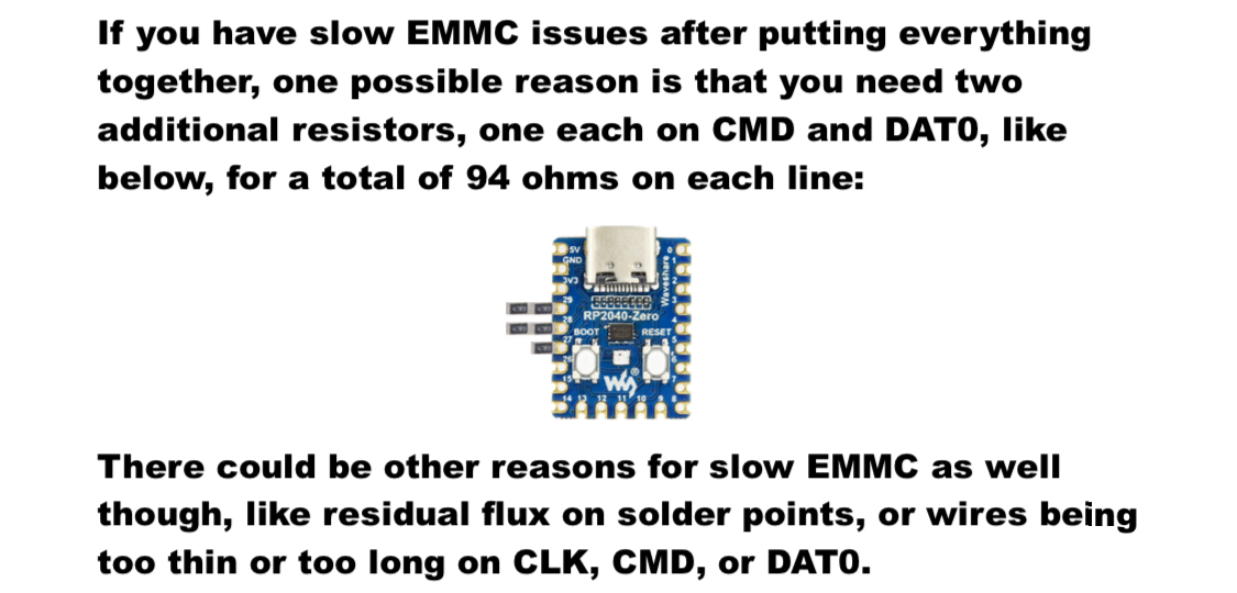

Have you already tried it with additional resistance, as described in the guide?
Nope, I haven't. However I can't boot into OFW by holding vol + and - at the same time so I'm 99% sure it's because the RST line is being shorted to ground.

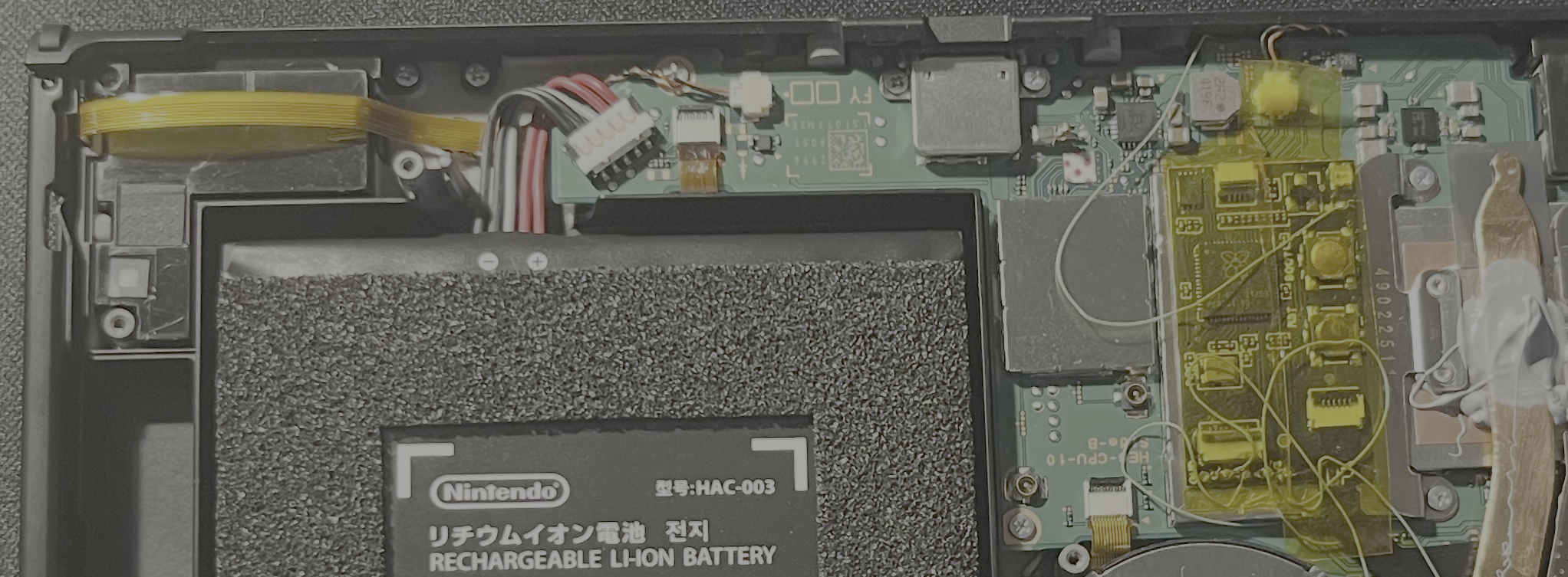

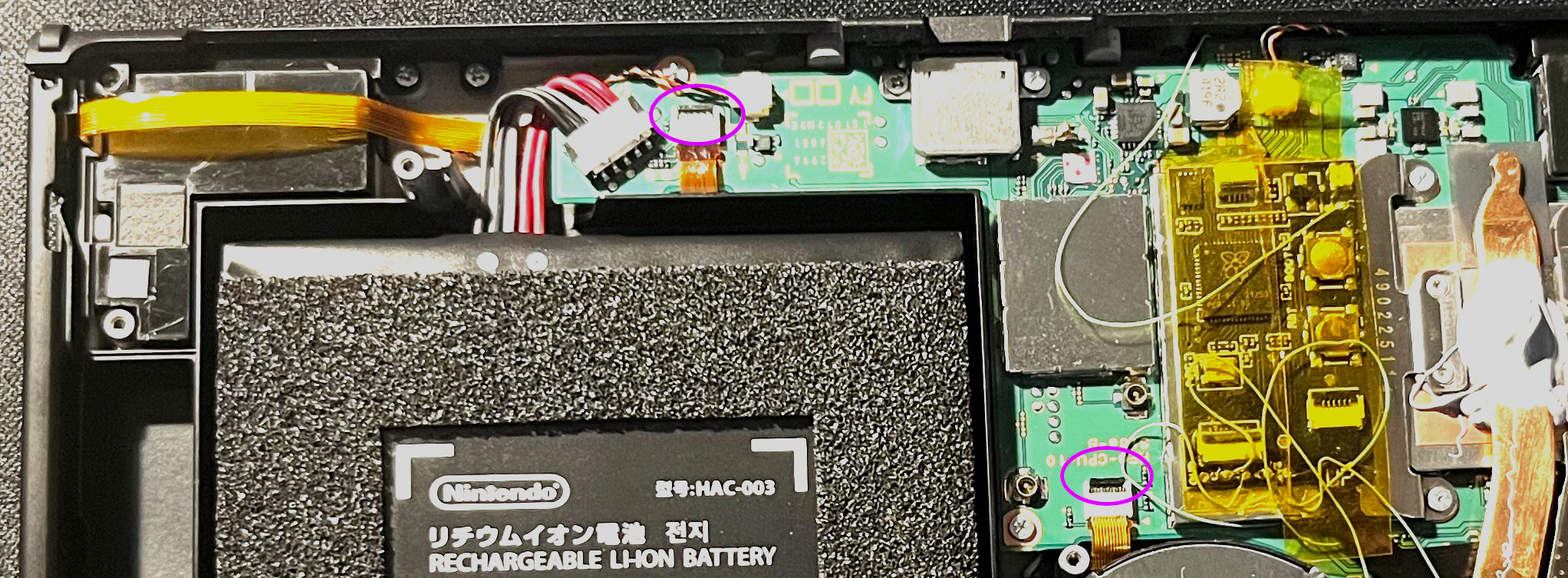

Hi everyone,
I just did my first Picofly mod on my OLED. The chip works just fine, but I noticed that the left joy-con is no longer being detected as connected by wire. It only connects using bluetooth now. The joy-con is shown as being charged when connected to the console though.
I rechecked the flex cable and even tried to generate some pressure inside the connector using kapton tape in case the flex cable connector is the problem, but the problem unfortunately remains.
The only damage I have been able to identify so far is a scratch on the pcb next to where I tried to remove the cpu shield (see the image below). To me it looks like the damaged location should not cause any problems as the trace seems to be next to it. I don't even know whether that area of traces is connected to the left joy-con.
I would be glad for any help or tips on how to further debug this issue. Because of the issue the console is basically unusable as a handheld right now.
Thanks a lot in advance!

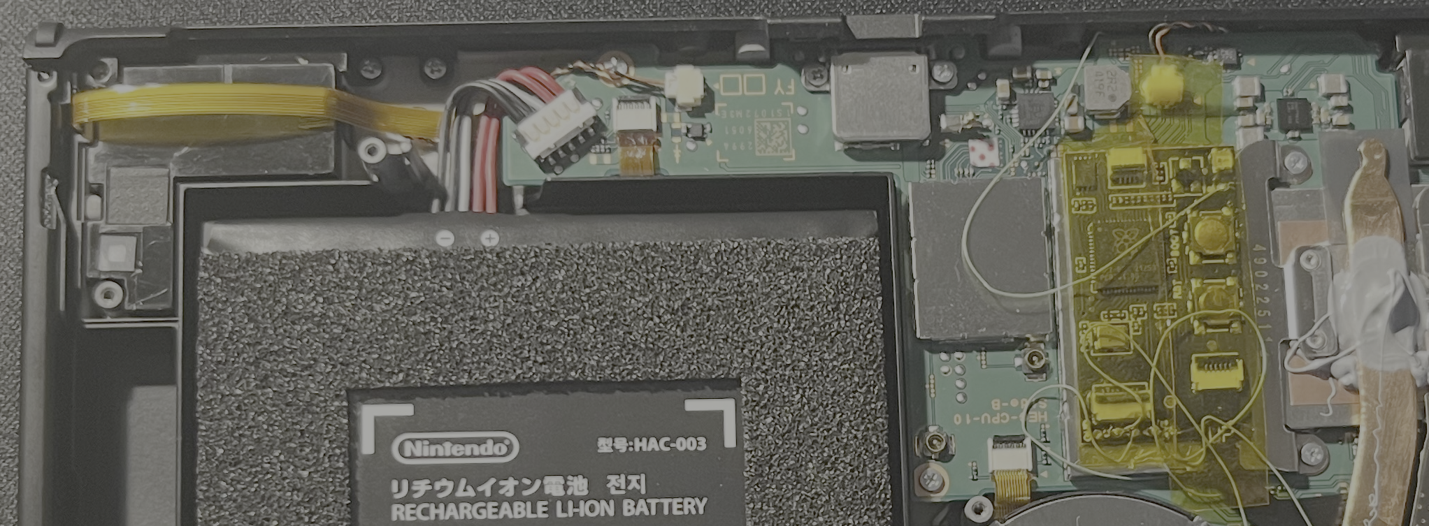

Hi everyone,
To me it looks as if you haven't even closed the flaps on these FPC connectors, possibly even more?
Disregard, I don't work with OLEDs, so I'm unfamiliar with those exact connectors.
Hi everyone,
View attachment 476171View attachment 476172
Have a look at this post? https://x.com/sthetixofficial/status/1543420979426500608
