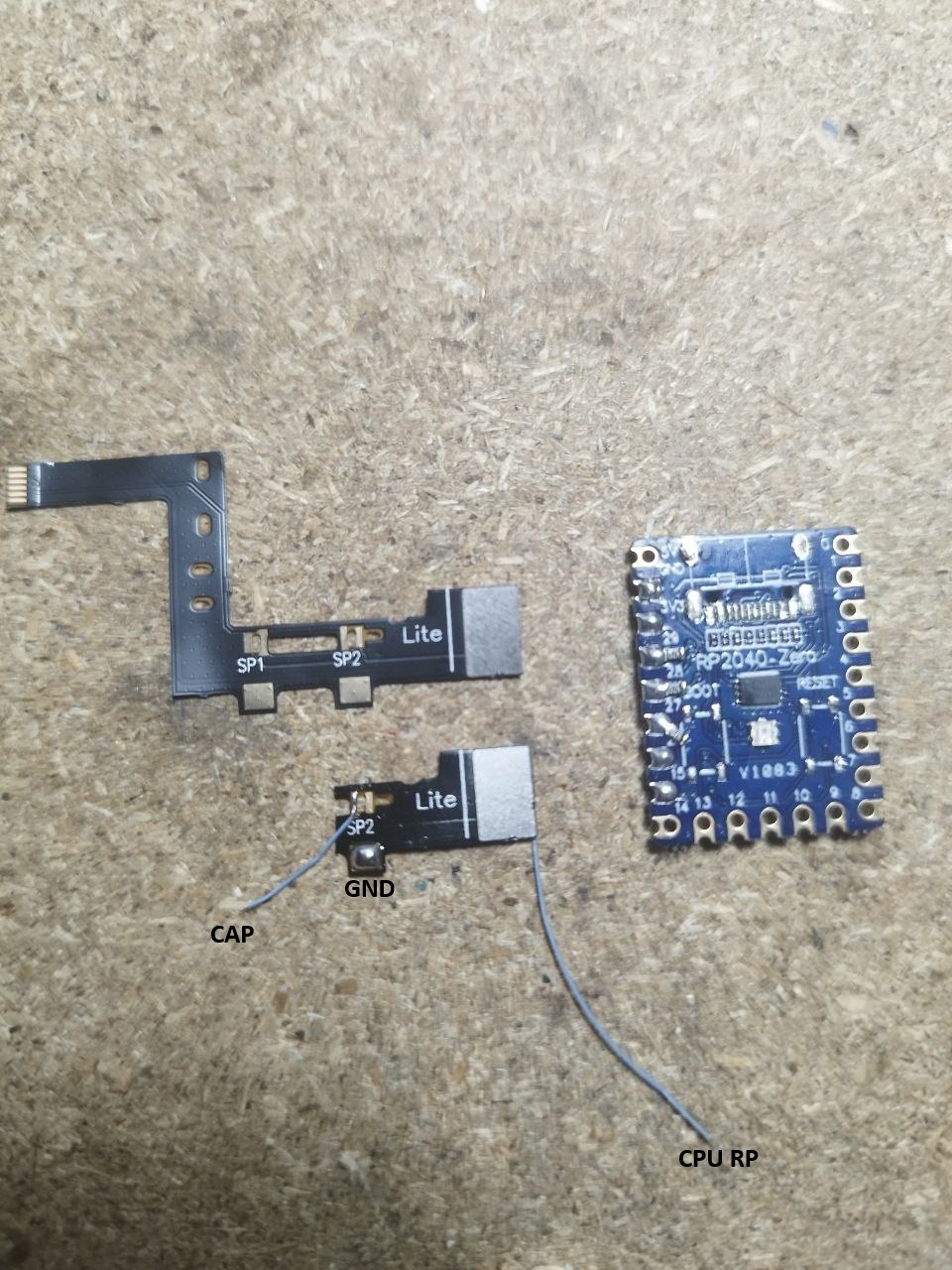

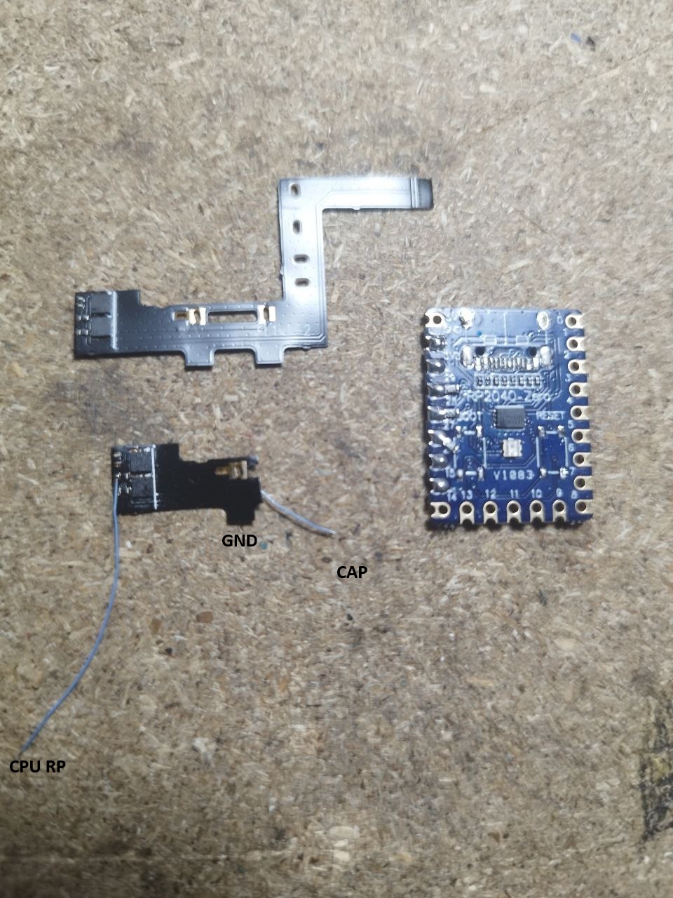

On mosfets I have always adopted a customized solution, which has always been reliable and has saved me a lot of time. I have always bought stock of Flex V1 or V2 and I have adapted them as in the picture and I have never had a problem.
is it same when add mosfet to cpu caps???

how I use them, I have never needed to add anything. The flexes can be V1 / V2 / Lite / OLED, nothing changes. Flex Lite was convenient for this stock and I bought them otherwise I would have bought the V1 which usually cost less. You can apply them to all switch models. I have used a lot of Flex V1 on OLEDs, never a problem.

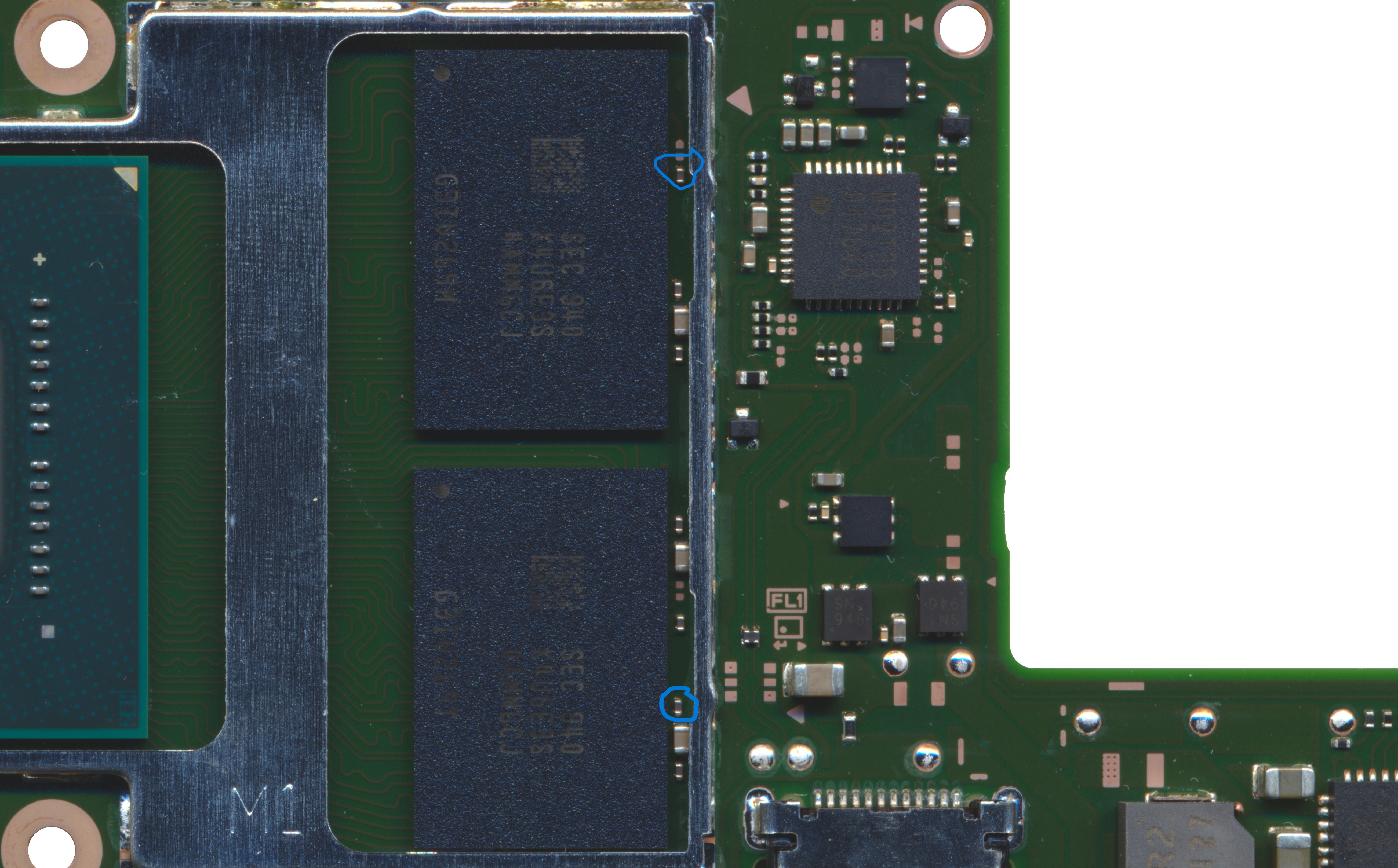

Does anyone know the value of these resistors next to the DRAM on a V2 switch?View attachment 484579
Found the capacitors on this image : 100nF for the small ones. The big ones are 4.5uF
https://files.zzattack.org/img/console/switch/oled/Components/top.jpg

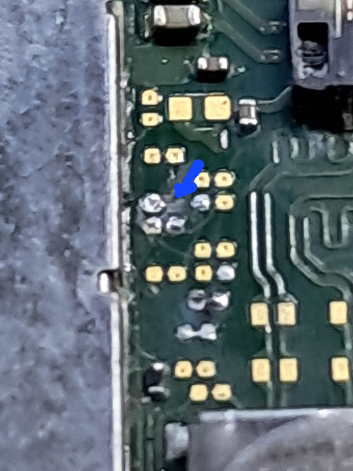

By any chance, anybody knows where this point leads to?
