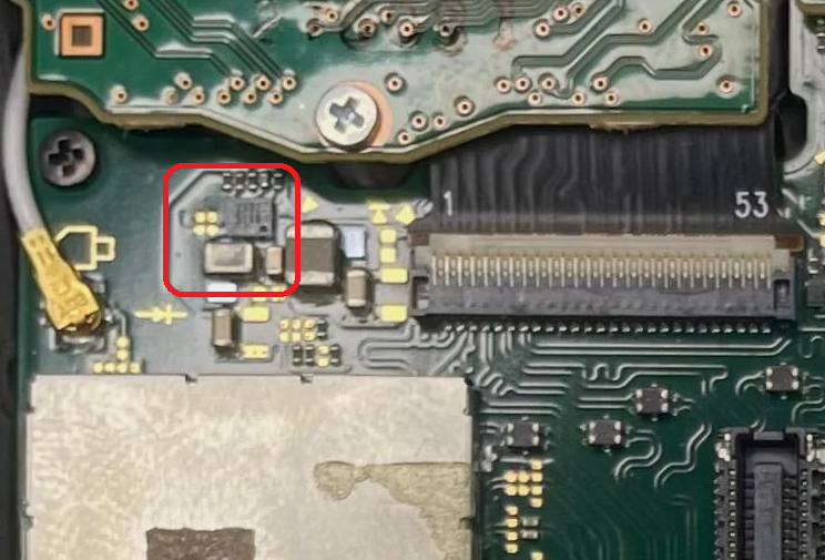

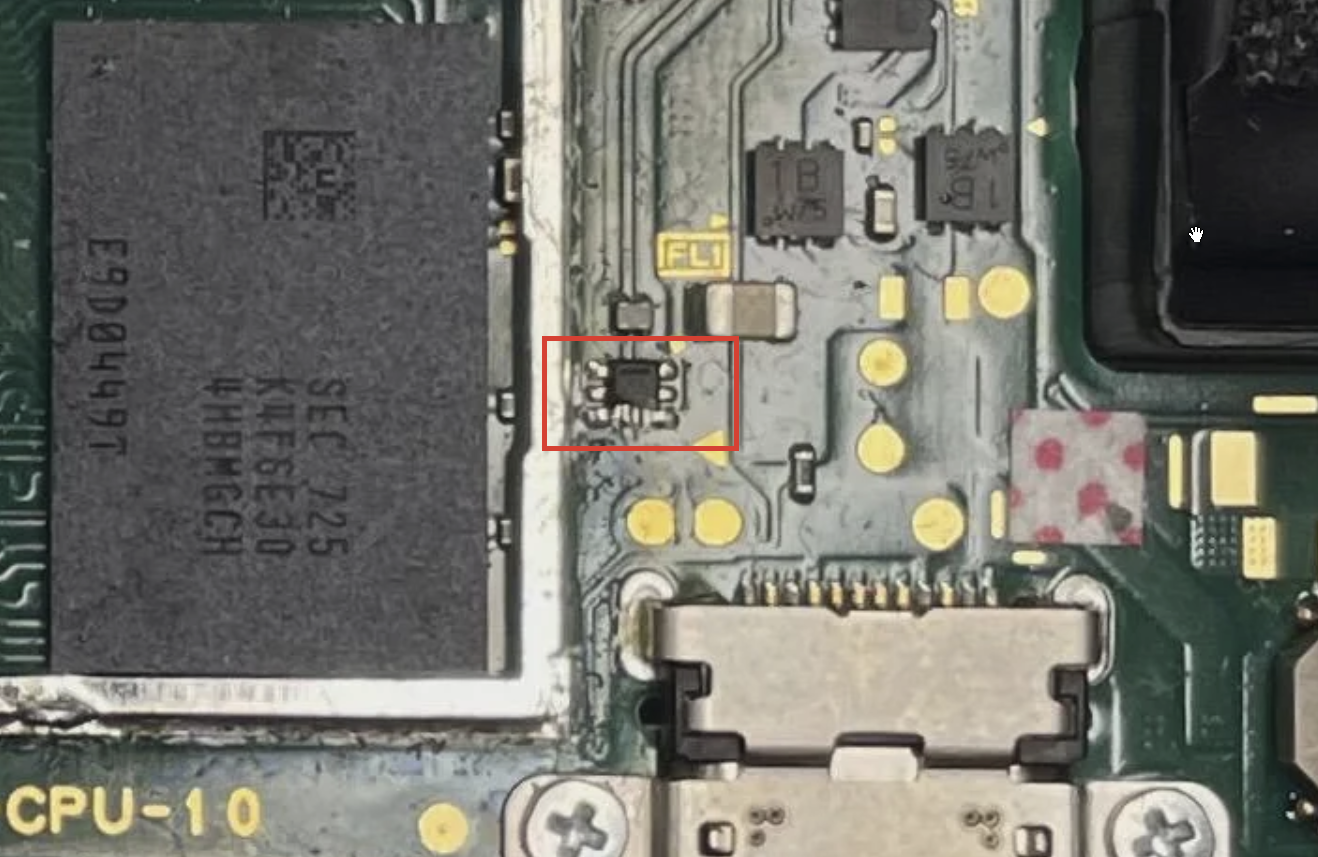

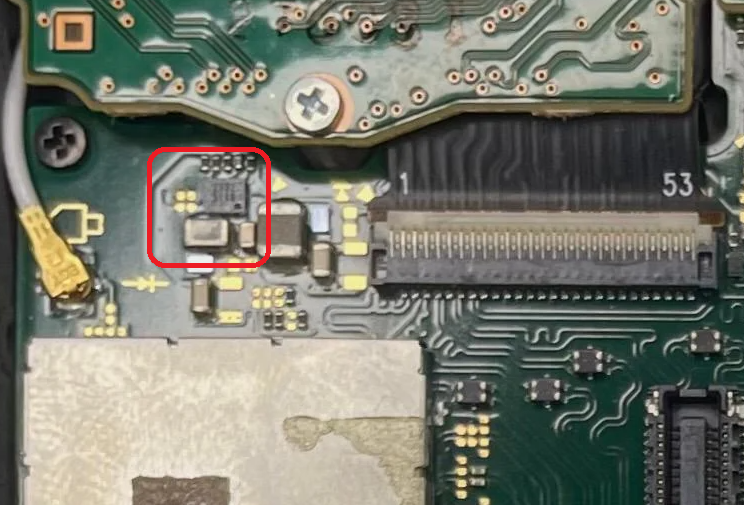

@jkyoho not Picofly related, I have a switch V1 that has no audio through internal speakers and headphones jack ( just static hissing). When dock, sound is fine on monitor/TV.
Removed the IC, short still present. Managed to isolate the problematic capacitor and replaced it from a donor board. Can I place the audio IC back? Worried that it'll fry cap and I won't have any donor component left to use.
Why not just put back the ic without that cap if you worried the donor gonna fry again. Console could still work without cap in most case

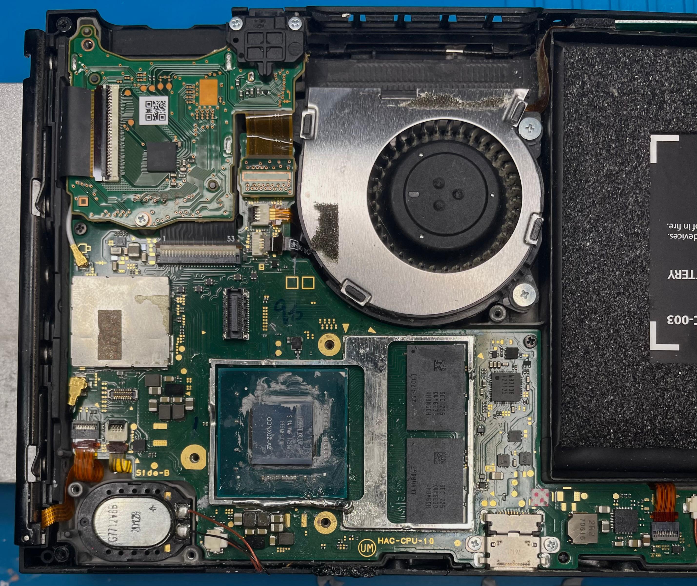

Guys, I think I screwed up on my first try with an AIO chip. Yesterday everything was fine after the install but this morning I had a bad surprise and I don't know where I messed up:
The chip still does the glitch correctly but the screen goes completely crazy.
Also when docked, the OS says that the gamecard reader is either broken or corrupt...
I think I'll start by removing the chip and try booting the console stock
Edit: Done. The console still boots, but the screen is still going crazy. I assume I blewed up a microcontroller maybe... But which one ? :(
Here's a full picture of the MB:

zoom in to this area.
FYI, isnt this MB unpatched?
