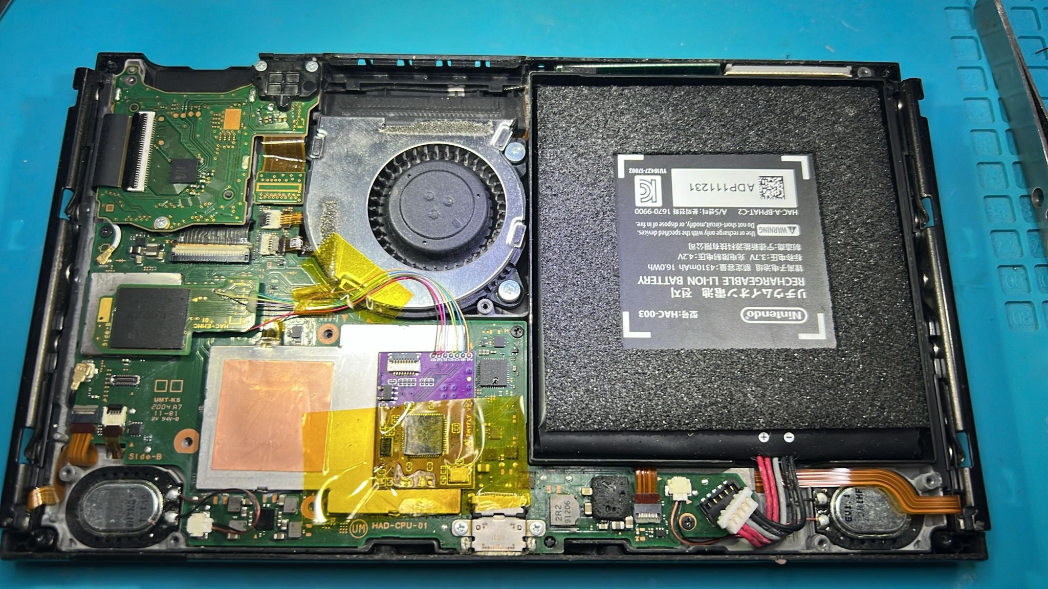

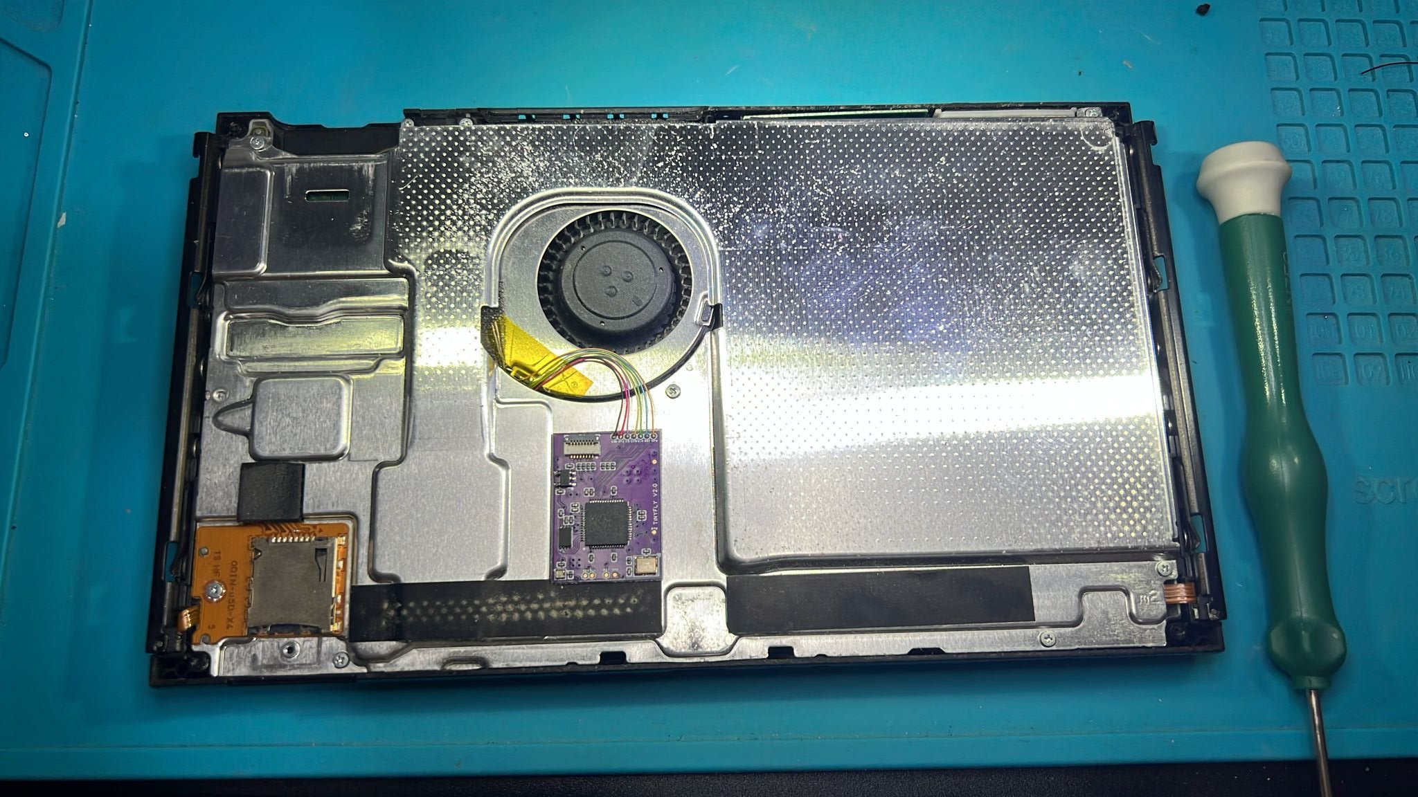

tried a different orientation today; think it lines up rather nicely :)
Now these are some great looking installs.
Its not that bad though. My first try way more ugly than this.
And yeah, I've seen CRAZIER installs on reddit.. You'd think they're using welding guns (and some how those work...)
Congrats for the succeed.
Or maybe my skills on flex are not that good. Who knows, maybe someone could master the technique.
