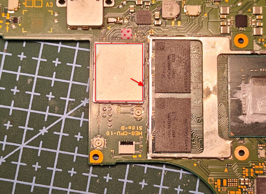

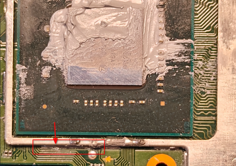

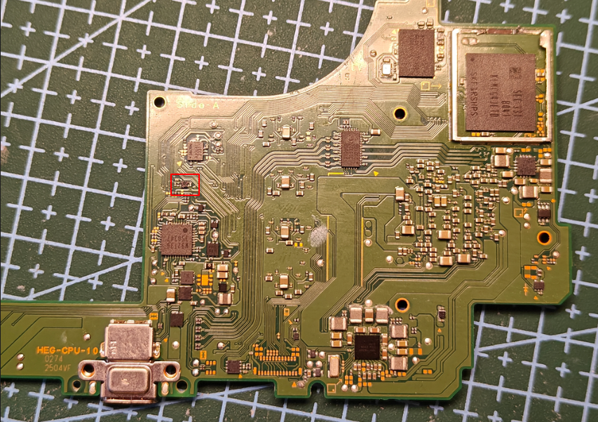

I'm a bit out of my depth here, I admit to not knowing what to look for. That said, some things stand out:
This shield looks askew and not engaging the latch, likely was taken off and then put back on, but not quite right:
I'd also check these traces here:
And this IC looks a bit off in the picture?
Reactions: QuiTim

this sheet metal cover looks very good in real life as if it had not been touched at all. next to the processor the flux residues were cleaned and it is clean and the last photo is simply out of focus there visually it is also good. unfortunately I do not have a better camera to capture it 😏. there are very few black screens described. do people not have such problems 🤔
