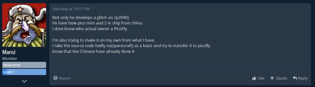

Ok actually tbf he does claim these chips are from China, in DMs he told me that the Chinese were independently making their own glitch chip based on the same hardware but with their own software solution.
So if what he has is that then it wouldn't match what the Pikofly dev has built.
I'm still sceptical though. I know a lot of people who deal with mod chips and if China had one working I'm fairly sure I'd be hearing about it from one of those guys first and not some random dude who showed up on GBAtemp 3 days ago.
Ok actually tbf he does claim these chips are from China, in DMs he told me that the Chinese were independently making their own glitch chip based on the same hardware but with their own software solution. View attachment 347836

Picofly has nothing to do with the glitch from the Chinese. This is a different developer.
Dump was read from the board from the Chinese as is.
Large size is due to the dump program itself.
The dump needs to be reduced in a hex editor.
The fact that I registered 3 days ago does not mean that I am a troll, I am trying to help and tell my story with rp2040 from another supplier. Believe me or not, your choice.
