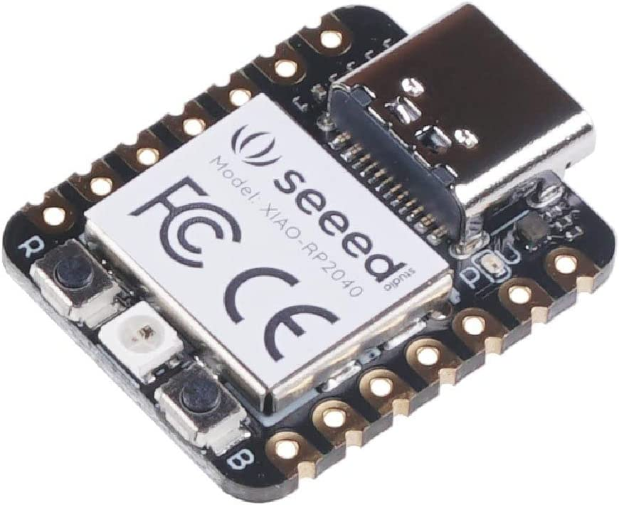

Hi.
RP2040 good work on 3.3v
And perfectly work via emmc & MicroSD card.
Im find firmware for rp2040, but dont know fow to dump it(
I have rp2040 with firmware and need dump it

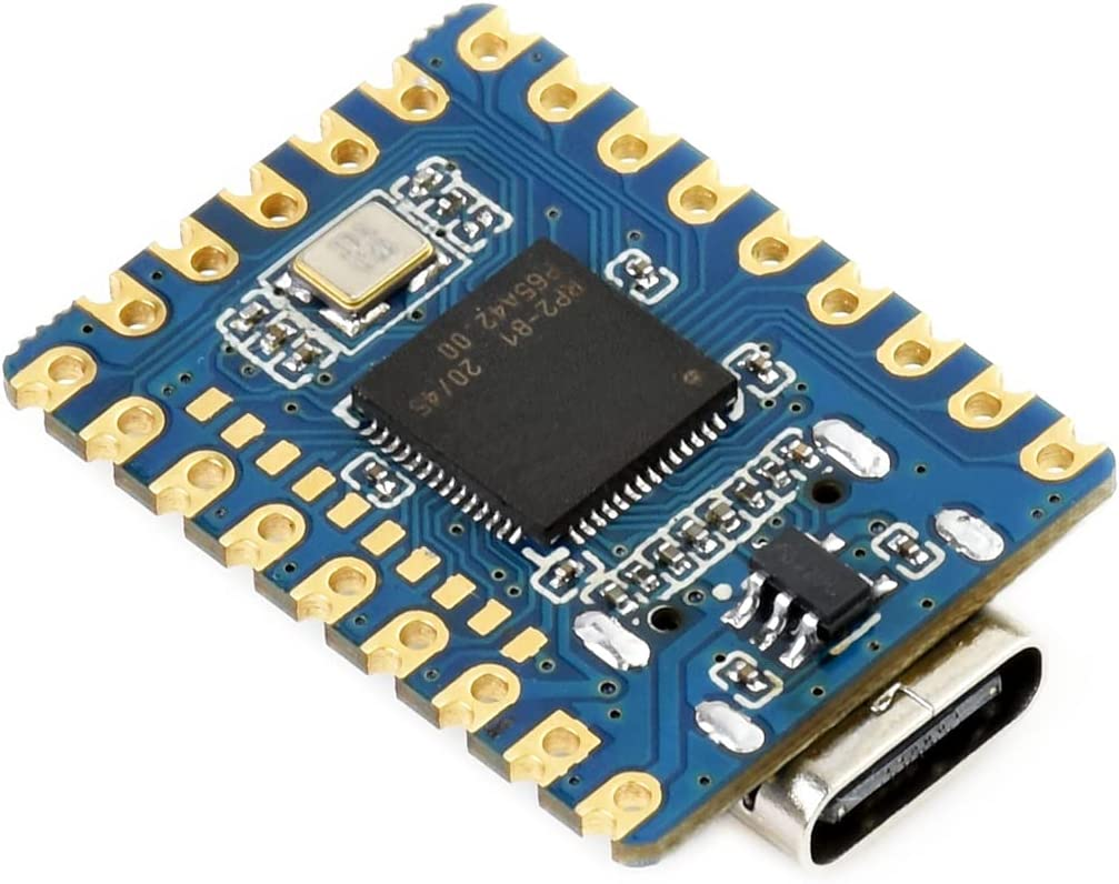

Hi.
can you please post a picture/scan of the board from both sides
