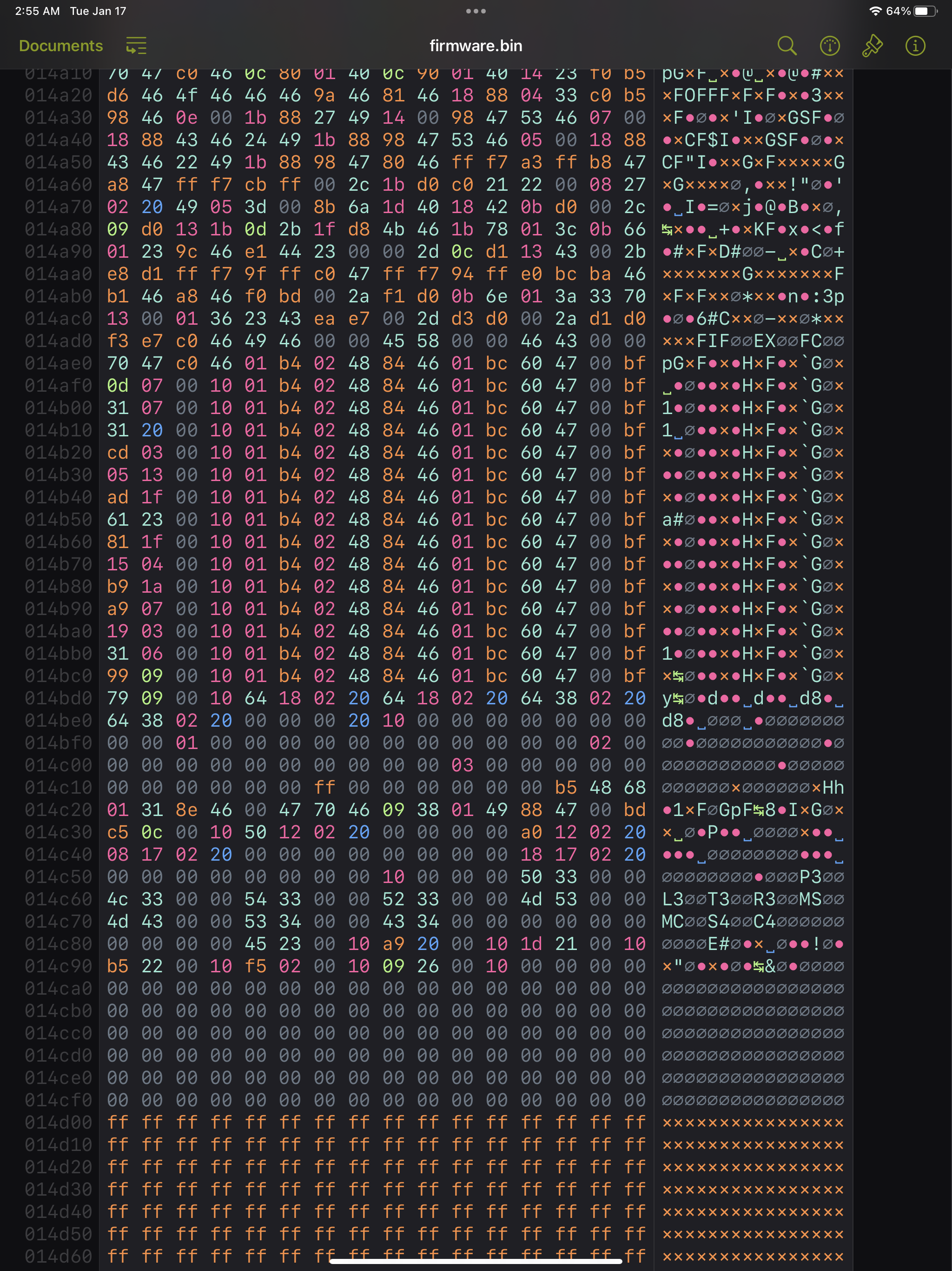

firmware.bin has about 85k of payload in there…
—-snip—-
the rest is probably just FF padding of the rest of the flash space. If this was just a dump of flash space it would be huge in comparison with the bulk being a lot of empty space.
….like the Trinket payloads.

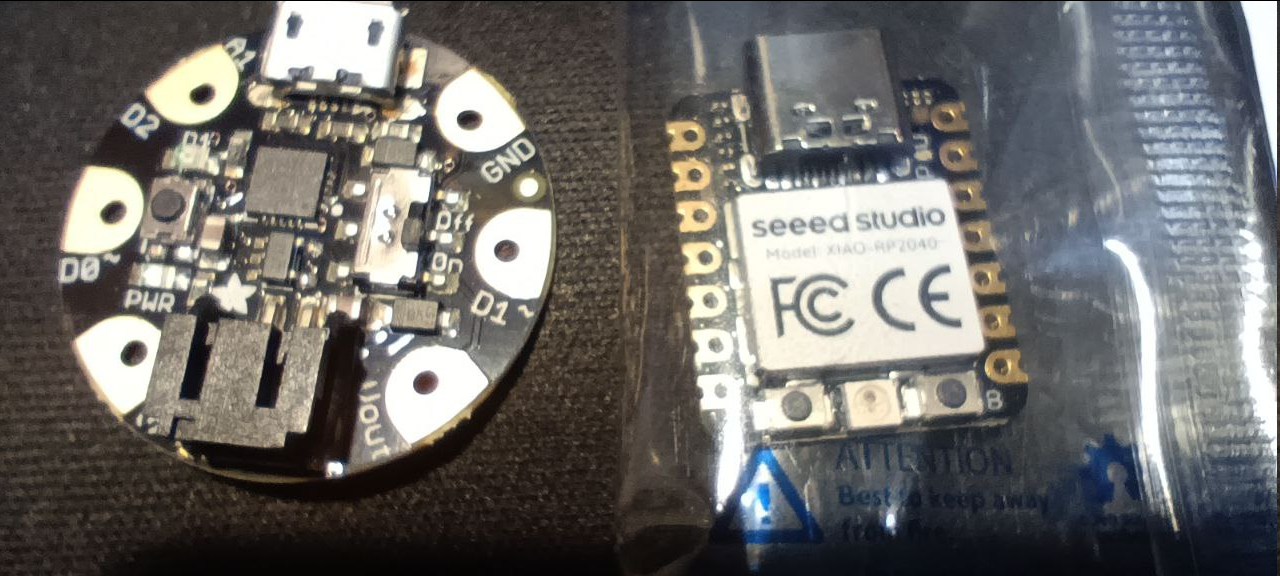

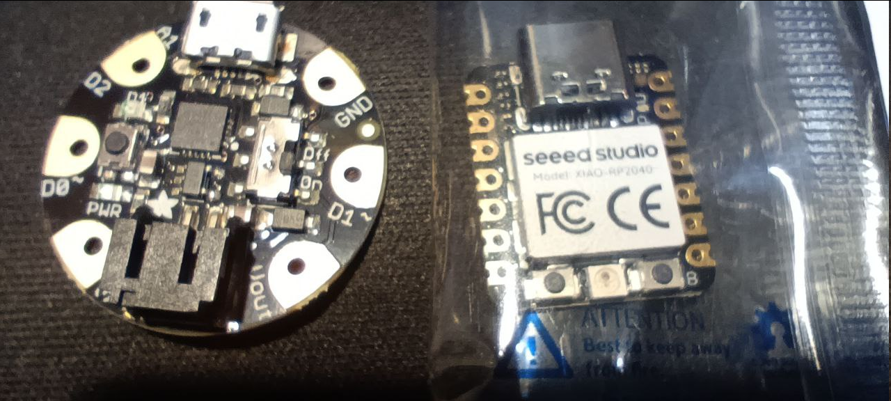

finally one of my pico RP2040 arrives, that little bugger IS SMALL, is even smaller than the gemma I brought for my wife's console!!
well this night will start to playing with this micro.

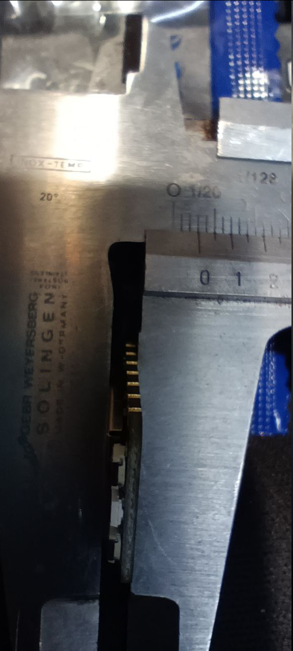

How thin is the seeed compared to a hwfly?
Besides the buttons an usb-c port the metal shield will probably also need to come off for it to fit in a oled switch.

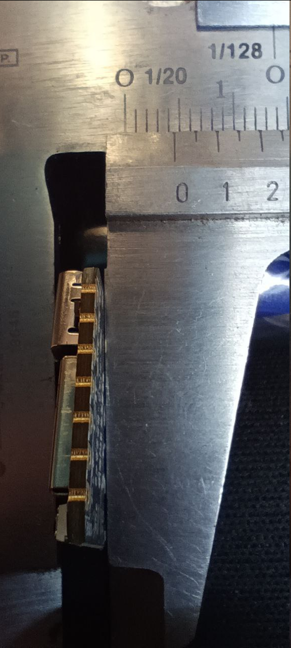

yeah, the USB port is thick
without the USB port it's the thick exactly 3mm high
the board and port are 4.6 mm thick
so its for sure you need to remove the USB port.

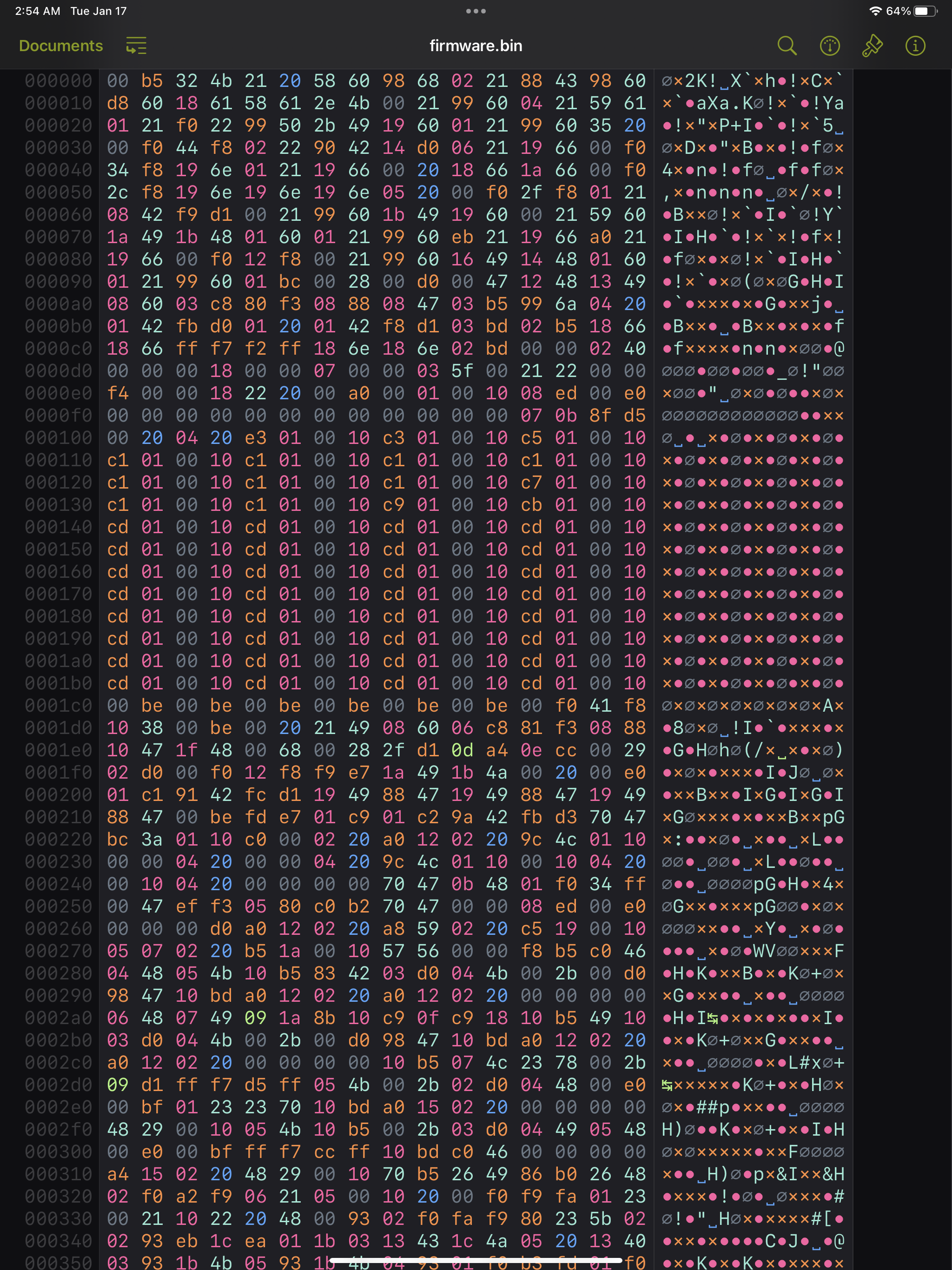

I am analyzing the dump. (edit: to clarify, the firmware.bin from firmware.rar)
I think it's either obfuscated or unfinished, because the firmware is dumb.
There is BKPT everywhere (including the main() function), and the HardFault handler is also a BKPT, meaning that the CPU will just instantly die after a clock init.
There has to be some other magic I didn't find yet. I'll keep updated once I figure out the correct way to load this dump in such a way as to make IDA happy (I don't understand how to use Ghidra even after reading the documentation, so I'm limited by the tools I have).
Update 1: someone took the effort to actually strip the binary of *any* useful data, so it's probably not fake, in the sense that the code definitely should do something considering its size, but it's definitely not just a lazy fake payload.
I'm recovering as much symbol data as possible, and keep editing this post on my progress, and post a reply instead if a big discovery gets made.

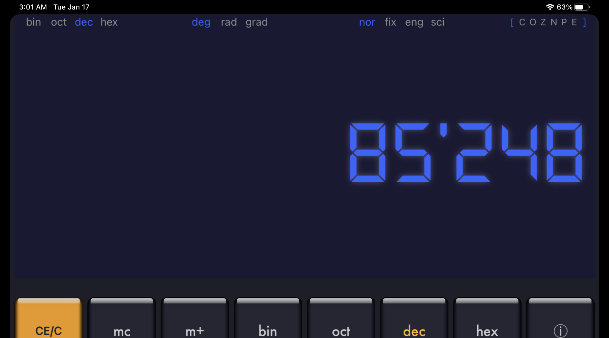

Update 2: the payload size is 85184 bytes, but RAM usage actually extends to 154024 bytes (minus 192 bytes for PicoSDK stuff). Some code seems to be in RAM, (4576 bytes to be exact). Some SDK code also seems to be present in RAM, which is quite odd. I think the payload is so small because they have probably modified the linker file which comes with the SDK, but also probably just copypasted some SDK functions and made them run from RAM instead.
This makes sense, they are probably using a modified version of copy-to-RAM -style payload with some modifications.
