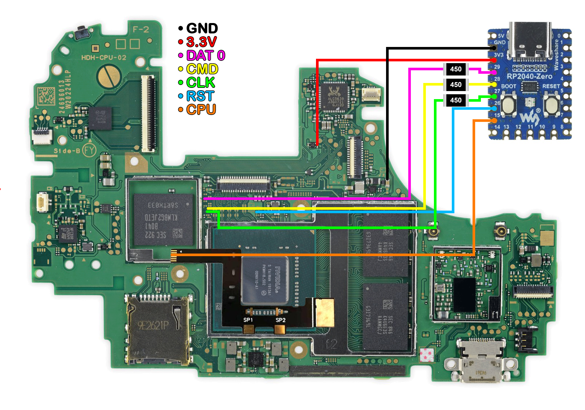

I have some info about PicoFly so i'll share it with you.
1) Yes, it's really exist.
2) Yes, it can glitch (at least it definetely works with Switch Lite and Switch Oled).
3) Yes, you still need a cpu ribbon cable (V2 or higher).
4) The firmware is unique for each chip. Each chip has its own ID, and the firmware uses it for verification.
Example ID - Flash ID: D6 28 60 B8 1C 55 6A 25
5) You need three resistors (probably for protection?), ~45 ohm each.
Switch lite Solder scheme is attached (yes, it's low quality, but who cares?)
